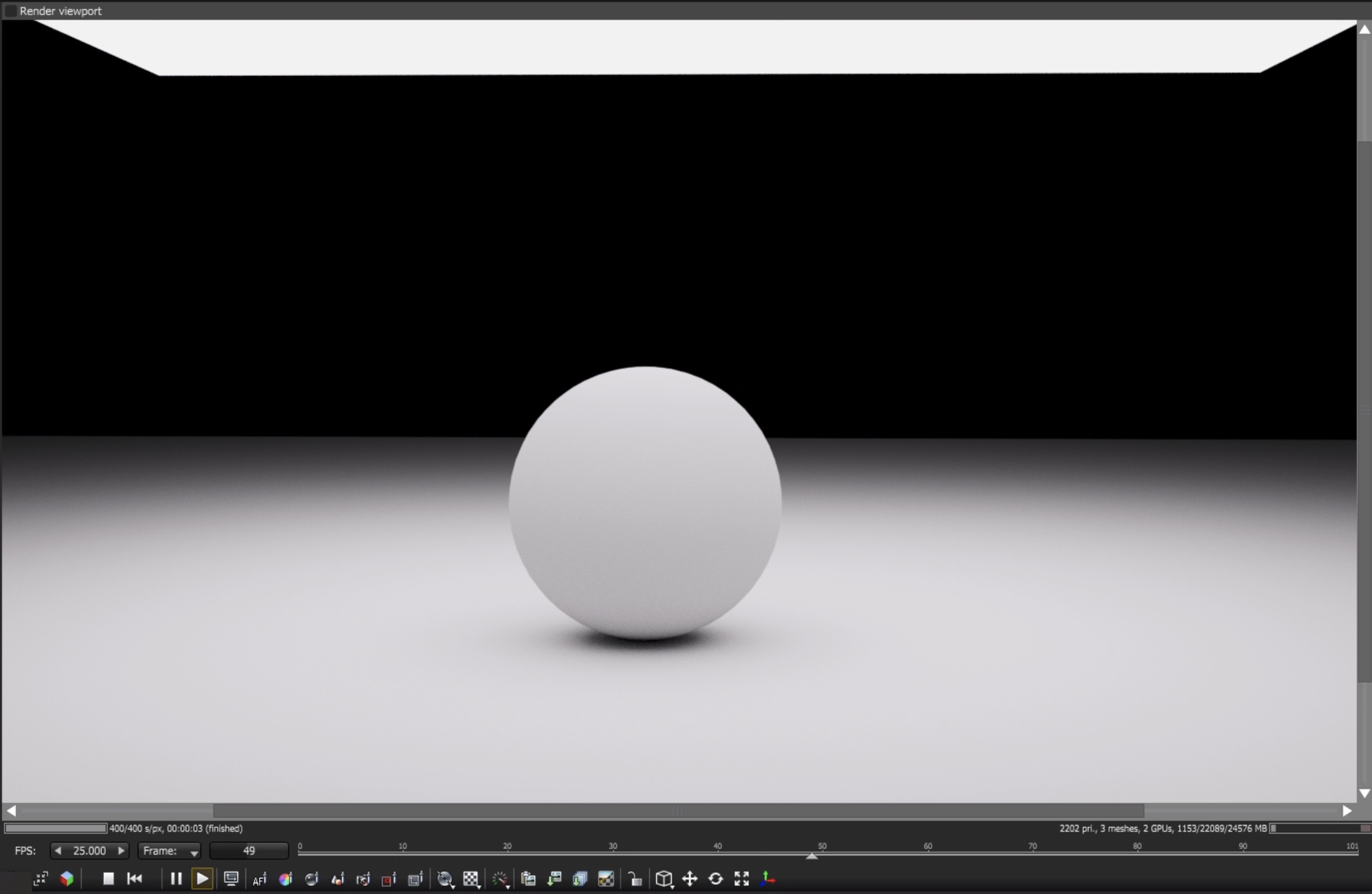

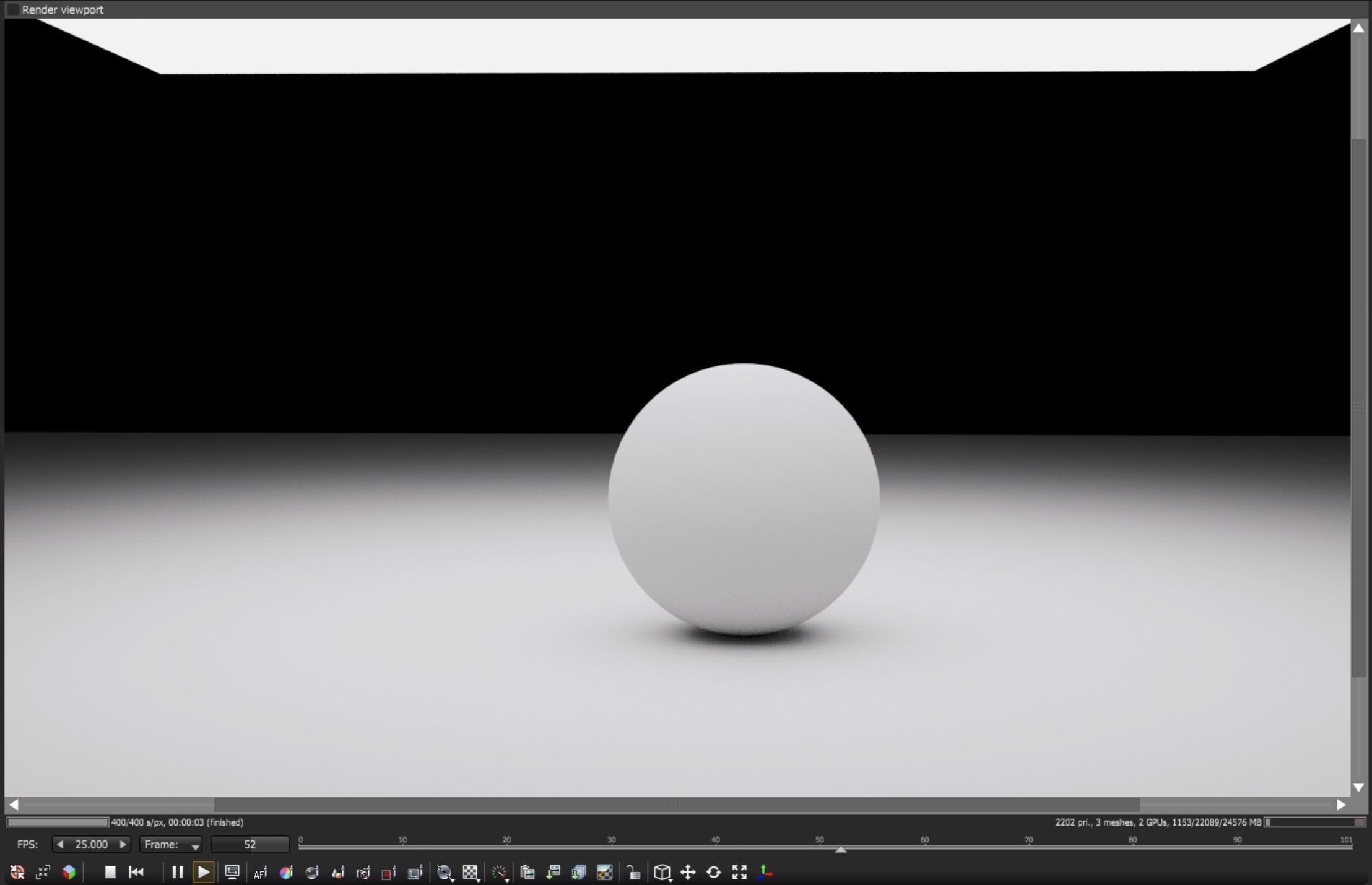

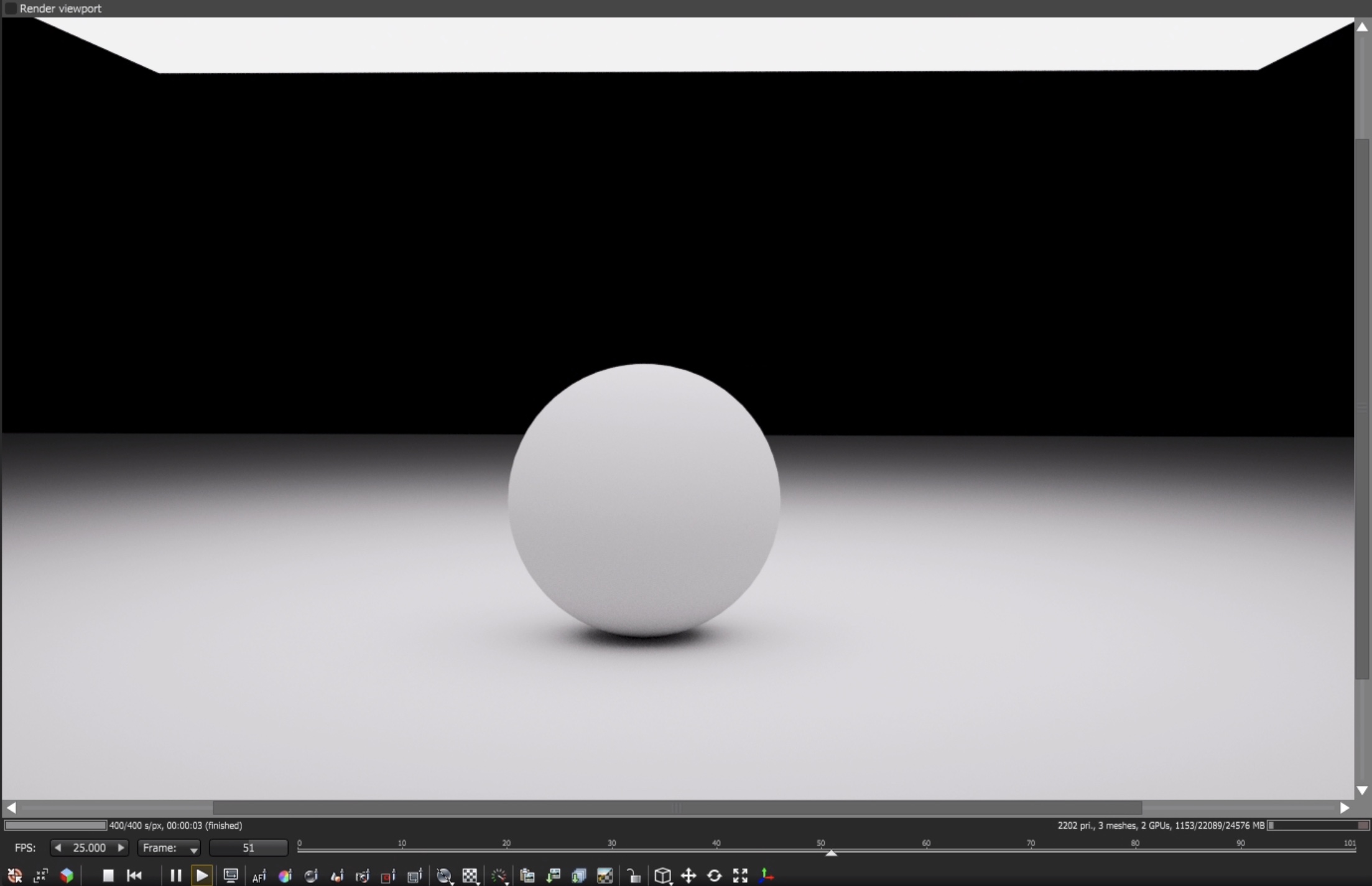

So i've done quick test :
https://we.tl/t-UyAiTRi0ME
You've got C4D and .ORBX files
The simplest animation as you can see.
So it's still quite jittery, you can see in the example the animation.
It will freeze for a couple frame or more, then catch up with the animation and produces very strange results.
I'm stuck here.
Also I've tried the option "Show results in Live Viewer", it takes longer of course and it's a bit better (its v2 in the wetransfer file)
but it still struggling at the end.
