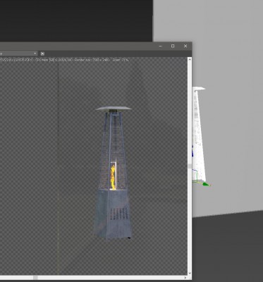

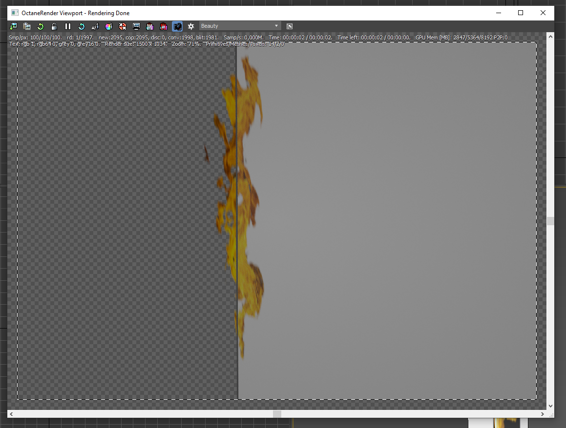

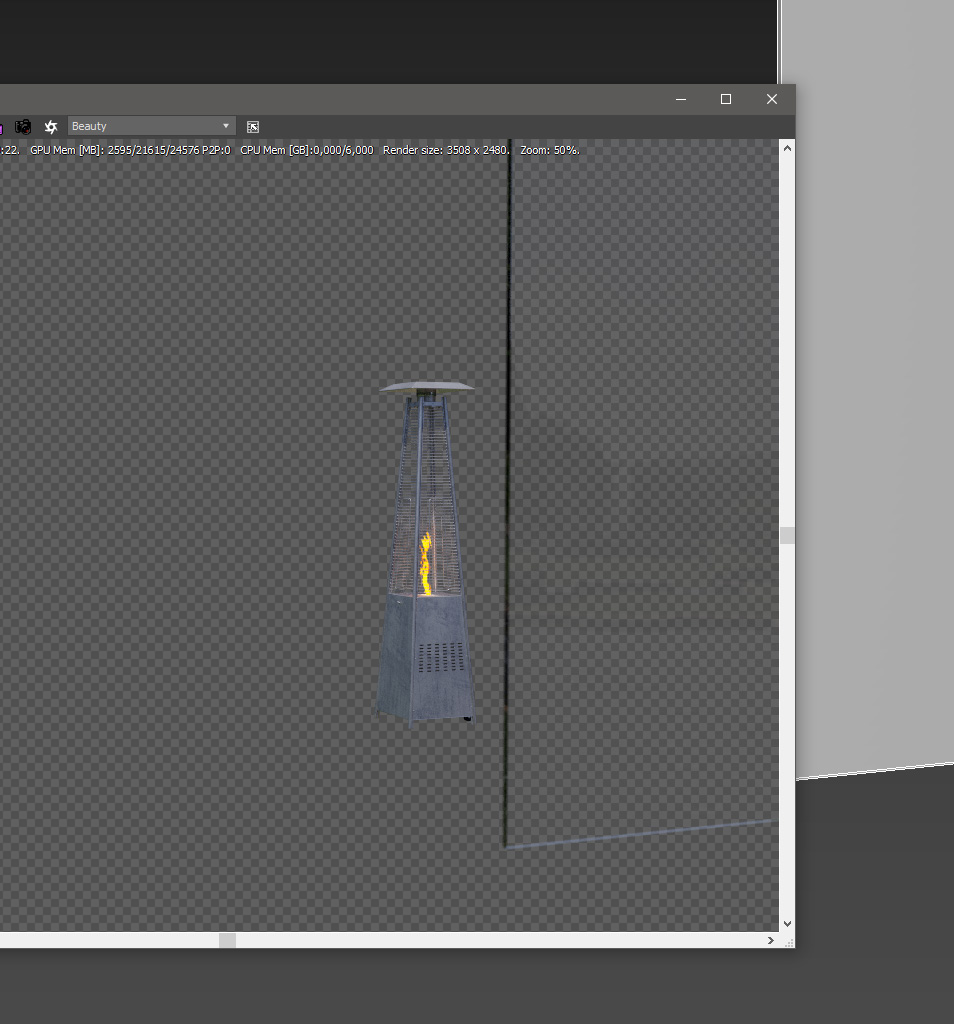

mbetke wrote:I noticed the opacity of my flame gets killed as soon as I move it behind the large glass (specular material).
Hi mbetke,
enable the alpha shadow in Kernel panel.
Regards
Paride
mbetke
Posts: 1307
Location: Germany
Hi mbetke,
Regards
Paride
It is enabled of course! I'm not talking about shadow. The Opacity is just gone. I can see the white background of the flame. When I move the object a meter, so it is not covered by the glass panel, the flame looks right and has its opacity turned on.

Hi mbetke,
could you share the flame please.
Regards
Paride
mbetke
Posts: 1307
Location: Germany
PURE3D Visualisierungen
paride4331
Posts: 4005
Hi mbetke,
I think it depends on some .png issue.
Making a new .png it seems to work fine.
Regards
Paride

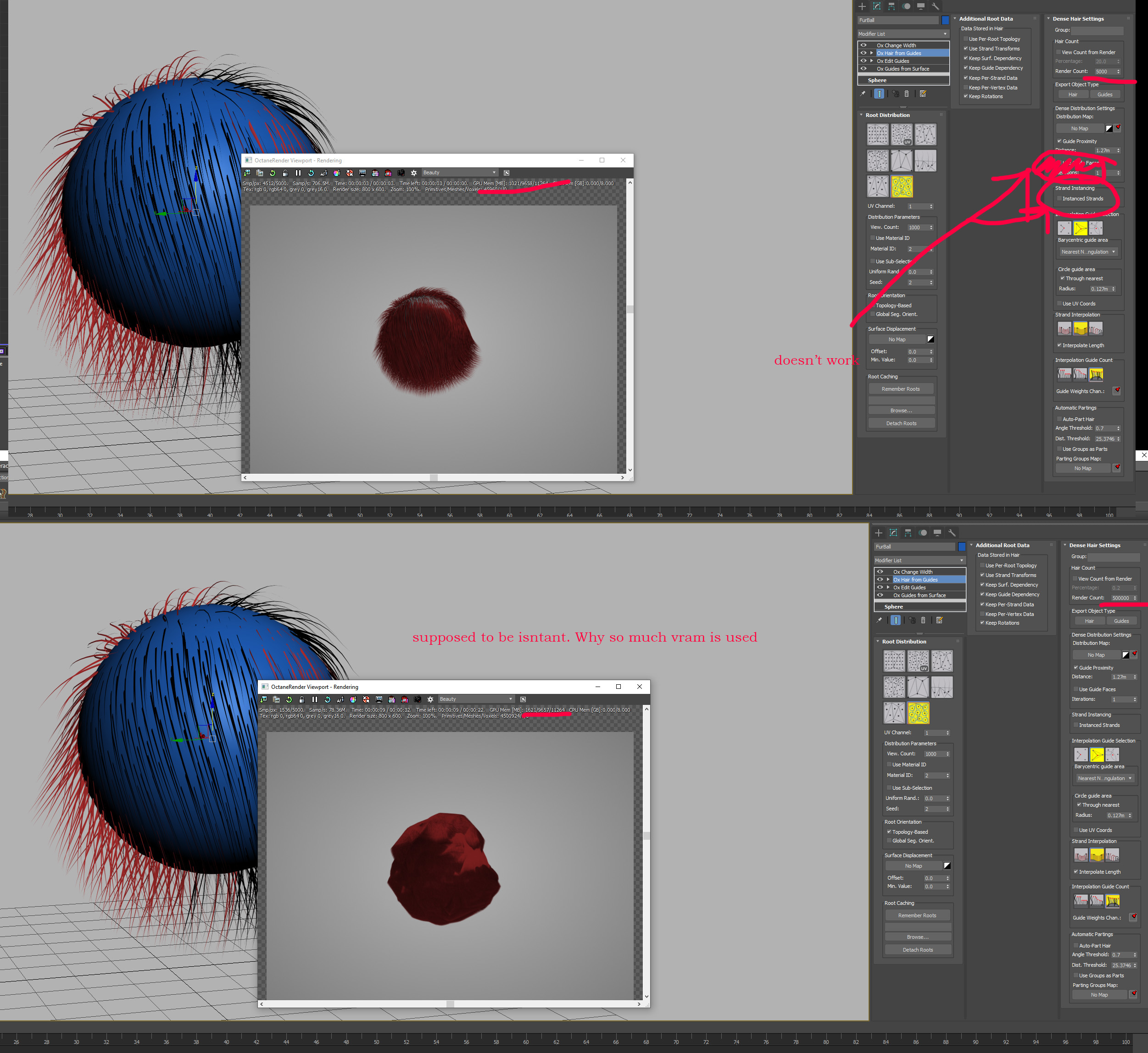

coilbook
Posts: 3179
Hi Paride,
I am using ornatrix but when I increase hair count vram usage goes up a lot. I thought hair supposed to be treated as instances? And using instanced strands makes hair disappear altogether.
is there a proper way for hair? Thanks

neonZorglub
Posts: 1103
coilbook wrote:Hi Paride,
Hi coilbook,
-Ornatrix hairs are sent to Octane engine as Octane hairs, so it uses information about each strand.
It's more efficient that creating polygons on the plugin side, but still uses some memory per strand...
-The 'Instanced Strands' options is not supported. (and should be disabled)
I'll investigate if that's something that could work with Octane in the future.
