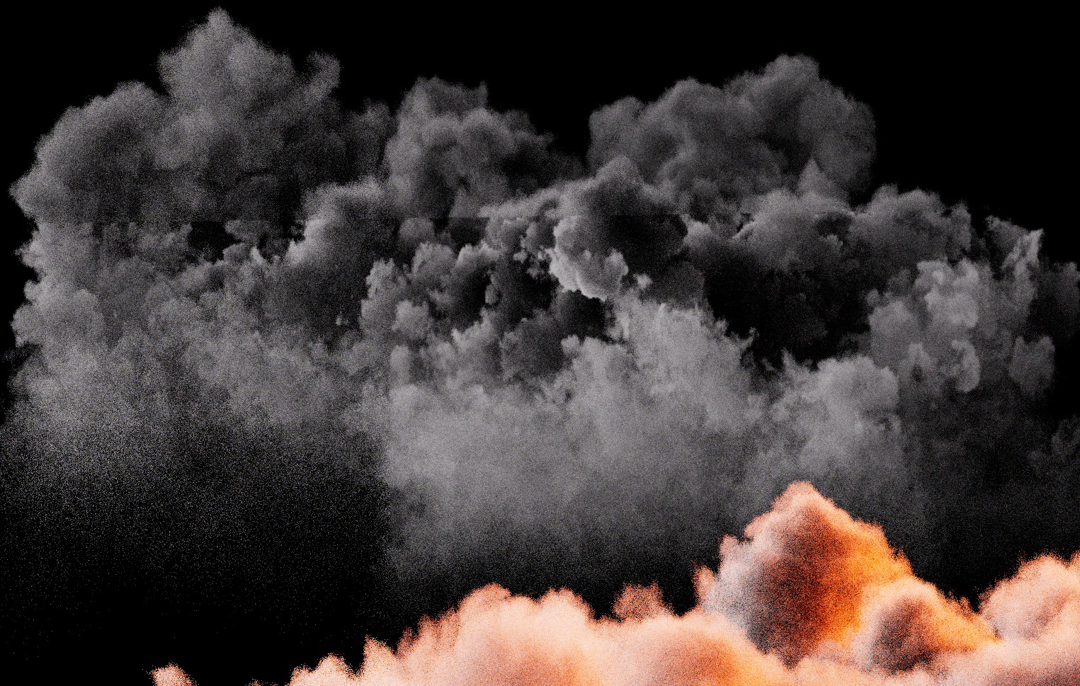

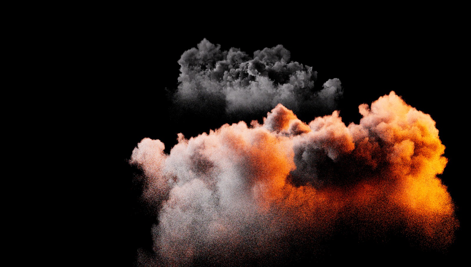

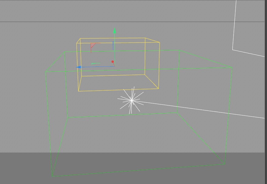

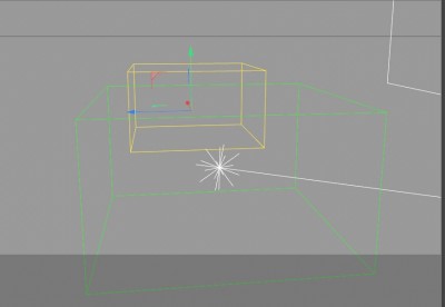

There's a bug that persists in vdbs throughout all of the 2021 c4d releases, when looking at a vdb through the voxel box of another vdb. The volume in the back looks different when viewed through the box of another vdb. In the screenshots you can see what I mean. This makes octane 2021 unusable for me at this point. The vdbs are not intersecting.
The "dirt visibility" option in the object tag also seems to have been removed in 2021 and the latest 2020.1.5 versions. Is this option permanently gone? I found it very useful.
Thank you!

First is not plugin related and needs a scene to check what you say. Second is a mistake on my side, not sure why I've disabled it. But I'll bring back for next.
