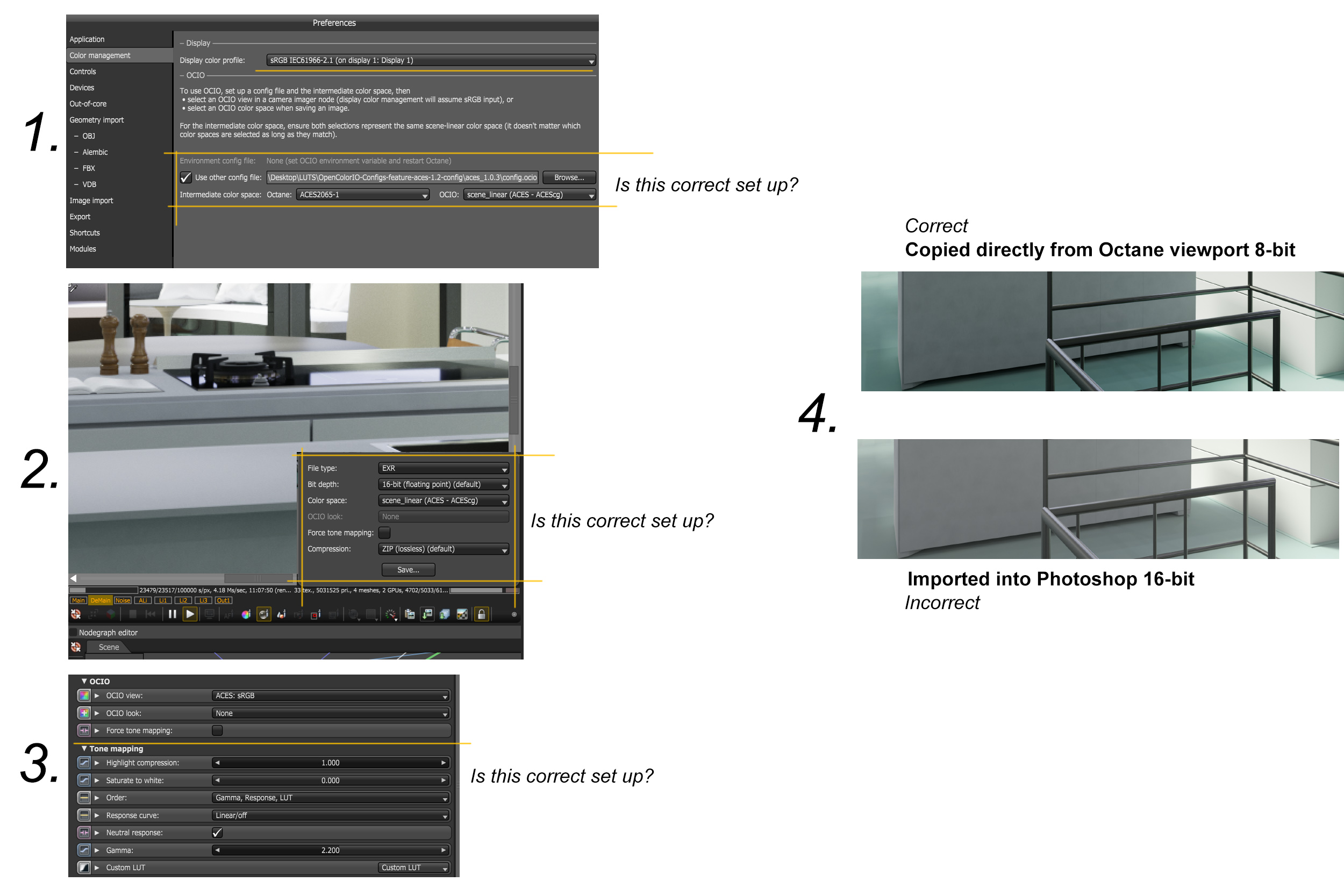

I noticed that, I think it`s important to have a correct workflow from standalone to Photoshop/Post first..
I have been trying kind of every setting, but can`t get the image I get in Octane correctly exported still.
The image still looks washed/desaturated or highlights are burned when I take it into PS, but in the Octane viewport it looks delociously, scrumptious and lightful :D
What is still missing?? :|

whersmy wrote:I noticed that, I think it`s important to have a correct workflow from standalone to Photoshop/Post first..
As you mentioned, you should setup Photoshop for ACES. Photoshop was never designed for such large color gamut's, it's unfortunate. Although we can be thankful this what I said is irrelevant as you can setup ACES in Photoshop and experience ACES in Photoshop. As I mentioned, setup ACES in Photoshop, then the images should look the same in both Octane and Photoshop.
I'll be setting up ACES in Photoshop very soon, so if you need help; let me know.

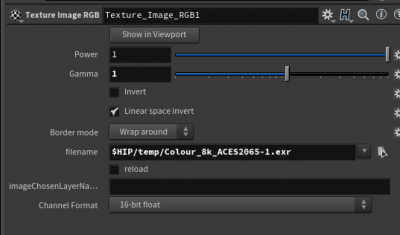

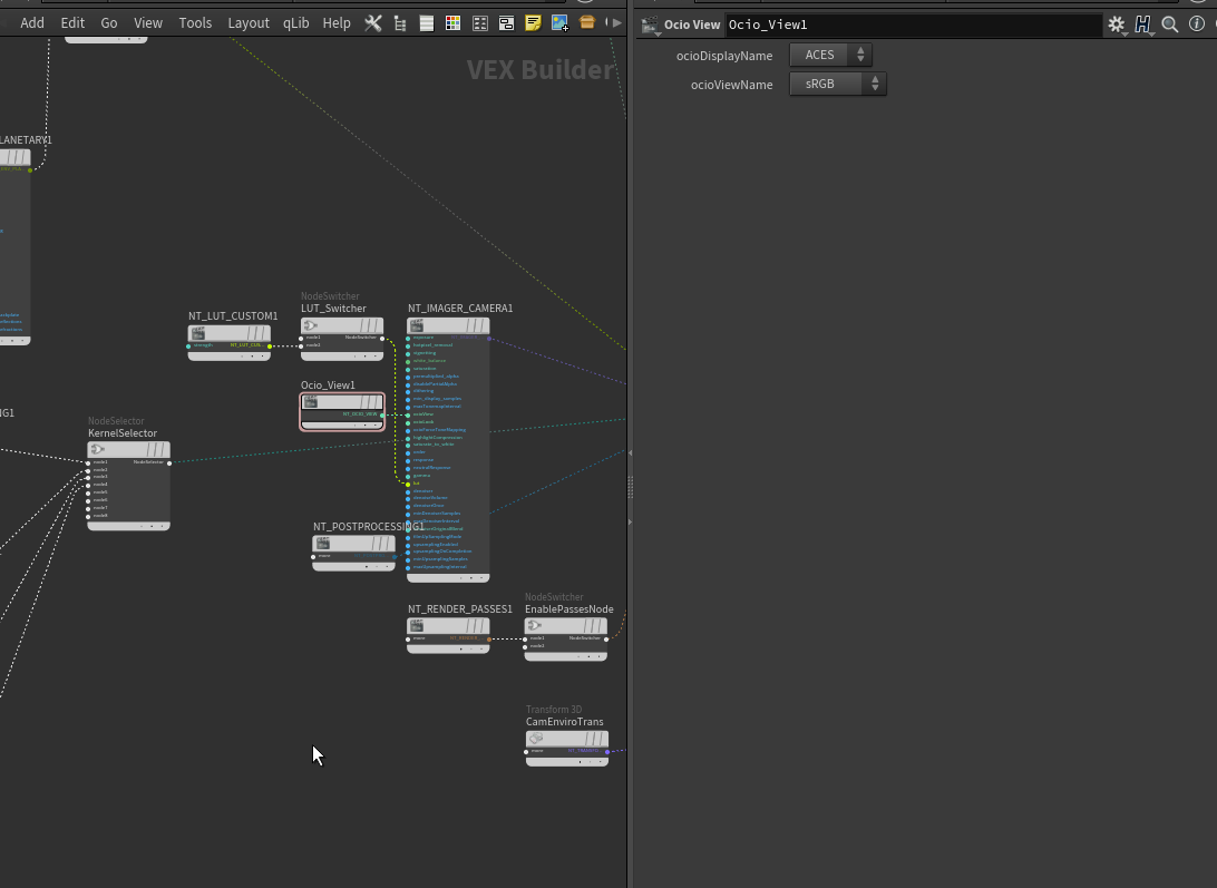

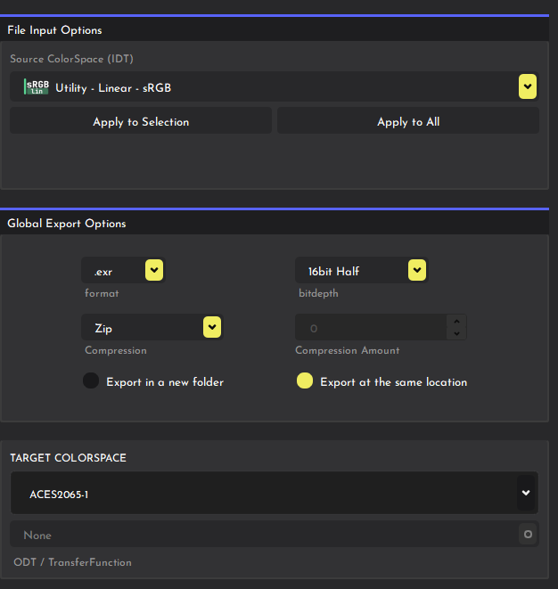

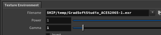

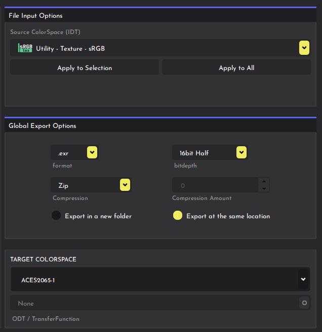

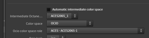

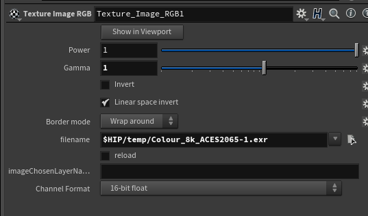

I would really appreciate some help with this topic.
I tried a few different scenes to test houdini/octane/aces workflow but cant get it right. The colors are wrong, greenish, over contrasty, dark. I must miss something.
Here is simple test scene, just a texture and an HDRI.
What I did:
- Set to OCIO env variable to ACES config file
- Convert texture and HDRI to Aces with PYCO colorspace converter, set gamma to 1
- Connect OCIO view node
- Octane ROP > intermediate colorspace = ACES2065, color space = OCIO, ocio color space role = ACES2065
Do I miss something?
Also I read this:
Here: https://chrisbrejon.com/cg-cinematograp ... stem-aces/
So why ACES2065 instead of ACEScg then?
Thanks in advance!

k3xx wrote:I would really appreciate some help with this topic.
What I did:
Also I read this:
Thanks in advance!
I have the same issue and same question
