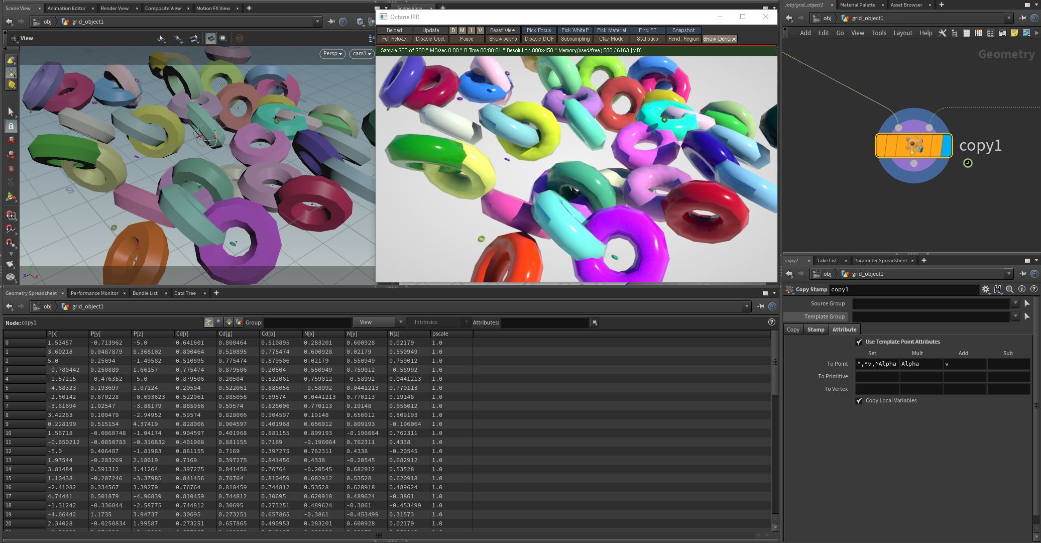

asamaniego wrote:Love the SOP level geo!
For some reason I can't get the copy's colors to show up. If I remember correctly, I used to be able to do it with an instance osl or the rgb4k_map in the tex folder by putting into albedo...not working anymore for me. Any help? Thanks.
Here it seems to work fine. Have you enabled the attributes options in the copy sop?

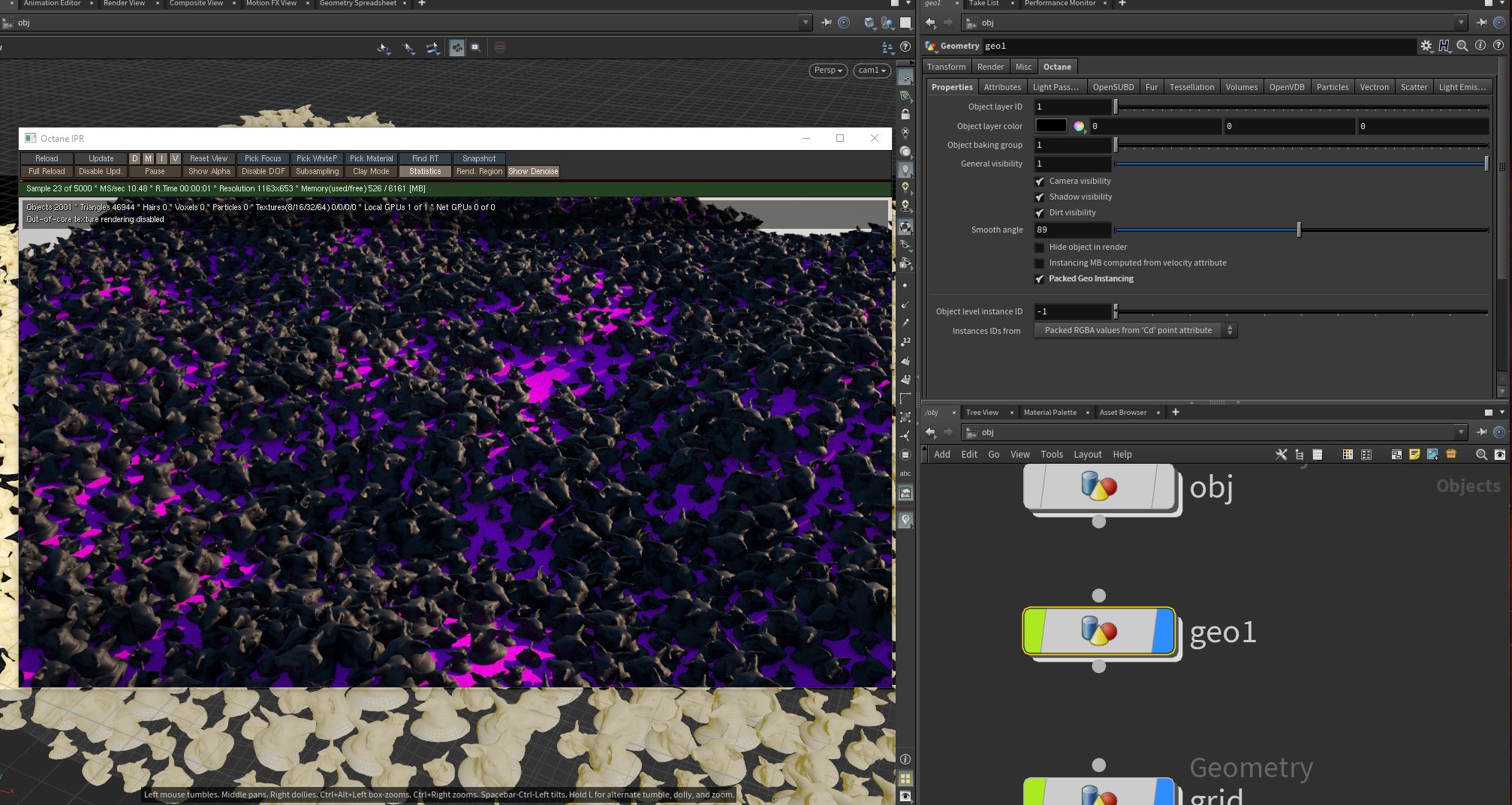

Hi!
How is this auto-instancing supposed to work? I can't get it to set up properly.
On the left is the instance variable approach, and on the right the copy stamp with packed geo approach.
juanjgon
Posts: 8867
Location: Spain
Do you have the option to pack geometry enabled in the copy sop? If you share the scene I could take a look at it here.
Thanks,
-Juanjo

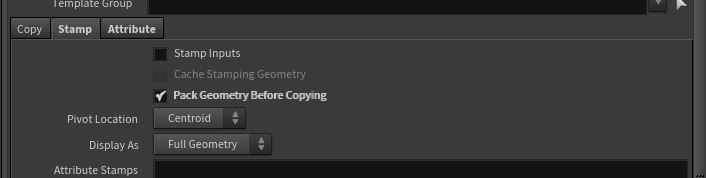

juanjgon wrote:Do you have the option to pack geometry enabled in the copy sop? If you share the scene I could take a look at it here.
Thanks,
-Juanjo
Yes, and it's enabled both in copy to points and copy stamp nodes.

juanjgon
Posts: 8867
Location: Spain
Hmm, but your OBJ node didn't have the option to instance the packed geo, probably because it comes from an older plugin version. Once added and enabled, everything works as expected.
