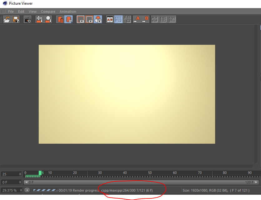

As you can see the c4d status bar indicates remaining cspp but you cannot see the octane status bar overlay on the render. Also I realised the Picture Viewer doesnt update the progress of the render. You see the rendered image after its complete. This is a different issue than my previously reported bug with black screen and no results in picture viewer. (not all the passes requested for tonemapping are enabled denoiserThread0: CUDNN_STATUS_BAD_PARAM)

aoktar wrote:Please change BUFFERTYPE=HDR not HDR-HALF, it's default and will fix it.
That indeed solved the status bar issue and black screen renders. It takes longer than previous stable release to render the scene though and I get this again at the end:
. Restart required
Edit: I get this error with or without Denoiser enabled.
