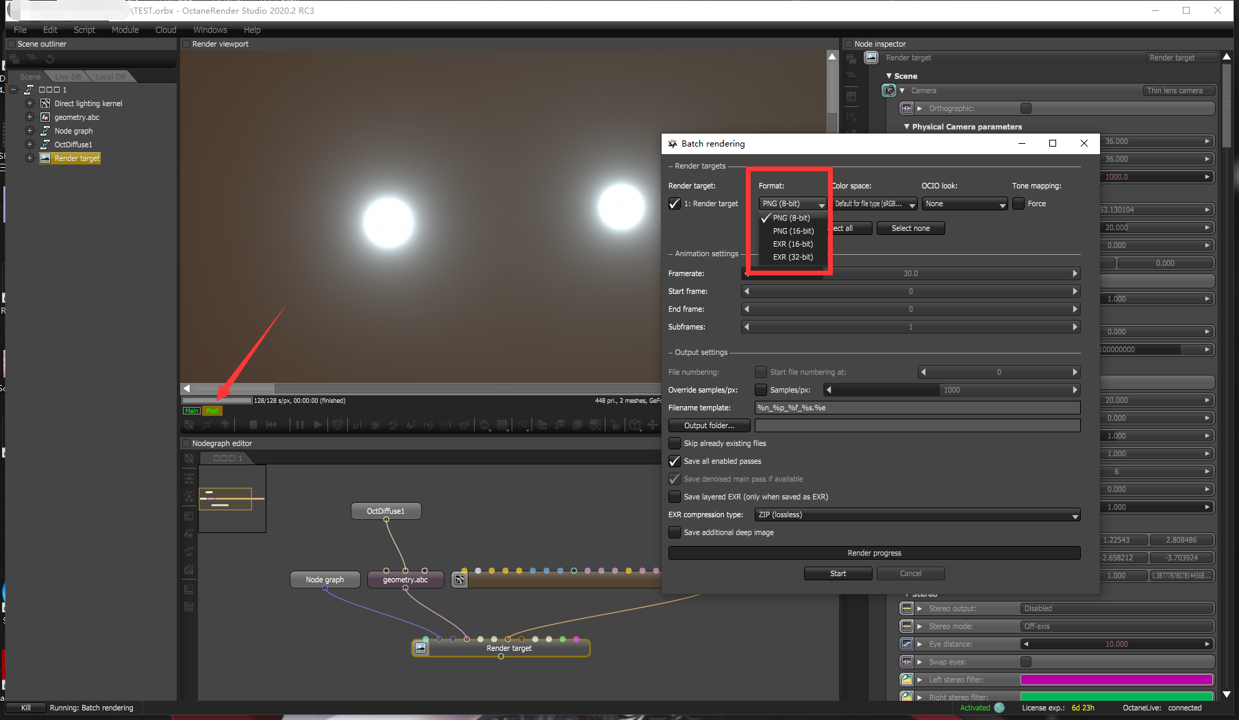

muoumuua wrote:The post layer in the output exr multi-channel is lost, from XB4 to RC3。
Please be aware we do not keep backwards compatibility with or between experimental builds so that might be the issue. If not, could you describe in detail what you do and what you expect to get vs what you see? Thank you.
muoumuua
Posts: 5
Joined: Tue Sep 19, 2017 11:23 am
I mean to use batch rendering, no matter what format the post layer will be lost。
TEST.orbx
(100.19 KiB) Downloaded 240 times
karl
Posts: 403
Joined: Sun Oct 13, 2019 11:26 pm
muoumuua wrote: I mean to use batch rendering, no matter what format the post layer will be lost。
Thanks for the details. We've fixed this issue and the fix will be available in the next build.
