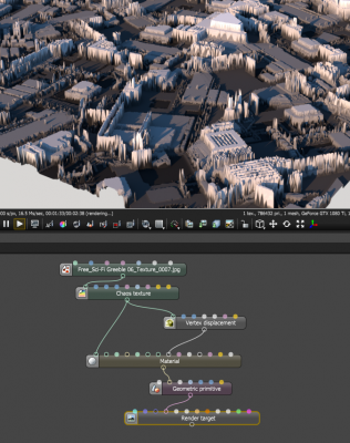

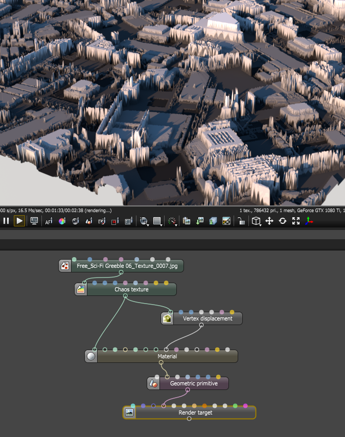

Lino it seems to be working here using vertex displacement. The chaos texture only accepts an RGB image node with an LDR texture though.linograndiotoy wrote:The new Chaos Texture is awesome.
Would it be possible to make it work with Displacement?

Let me check again!funk wrote:Lino it seems to be working here using vertex displacement. The chaos texture only accepts an RGB image node with an LDR texture though.linograndiotoy wrote:The new Chaos Texture is awesome.
- linograndiotoy
- Posts: 1549
- Joined: Thu Feb 01, 2018 7:10 pm
It looks like Vertex Displacement works fine with Chaos (but not when high dynamic range image formats are used, as you mentioned, which of course is some important limitation that needs to be solved).
I just found out Grayscale Image Node is also not working with Chaos Texture node.
Thanks for your test Funk!
