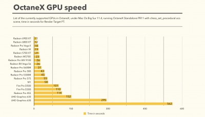

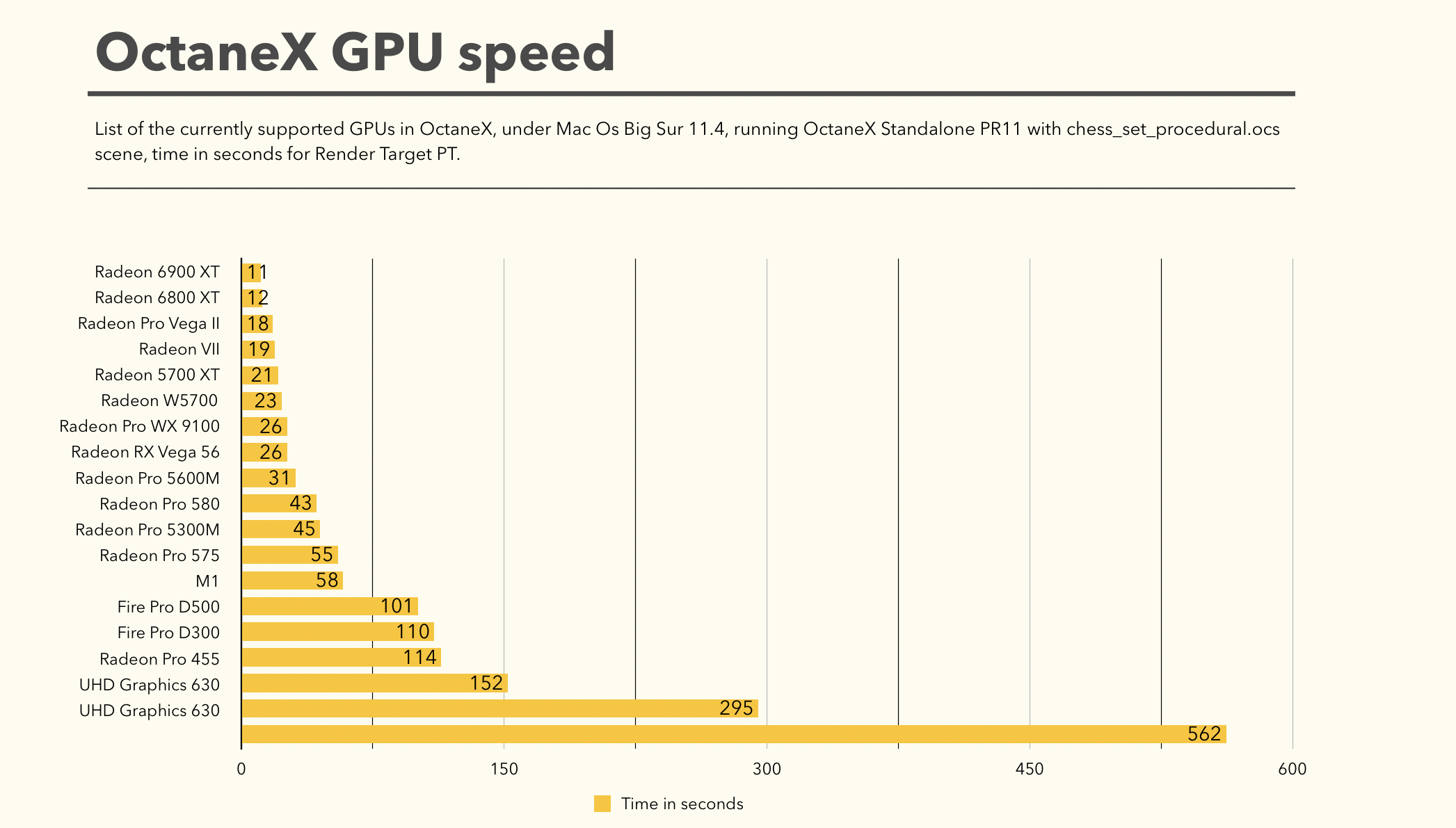

Maybe for other tasks, but not for GPU rendering.
TB3 is slightly slower when loading the scene on GPU, but after few seconds, when the scene is completely loaded into GPU VRAM, the rendering speed is exactly the same as an internal GPU.
So the speeds that you can see here are real, even under TB3 eGPU:

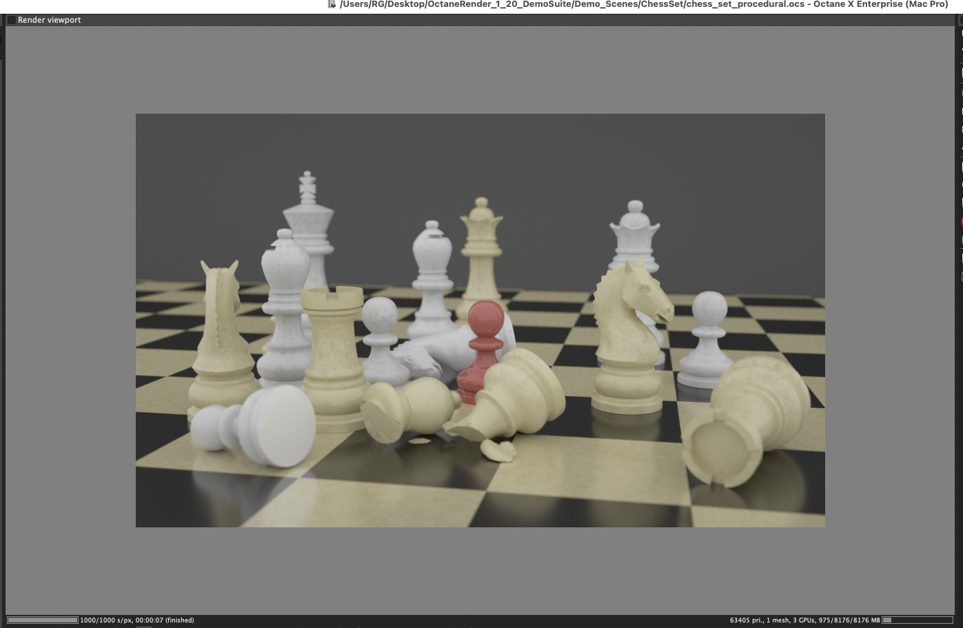

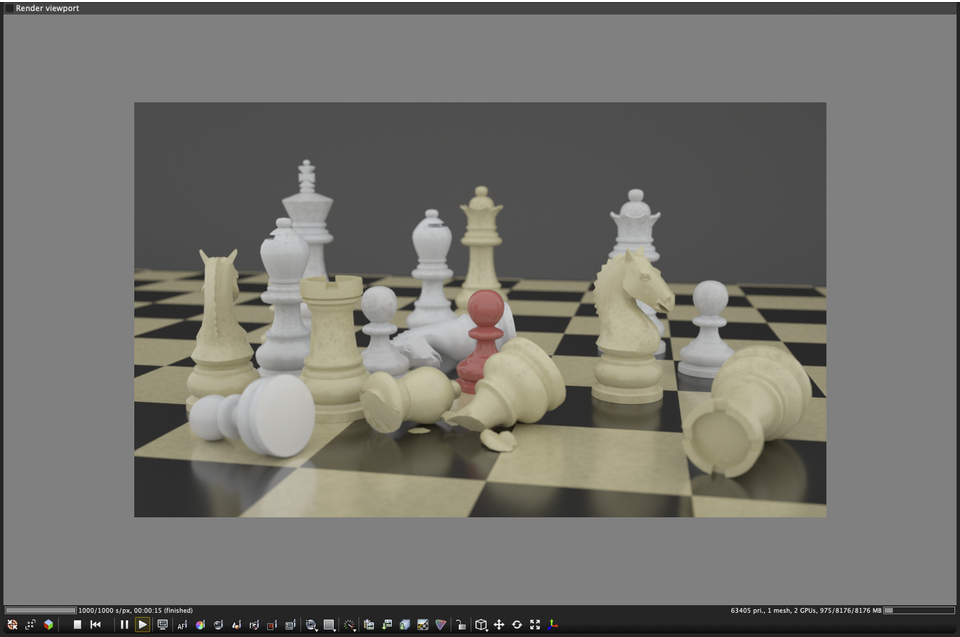

Got some numbers (and a set-up) that might be of interest to some people here.
I am running a MBP 16" Intel 2.4 GHz 8-Core Intel Core i9, with 64GB and a 5500M inside it.
Attached I also have 2 x Razer Core X boxes. One has a 5700XT and the other has a 6900XT (both are Gigabyte cards).
I've only run the Chess Scene and the results are:
5500M = 46 seconds
5500M + 5700XT = 15 seconds
5500M + 5700XT + 6900XT = 7 seconds
