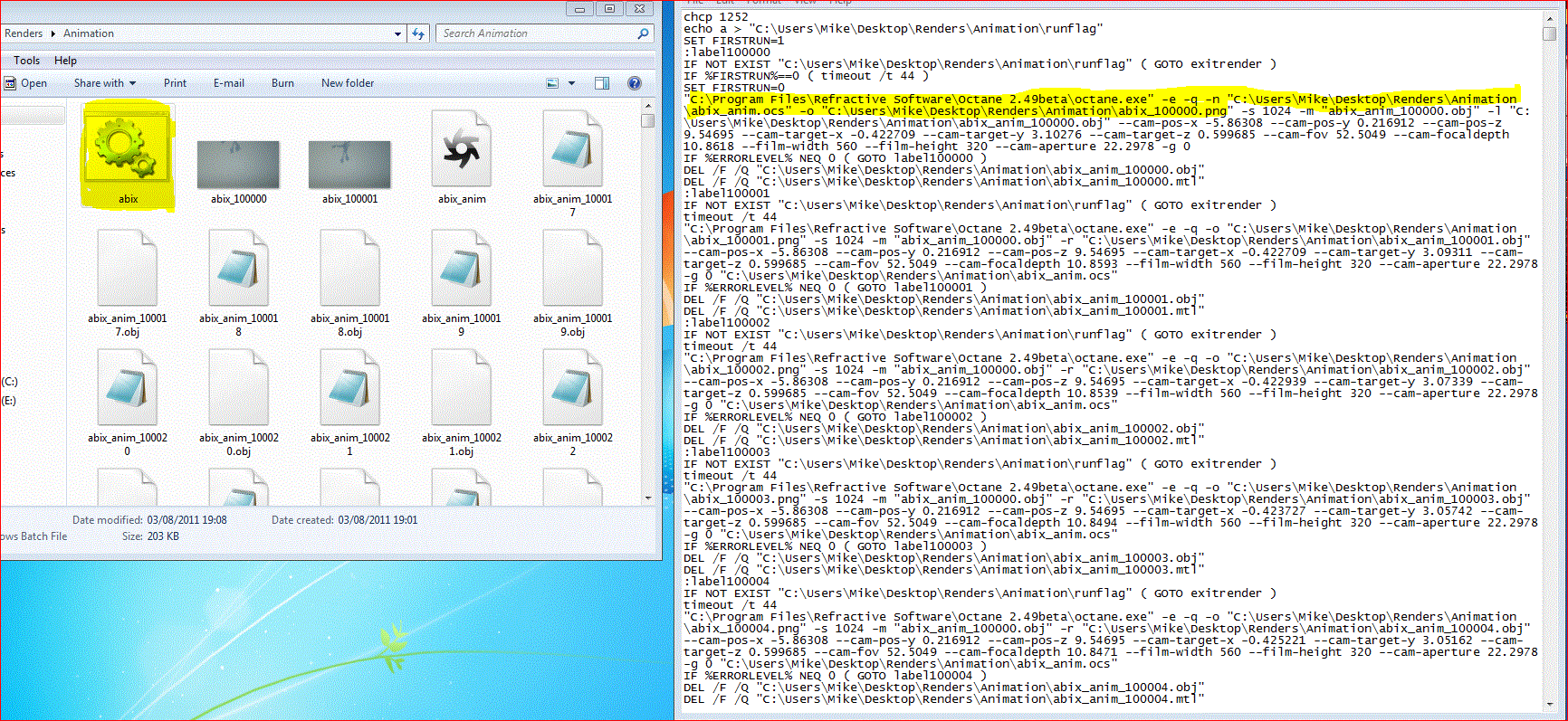

Ok i'll try that out.V1.18 exported all the 248 frames ok.However when it went to render them in Octane.It pointed to a folder level , 2 levels up from where the animation data was stored.Also it tried to read in frame 0000.The frame animation data started at 0001.Unless of course it deletes the frames render data as soon as it has rendered that frame.
Hope that makes sense.
CPU:-AMD 1055T 6 core, Motherboard:-Gigabyte 990FXA-UD3 AM3+, Gigabyte GTX 460-1GB, RAM:-8GB Kingston hyper X Genesis DDR3 1600Mhz D/Ch, Hard Disk:-500GB samsung F3 , OS:-Win7 64bit
Yes, if checkbox "Delete batch files" is set - it will delete .obj/.mtl file of just rendered frame...Jaberwocky wrote:Ok i'll try that out.V1.18 exported all the 248 frames ok.However when it went to render them in Octane.It pointed to a folder level , 2 levels up from where the animation data was stored.Also it tried to read in frame 0000.The frame animation data started at 0001.Unless of course it deletes the frames render data as soon as it has rendered that frame.
Will check it more, thank you!

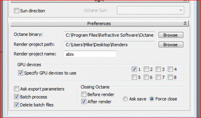

Ok. I think i've found the problem.
The max Exporter V1.19 includes a path you create so that it automatically makes a render folder with an animation sub folder for the animation files to be stored along with the windows batch file.

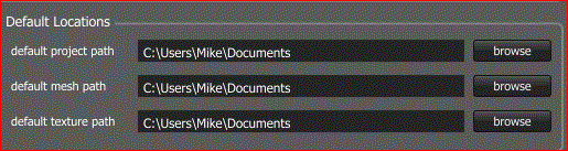

However.Once the batch file starts octane and tries to render the files in sequence.It uses the default path set up in the preferances tab.
Unless both of those line up with each other.Each frame octane loads up to try and render , it cannot find.
I think therefore the batch file needs to send the location of the render files along with the instruction on where to find them , if that makes
sense.
sense.

No, that was another problem, not in batch.
That is how Octane works with command line: if in the .ocs is linked file with name "c:\blabla_0000.obj" and nodename "blabla_0000.obj", then when I try to open existing .ocs in command line and say to him to relink to node with name "blabla_0000.obj" new file with name "c:\blabla_0001.obj" - Octane wants file with name "c:\blabla_0000.obj". To Octane is no matter that in command line stays key "-r" ("relink that node please with a file with THAT name"), he wants specifically old name that is stored in .ocs...
I think that is illogically, but it's so little things for such a wonderful render as Octane... We can solve all these little problems in this plugin...
Fixed it in 1.20. Awaiting a new bugs...

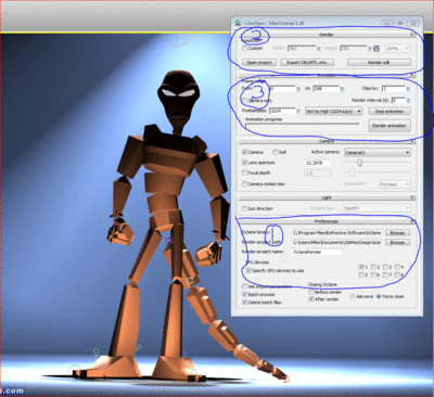

Jim
Ok.
The mechanics are working fine.
One problem.There is no way of setting the scene.
The way I think it should work is this
1) Select the export path to the render / animations folder.
2) Render out a single image with the resolution you require.Adjust the materials / lighting quality and kernal to use on this single image and then re-save it.
3) click the animations button.It then references the previously saved frame and renders the animation based on these settings.
Ok.
