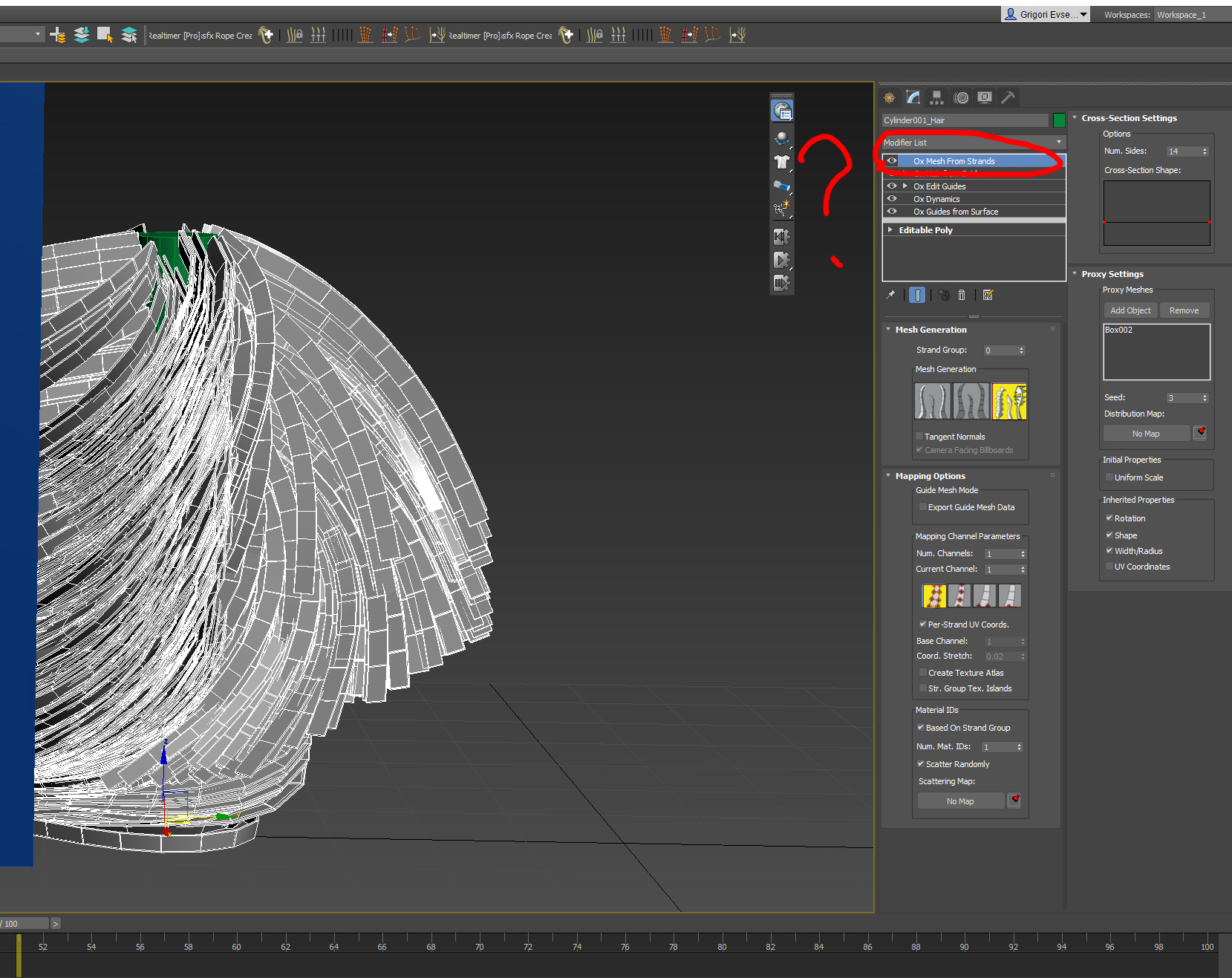

Hi Paride,
Do I always have to add ornatrix mesh modifier for octane to render hair? What if I have millions of hairs? Thank you. Without this mod octane doesnt render hair

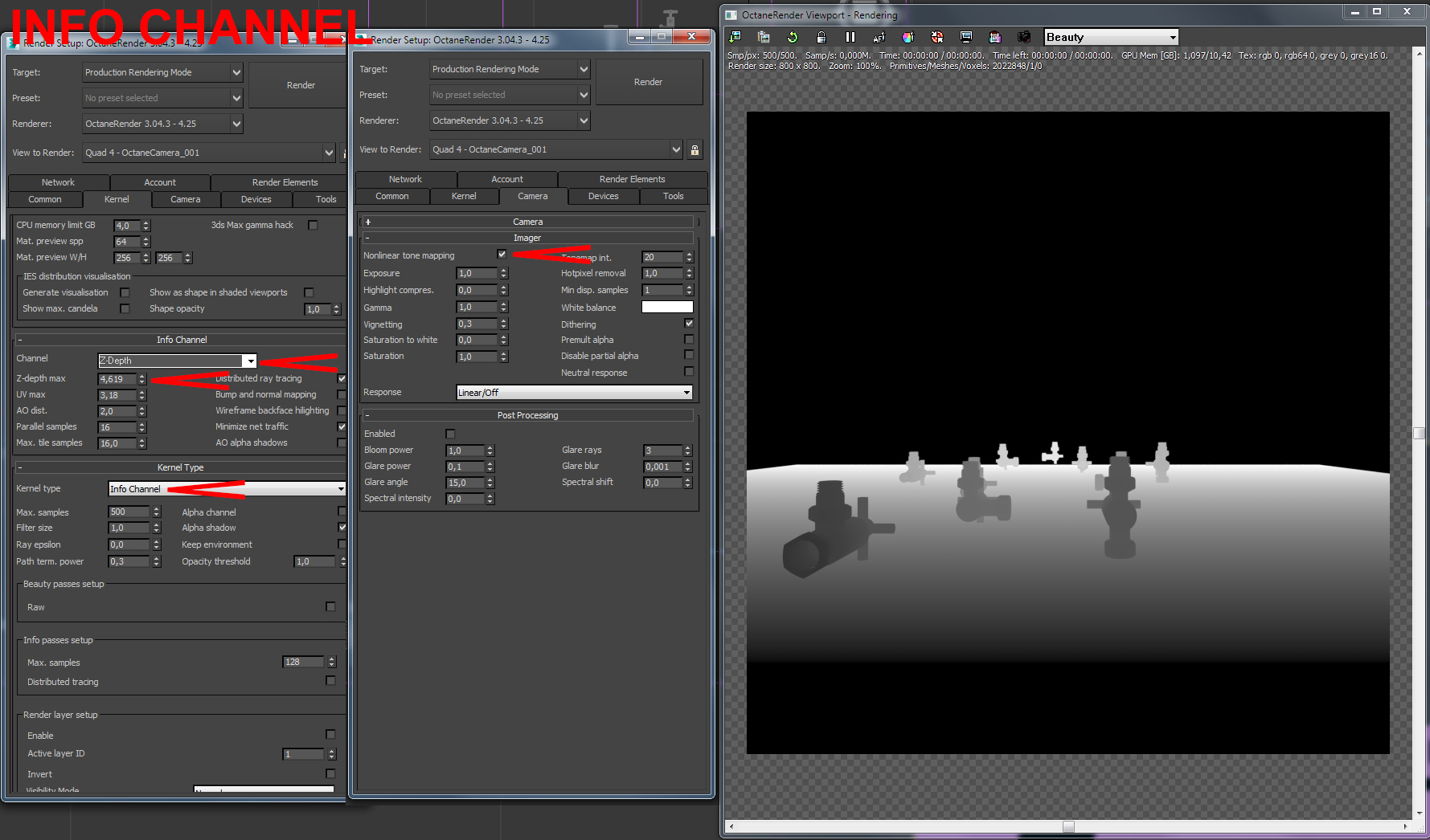

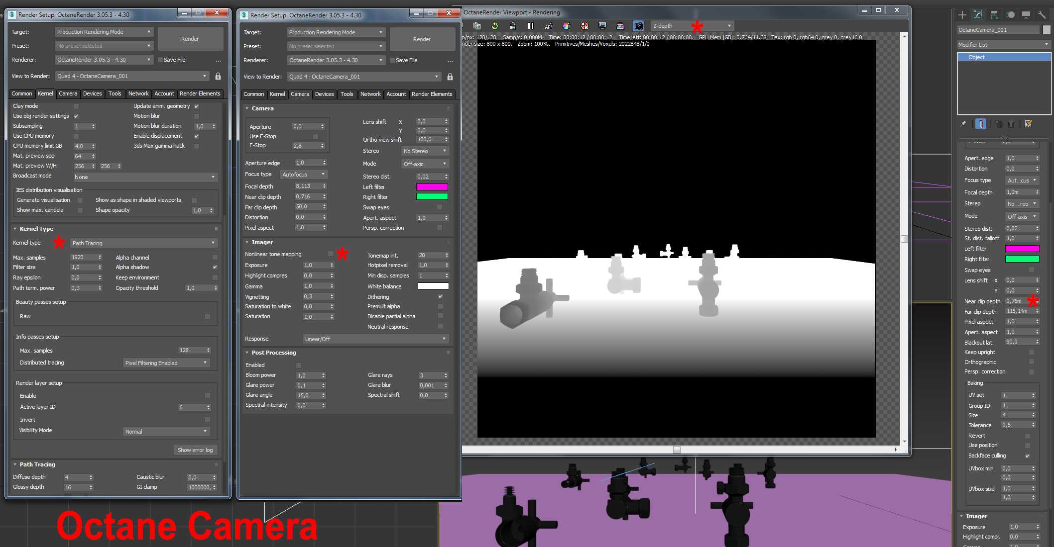

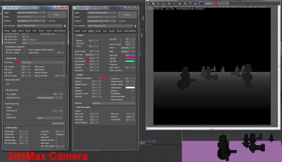

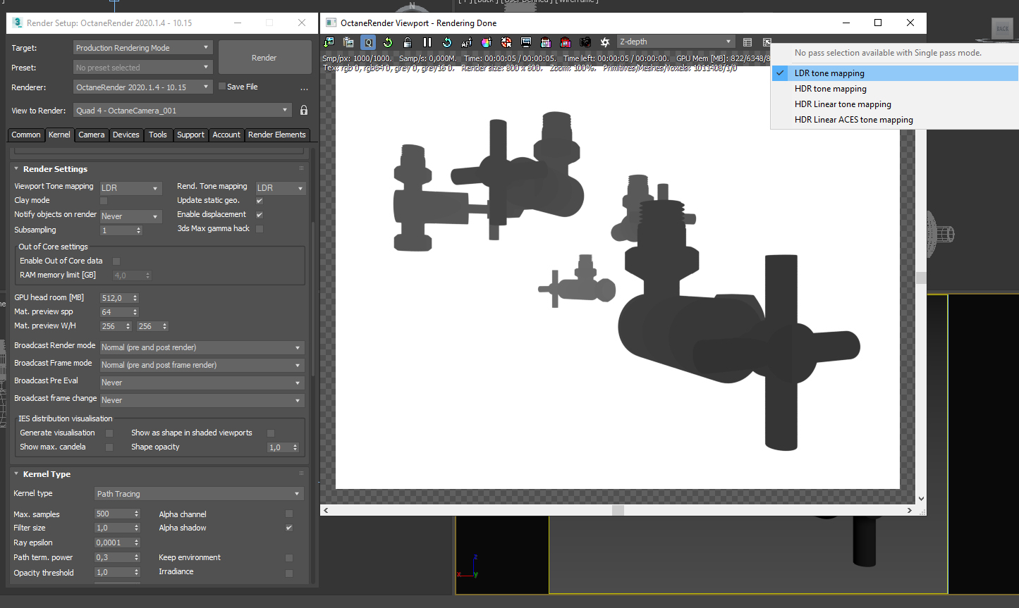

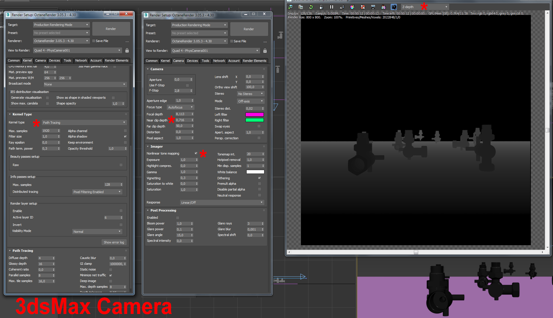

In preview mode, the z-depth channel does not react to the settings, you can see what you get only in the renderer.
in the last version was the same.

Sidches wrote:In preview mode, the z-depth channel does not react to the settings, you can see what you get only in the renderer.
Hi Sidches,
Sidches
Posts: 31
Joined: Wed Nov 15, 2017 9:40 pm
I found the reason.
in this topic we are discussing the latest version, not 3-4. ;)
