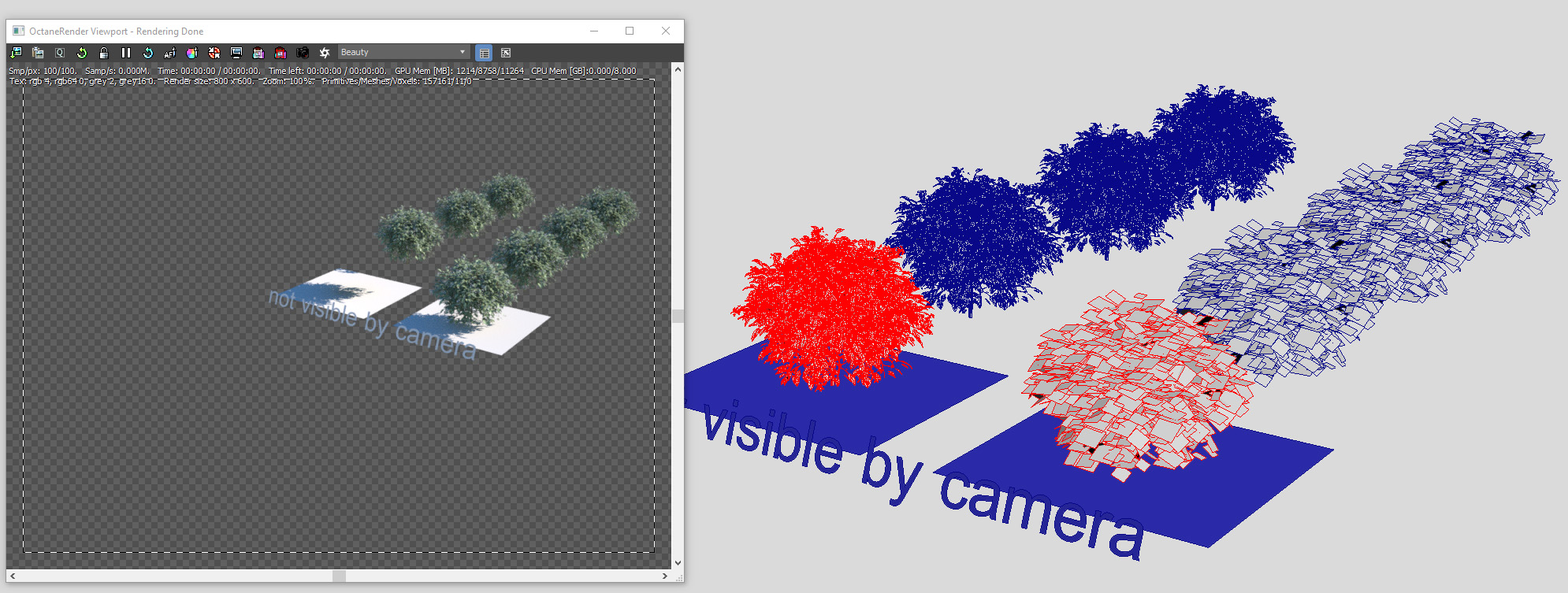

HHbomb
Posts: 1378
Hi, I have a problem with this version and some before.
I have already reported it.
When I have instanced proxies, when I set one ( for eg ) not visible to camera, sometimes it works, sometimes no. Specially when you re-open your file or clear objects in globel settings.
see pict. Very very annoying, when you mix seen and unseen trees in a render.
Please, it is important.
