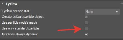

Hi guys, the setting USE ONLY STANDART PARTICLE is still not set by default, every new project needs to be opened, checkboxed, saved and re-opened. =(
tyflow settings
tyflow settings
