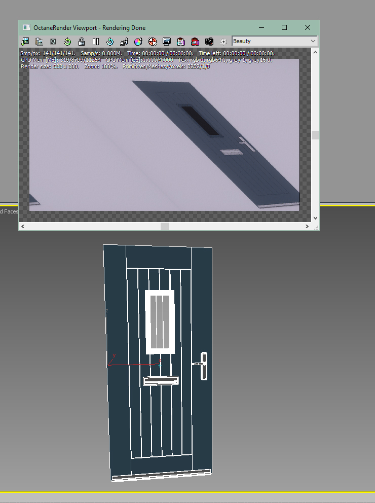

OK here's a new one. New to me at least.
Why is the Octane viewport render being so distorted?
Kind of a big problem...
Seems like it's something to do with upsampling.
Gonna make the animation I'm supposed to be cooking today quite stressful :cry:
Edit: Ticking use production resolution seems to fix it. What's happening?
Edit Edit: That only worked for a while. Gone screwie again. So made a new Octane camera and that seemed OK. Then made a standard max camera and that was screwed straight away. Could it be a max display/viwport type thing?
