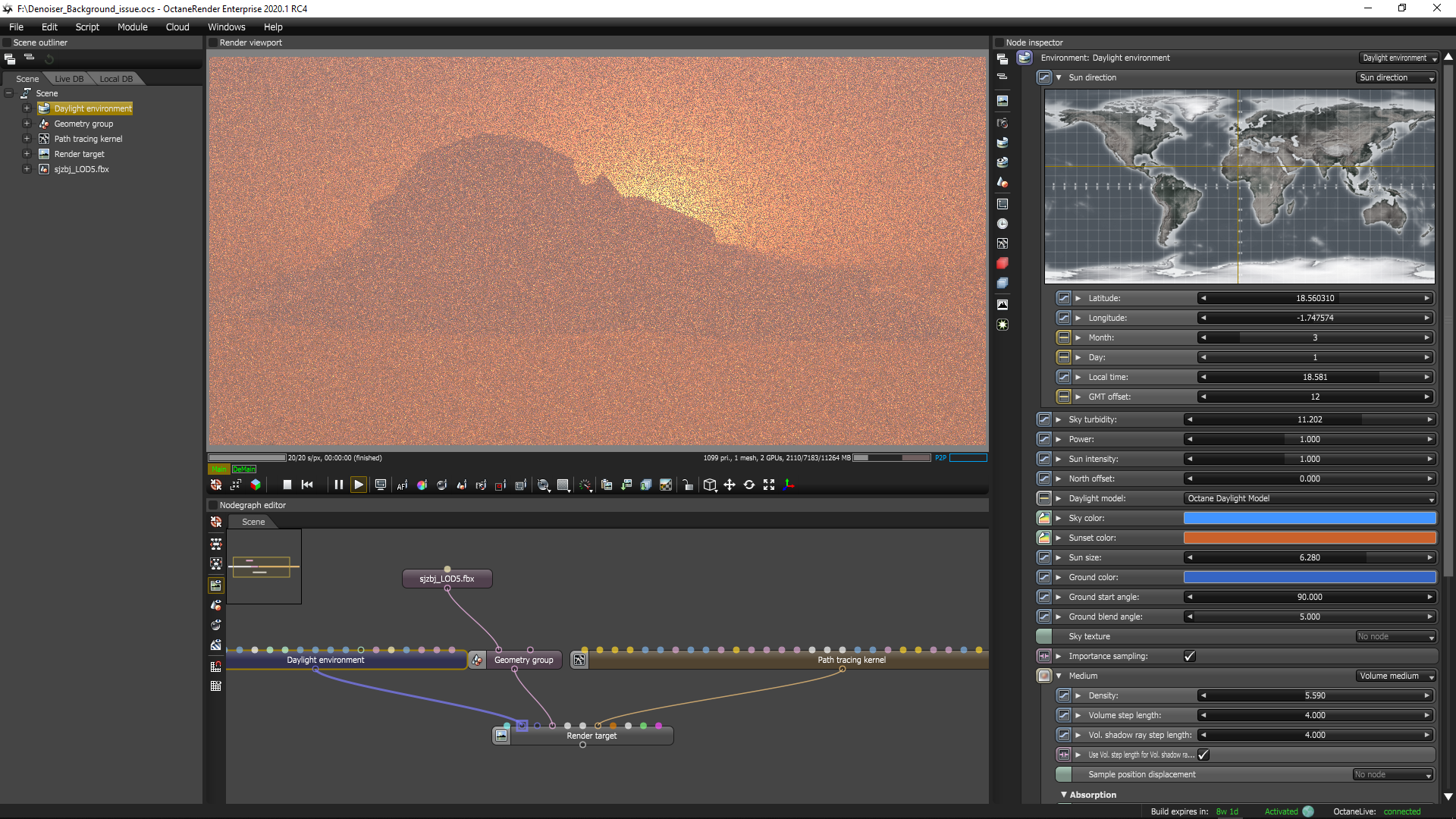

It looks like Denoiser is not working properly on the background in RC4 if a Volume Medium is used.
Beauty: Denoised:
Beauty: Denoised:
