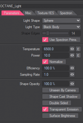

So this is now a spectron light even though Spectron light is not selected as a Light Type ?
juanjgon
Posts: 8867
Location: Spain
BorisGoreta wrote:So this is now a spectron light even though Spectron light is not selected as a Light Type ?
Yes, with this flag enabled the plugin is going to add a spectron light to the scene.
Thanks,
-Juanjo

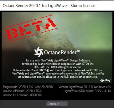

juanjgon
Posts: 8867
Location: Spain
Can you please check the installed plugin in the "About" window? Or perhaps if you have two or more plugins installed in the plugins window? I'm fairly sure that this is an installation issue because here it works fine, and I have no other reports about a problem like that ... only one some days ago, and it was an installation issue.
Thanks,
-Juanjo

Yeap, I just installed LW 2019 and Octane plugin works perfectly, I can access the kernel node properties without any trouble. So I think that the lw 2019 version of the plugin doesn't work completely with LW 2020.01.
