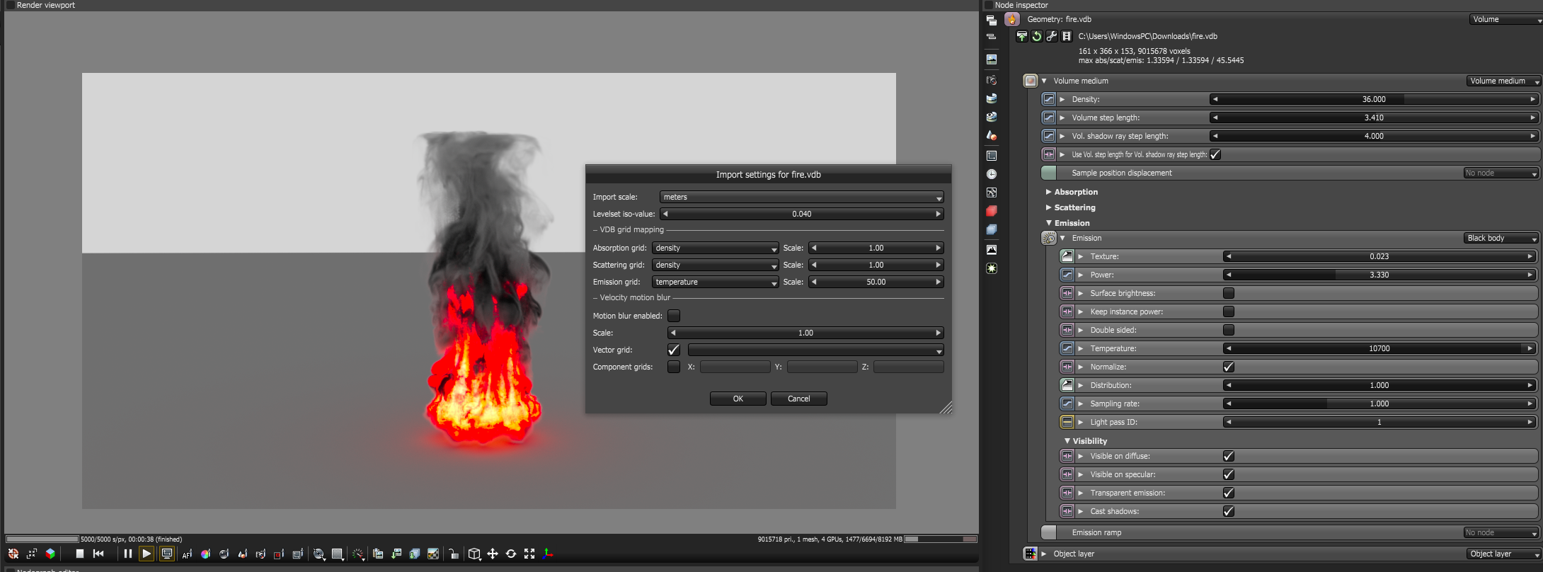

linograndiotoy wrote:
J.C wrote:
You should always use Texture Emission with volumes. Blackbody Emission doesn't carry any VDB Emission information.
Documentation says different:
For emission, the Medium node can have either a Blackbody Emission node or a Texture Emission node.
CPU – i9 13900KF, 128GB RAM, GPU – RTX 4090
System – Windows 11
My Behance portfolio, Blender plugin FB support group
linograndiotoy
Posts: 1532
Yes, documentation says differently, but as a user I don't remember I could ever use BlackBody as emission value for a VDB.
rohandalvi
Posts: 170
Joined: Tue Apr 20, 2010 7:39 am
You can use blackbody emission but you need to remap the temperature or heat field to relevant values. You can do that in Houdini. If you shift the range from 0-1 to 0-3500 or 0-4500 or something like that then the blackbody emission will work.
Regards
Rohan
Posts: 10610
J.C wrote: Documentation says different:
Hi J.C,
maybe if continue to read you could find this:
When using the Blackbody Emission node, make sure that the emission grid data contains temperatures in Kelvin. VDBs often have unit-less temperatures with arbitrary ranges such as 0 - 1 or 0 - 45, as is the case with some sample VDBs from openvdb.org. Typical temperature values range between 0 - 6500, where lower values create longer wavelengths, and higher values create shorter wavelengths. In order to get realistic results from the Blackbody Emission for volumes, disable Normalize in the Emission node. Lower temperatures give off less light than higher temperatures, but when normalized, the radiance emitted by all temperatures is equal.
https://docs.otoy.com/StandaloneH_STA/S ... e%20medium
Happy GPU Rendering,
ciao Beppe
J.C
Posts: 1878
Joined: Thu May 13, 2010 6:35 pm
Location: Wrocław
rohandalvi wrote:You can use blackbody emission but you need to remap the temperature or heat field to relevant values. You can do that in Houdini. If you shift the range from 0-1 to 0-3500 or 0-4500 or something like that then the blackbody emission will work.
Regards
Rohan
Actually you can do this in Octane by scaling the Emission grid in VDB properties.
System – Windows 11
linograndiotoy
Posts: 1532
It makes sense only with VDBs using Kelvin to store information, which is pretty rare.
