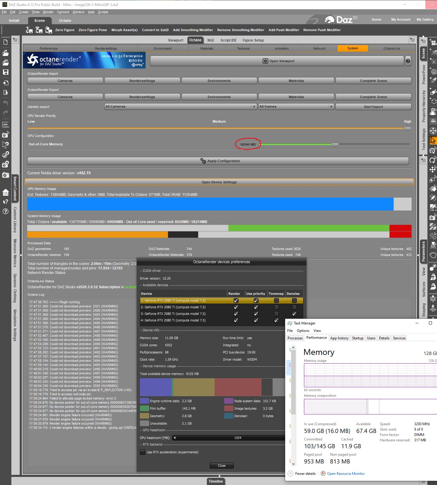

If you want Octane to be able to use your whole system memory for OOC you must specify that in your plugin settings which currently is just above 33GB, my guess is that your standalone settings allow higher memory usage and this is the reason why the scene can load.rajib wrote:As you can see in the attached screenshot my system still has 66 GB of RAM still available when the error occurs (I have 128GB of RAM installed in my system). So that should not be the issue. Is there any way to check how much memory is being allocated ? Can it be more than 66GB even though the OOC memory is set to around 30+GB ? Can the memory being allocated be logged so that it can give a clearer picture.
OctaneRender™ 2020.1 RC2 [superseded by 2020.1 RC3]
- paride4331
- Posts: 3992
Hi rajib,rajib wrote:As you can see in the attached screenshot my system still has 66 GB of RAM still available when the error occurs (I have 128GB of RAM installed in my system). So that should not be the issue. Is there any way to check how much memory is being allocated ? Can it be more than 66GB even though the OOC memory is set to around 30+GB ? Can the memory being allocated be logged so that it can give a clearer picture.
Like I have mentioned same scene I can render in the standalone. So the standalone is definitely able to allocate the required memory needed for the scene. If you look at the screen shot "System Memory Usage" it shows clearly that there is enough memory available and also the OOC used / reserved shows 20+ GB still available.

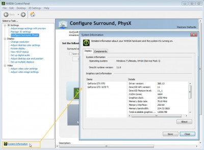

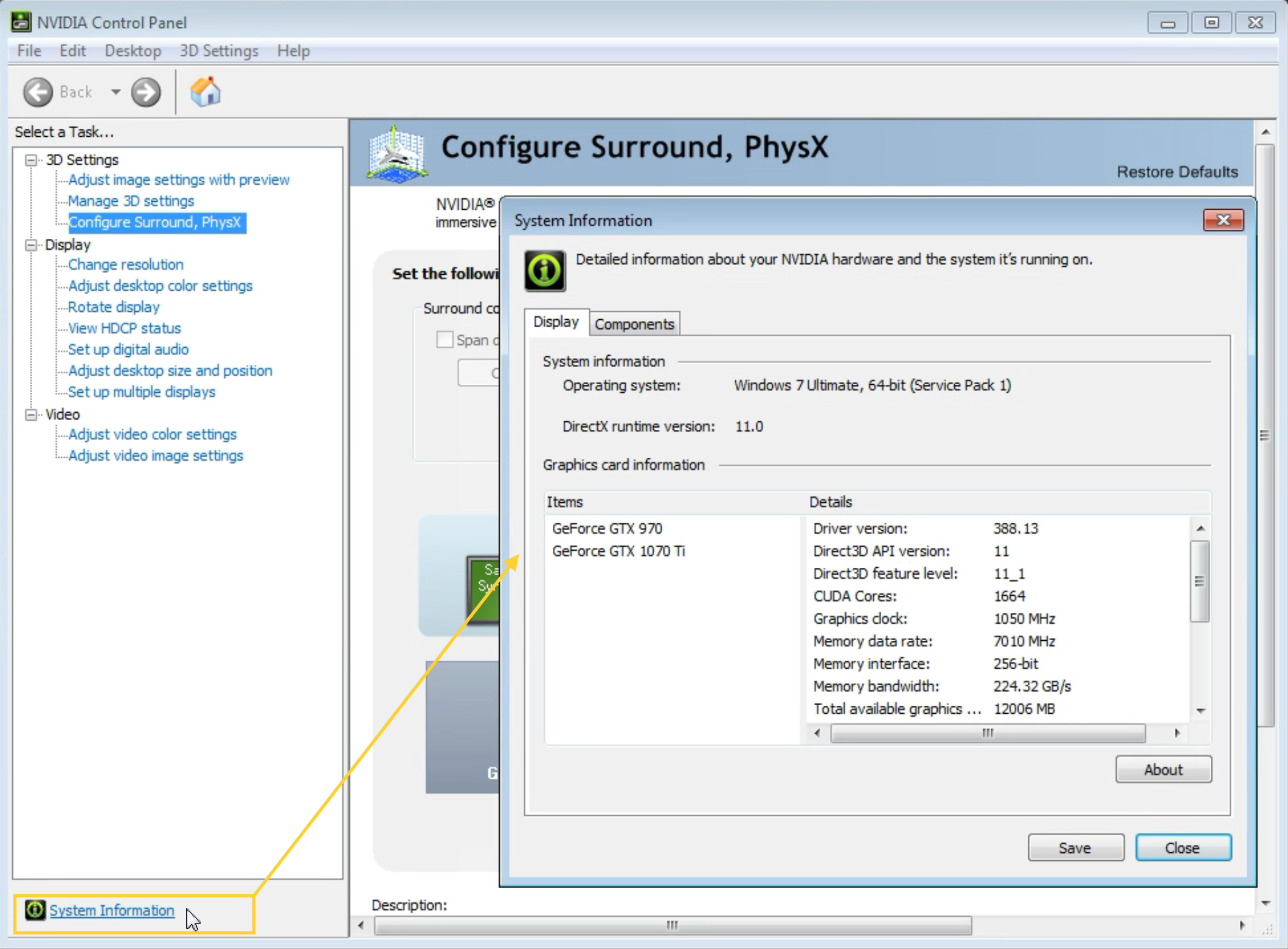

could you navigate to your Control Panel/Nvidia Control Panel, press the System Informations link, and share a screenshot like this?

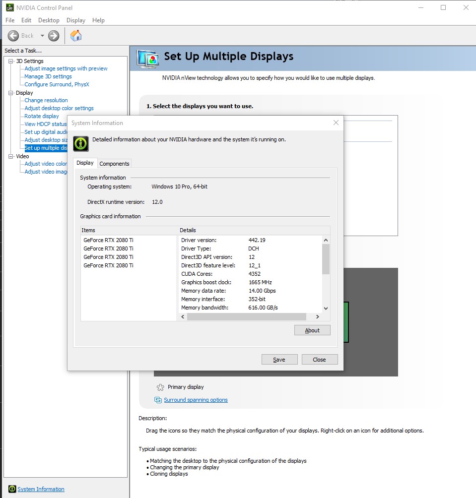

Regards
Paride

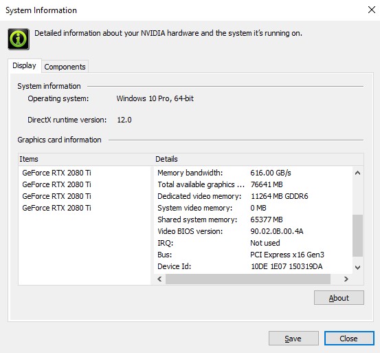

As requested I have attached the nvidia info panel screenshot.

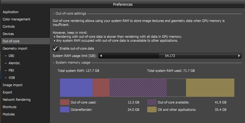

This is how the standalone was configured when it rendered successfully. Currently I allocated more memory than I did in the standalone and it still failed.
The standalone shows 41GB+ of out-of-core used. So even if the 33GB allocation render failed because it needed more OOC memory allocation, the plugin should have rendered the scene with 66GB allocated to it which was more than the 54GB allocated in the standalone.

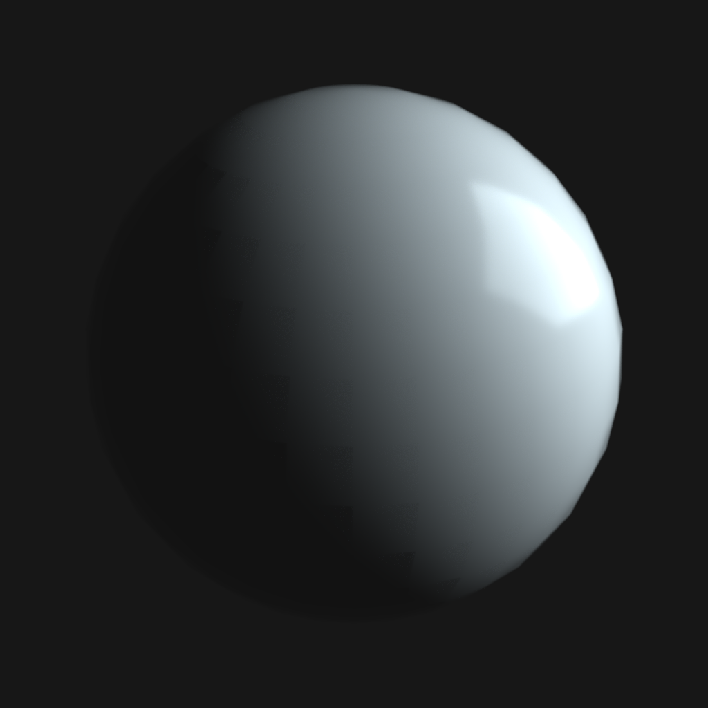

I have an issue with faceting, i'am not sure since which release it occures. I opned a thread in the daz3d plugin section where i thoughed it would inheriate from the sss channel but it seams to be a general issue. (viewtopic.php?f=44&t=73989)
I created a simple scene with a spehere with a simple glossy material (Smooth is enabled) and a plane to light it. Even there the faceting is visible. i know i can reduce the effect by increasing the subdevision but there are cases where i dont want to. Is this an issue, is this a problem of settings?
I attached the simple scene.
