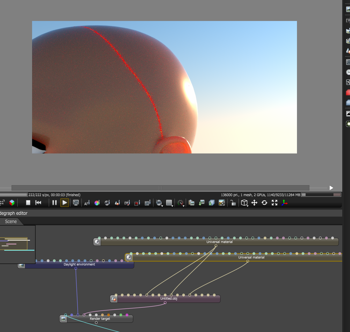

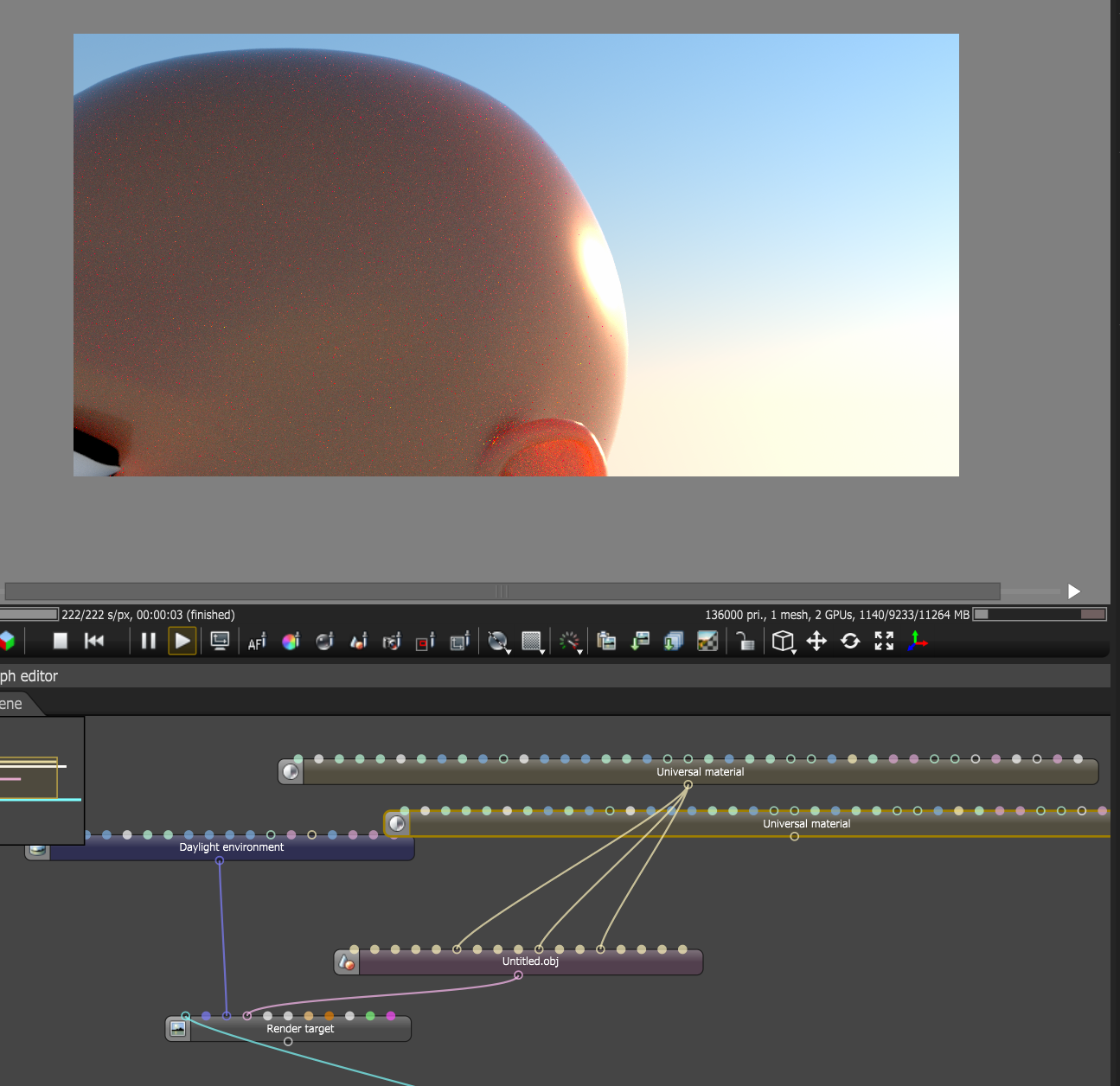

The Random Walk medium still shows seams when two materials are used on the same object. This is a regression from the old node. It seems to happen even with no textures and a duplicate material node. See screenshots.
Using duplicate material.
Using the same material
Reason: This has been logged as ticket #3985.

Dmikucki wrote:The Random Walk medium still shows seams when two materials are used on the same object. This is a regression from the old node. It seems to happen even with no textures and a duplicate material node. See screenshots.
Does this happen by any chance just when you enable RTX acceleration support in the device settings? We have internally solved a few issues that didn't make it into this release that could be causing this. Would you be able to share this scene or a trimmed down version we can use to test your report? Thank you.
