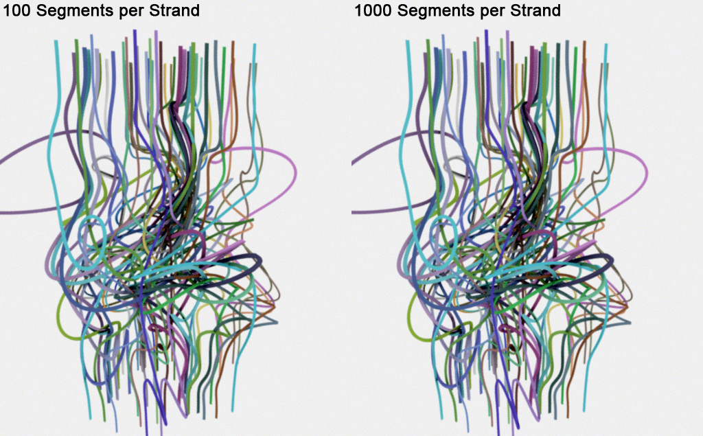

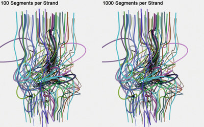

An other thing wich can cost time is the subdivision of your strands, called number of segments in Softimage.
Because i use internal a bspline, the strand can have minimum 1 seqment. The rest of needed points will be calculated so that my bspline will have 3 points.
My hint is to use so few segments how possible. It makes no sense to use 1000 segments if you can have nearly the same result with 100 segments.

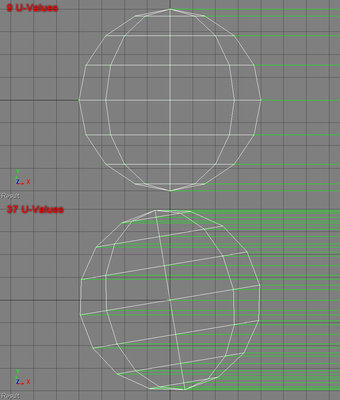

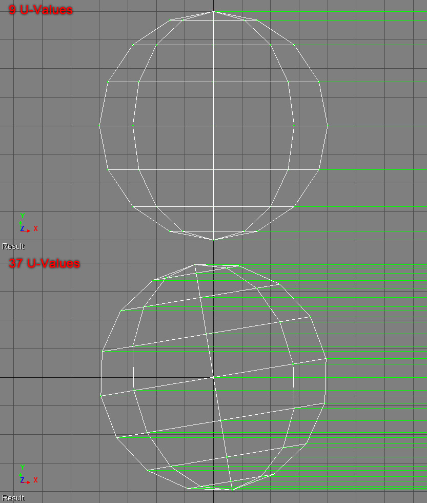

Here a example:
You should also avoid to rotate the shape because then the plugin must calculate more U values.

For simple particles, i have a routine which sorts the shapes, so that the plugin export first all particles with shape one, then with shape two and so on.
This will save time to read in the shape geometry to the number of used shapes. The plan is, to implement this also for strands.
