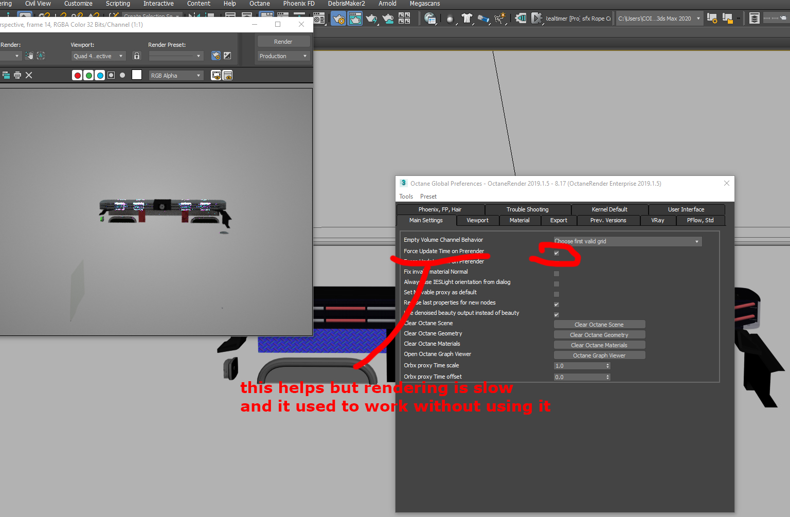

Hi Paride,
This version doesn't update animated Amount value during rendering in mix material
I attached the scene, If you render from frame 11 to 12 lights should change but they don't during rendering. If you open octane viewport and slide the slide it will update

Hi coilbook,coilbook wrote:Hi Paride,
Sorry about that; this will be fixed in the next release
Thanks for your scene, and the work-around to use 'Force Update Time on Prerender' in the global preferences !

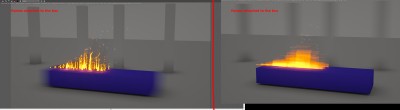

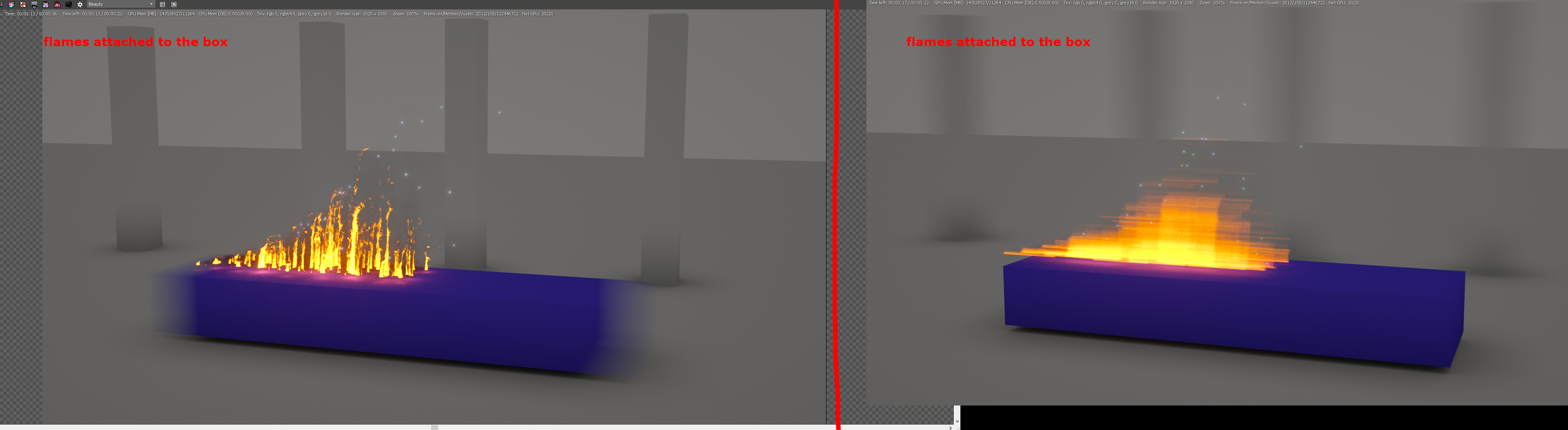

Hi Paride,
HEre is the scene with improper phoenix motion blur. At least if they can fix camera motion blur (reverse it)
Please try attached camera to the box and stationary camera. Phoenix mb does opposite effect unlike the box.
scene link https://wetransfer.com/downloads/921c5b ... 543/23b532

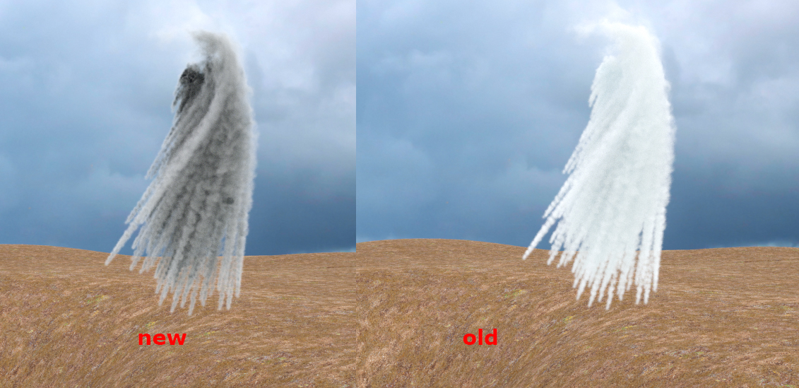

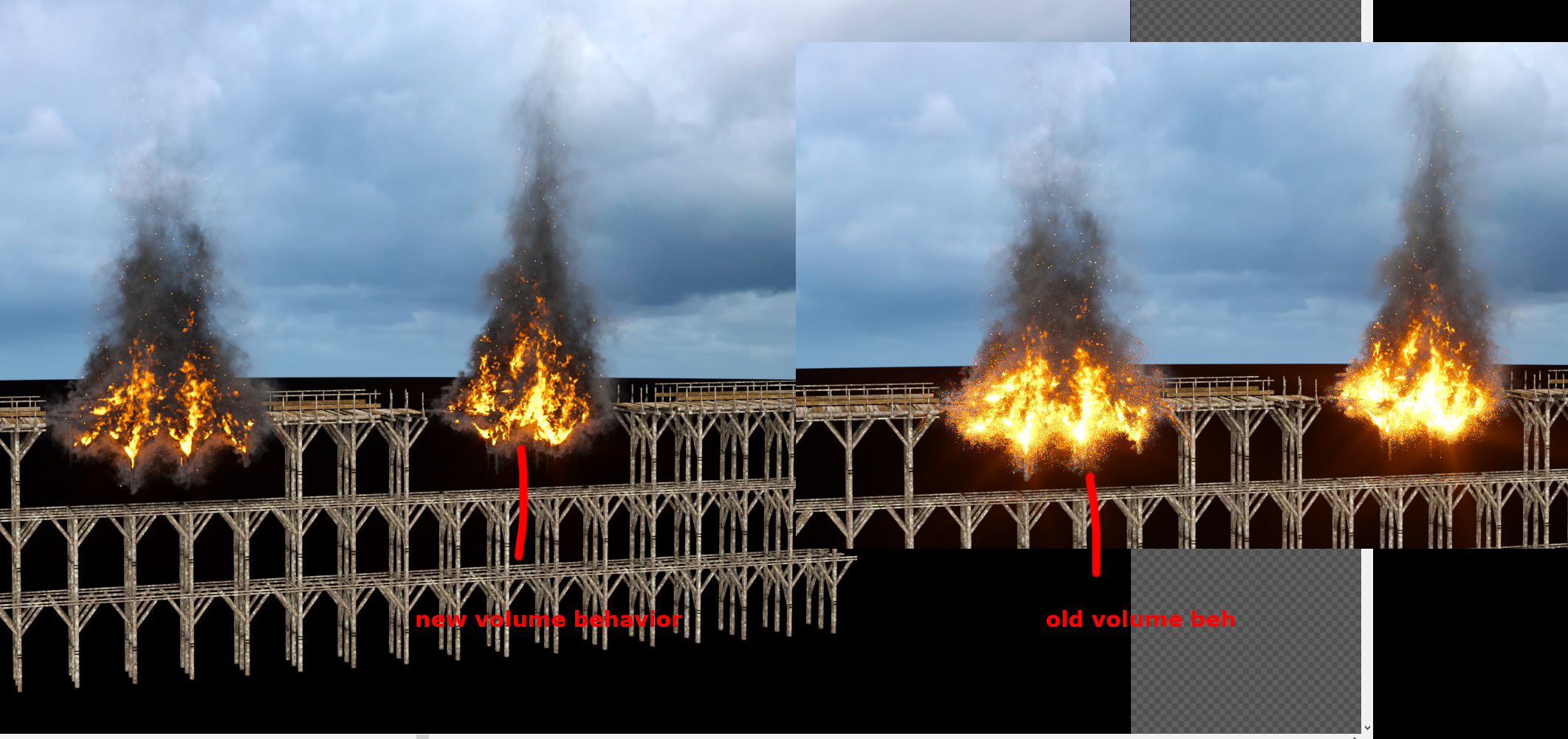

Hi Paride,
1. Could you send me a sample scene where you have no difference between old and new volumes? I just want to try on my PC.
In my scene we can clearly see the difference. New volume doesn't scatter well and it is darker. Please try with AO kernel
2. Do you know if phoenix motion blur bug will be fixed soon or it is a long process to fix it?
Thank you
