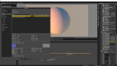

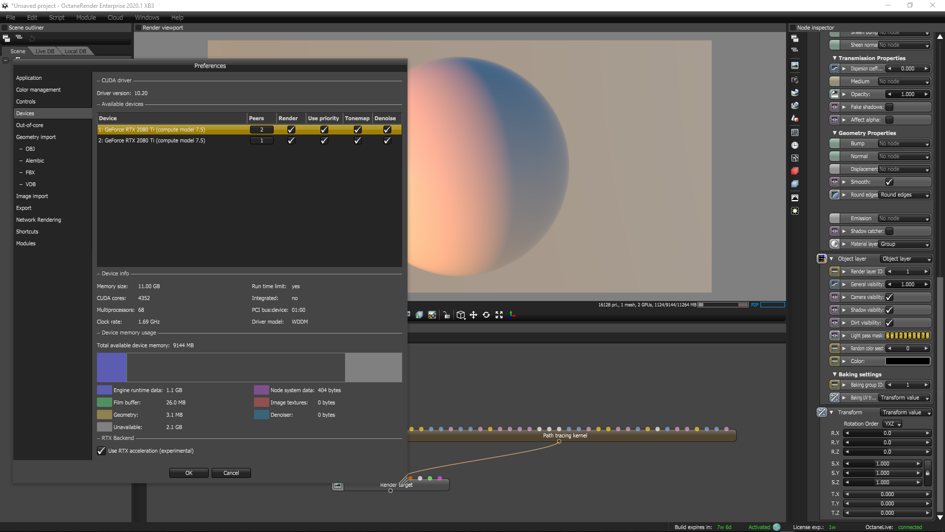

Smooth in material option, dont work with rtx in this version?
- linograndiotoy
- Posts: 1403
- Joined: Thu Feb 01, 2018 7:10 pm
It's working fine here. Could you please post a screenshot showing the issue?Tharso wrote:Smooth in material option, dont work with rtx in this version?
Thanks!
