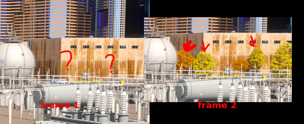

this itoo problem is so bad I am not sure how to render anymore. I can isolate one itoo object lets say trees it will render it. Then unhide the whole scene and start rendering and i won't have trees anymore even though I made my reference geometry renderable. I can have cam 1 render trees and camera 2 will not.
and after rendering if you try to switch from direct to legacy mode it crashes max

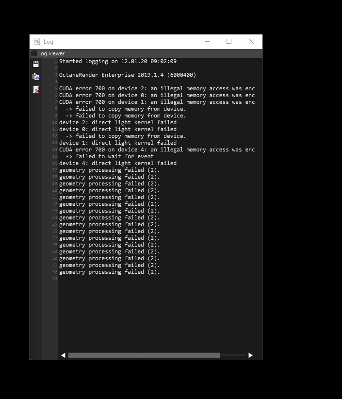

Hi Paride,
for some reason every time we render the second time (different camera angle) or if we adjust emission ramp color when octane viewport is opened and then start rendering 3ds will crash. I will try to send the scene
It seems that anytime we try to do the second rendering we have cuda 700 illegal memory and max must be rebooted. Maybe ram/vram leak?

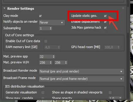

coilbook wrote:Hi Paride,
1. It looks like texture emission ramp (color animation) is not updated during rendering.
2. There is a very strange bug with large scenes and maybe related to itoo and phoenix. We started rendering the scene it took 40 sec to process geometry after 40 frames or so processing dropped to 7 seconds. It's again related to itoo and its reference mesh that now has to be renderable. I think it rebuilds it every frame
Hi coilbook,
check quick update mode, uypdate geometry, then will work.
Regards
Paride
