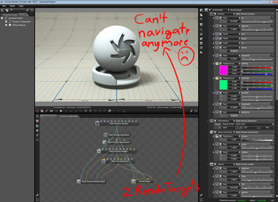

I have a problem with multiple render target nodes (but no crash
When I create a 2nd render target and click it then the I can't navigate and render any more. The image is frozen but the rest of Octane is working.
Refracty
Refracty

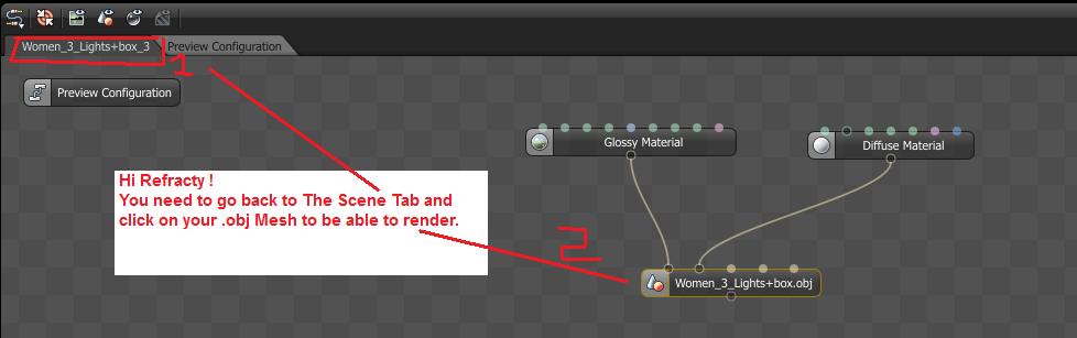

Refracty wrote :
"I have a problem with multiple render target nodes (but no crash ).
When I create a 2nd render target and click it then the I can't navigate and render any more. The image is frozen but the rest of Octane is working."
I have reported a very closed issue on my post on the first page of this thread, with the solution.
see the attached image here :
http://www.refractivesoftware.com/forum ... &mode=view
I have a different solution to your issue, explained bellow (seems to be a bug of the RenderTarget node) :

Thank you for the workaround. Yes it seems we are adressing the same issue.

Refracty, I think you did a mistake with your target node...Refracty wrote:I have a problem with multiple render target nodes (but no crash).
You plugged the kernel in the mesh pin.
Be careful when you create a new target, you have to plug an OBJ in the last pin.
Finally, You can't connect the mesh from your scene in preview tab.
I think you have to create all new targets in scene tab to achieve your network.
