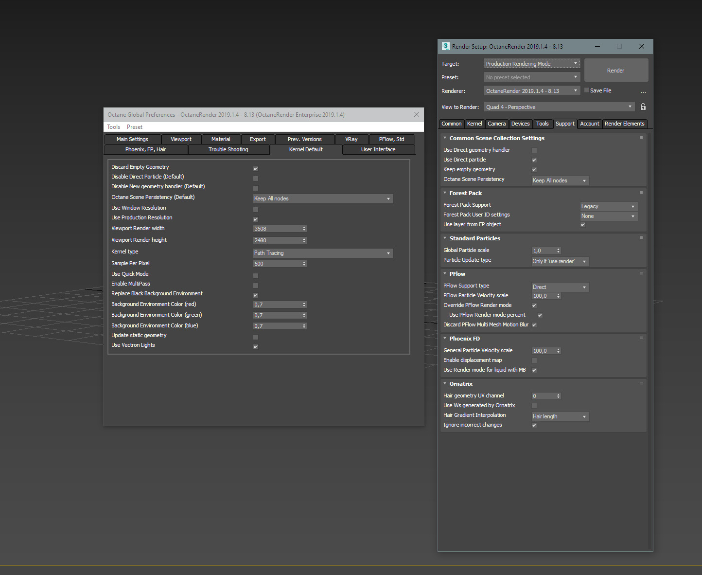

The FP render now. But there is a problem with the global settings.
I set it properly in Global Settings but when I load a scene it sets it back to "legacy" support.
This is bad because I batch render scenes regularly. So when I render a bunch of older scenes my forests won't render I guess.
Global Settings should overwrite a setting when I open an old scene because it is "global" and not scene dependent. It would require an additional checkbox like it is done in "Devices" with the "scene dependent" checkbox.

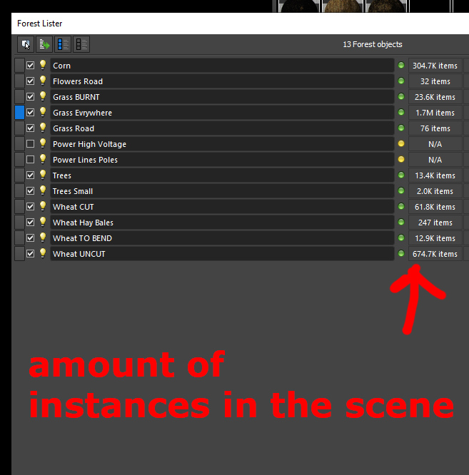

1 . it still takes 30 sec per frame to process static itoo objects like grass, trees. I sent Paride a sample scene a week ago with itoo objects and fly through camera.
in octane 4 you guys fixed it where it took only 1-2 seconds.
it looks like using lots of grass objects 1.7 mil creates slow processing time. But why? It should load all instances in vram once and dont process every frame. Plus cotane 4 had it fixed

you mentioned in this update "Fixed Forest pack unnecessary update on frame change."

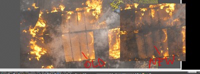

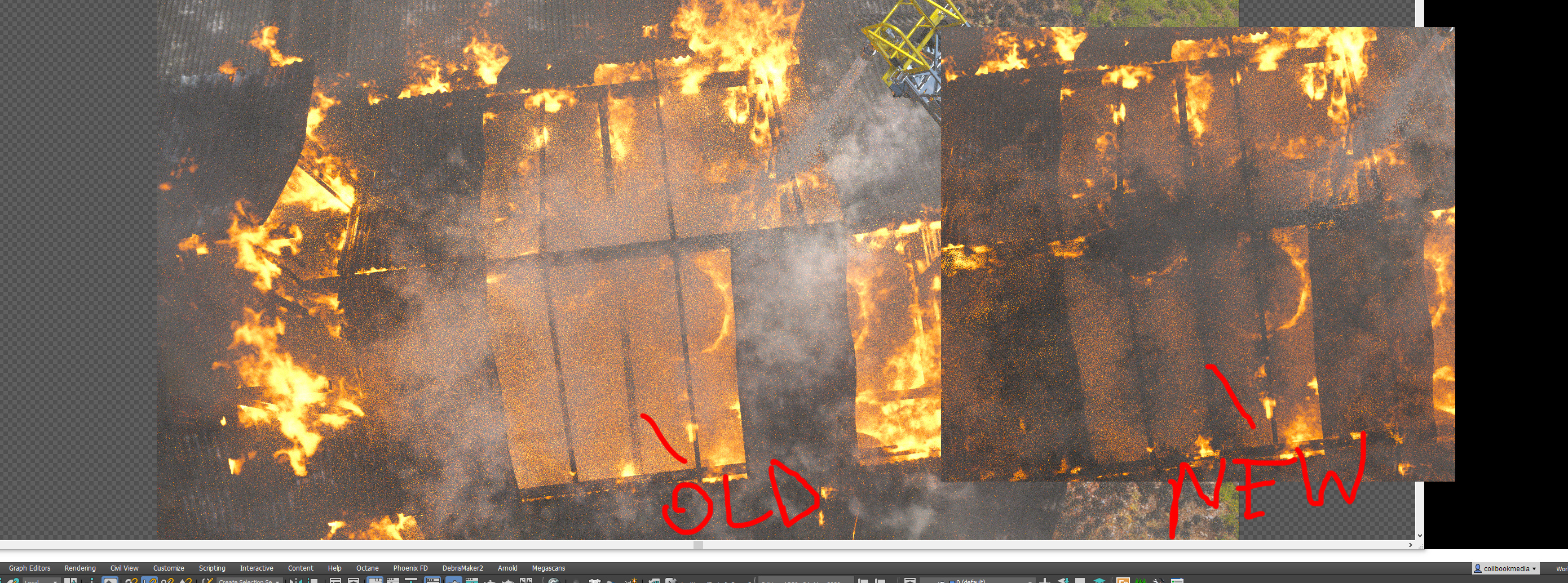

Thanks. Can you tell them to look at new volume behavior. It renders smoke very dark. Even after changing scatter scale and absorp scale. You basically loosing nice light scatter because scale has to be reduce so smoke wont be so dark
I noticed AO dist influences volume too much. If AO is set at 10 (good for large outdoors) volume is almost black even if absorption is set to pure white. Would be nice to have a checkbox where AO dist doesnt influence volumes

Hi coilbook,
didi you check "old volume behavior" option in Kernel panel?
