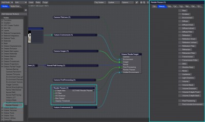

Hi Juanjo.
I´m rendering with render passes on
And when my render frame finish I can´t see my buffers in Render status windows anymore.
Can´t you tal me what I´m doing wrong?
Thanks alot
juanjgon
Posts: 8867
Location: Spain
Carlos3D wrote:Hi Juanjo.
Thanks alot
Are you talking about the LightWave image viewer? In this case, I'm afraid that the render passes preview is not supported on it. The passes only can be previewed in the IPR window or exported to file.
Thanks,
-Juanjo
