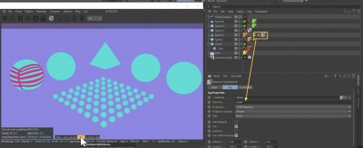

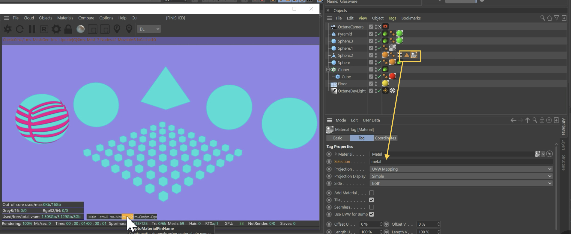

Posts: 10549
You can use the CryptoMaterialPinName pass.
it works with polygon material selections, so you can select a specific material of an object with multiple polygon selections and materials assigned:
ciao Beppe
