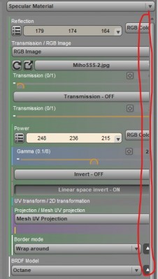

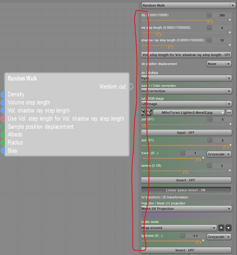

2. In the NGE sometimes the right edge in the values panel is truncated and there is no way to resize it. Update : I am seeing the truncation in the material node - Diffuse / Specular etc and some other nodes. But for other nodes the values and controls are being shown in full e.g. Color Correction node.
For the Random Walk node, after clicking the Use Vol Step. for Vol Shadow ray step length toggle button, the left side is truncated and sometimes it is the right that is truncated if you click out and click the Random Walk node again. Anyway, main thing is there is a width issue that you will need to fix or make the panel values part resizable.
