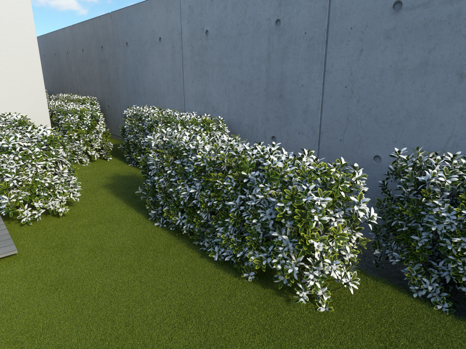

Hi Guys,
there is something funny going on (or the way it works has changed) for Universal Materials using Transmission and Specular in Octane 2019.1 and 2019.2.
Basically specular surfaces render like they have a very high IOR if the "Transmission Model is set for 'Octane', Beckman' or 'GGX'. It renders as expected however when the transmission model is 'Lambertian'.
Same issues for all Kernels.
Cheers, Dan.

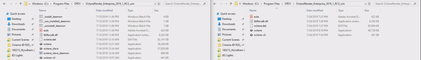

No files to run daemon?
UPDATE: The install exe has all the files, the ZIP does not.

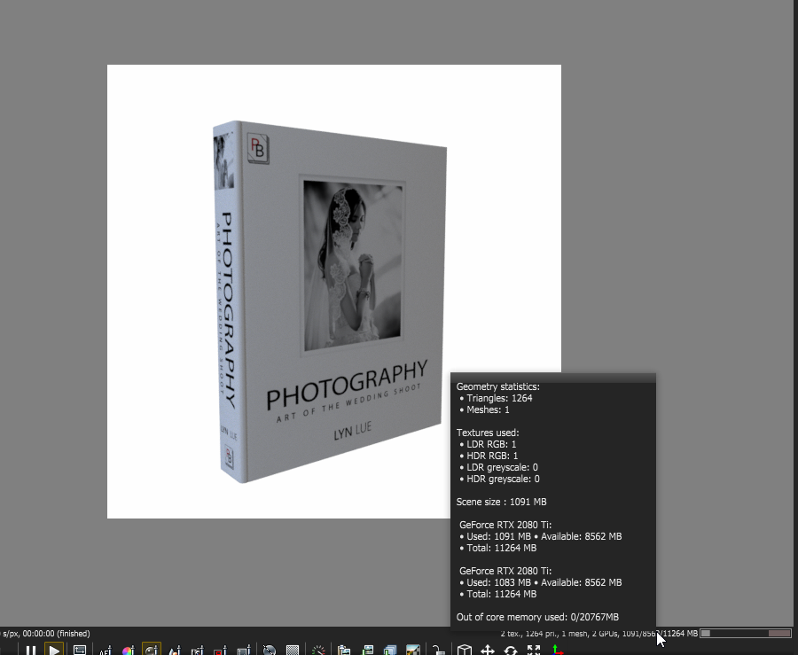

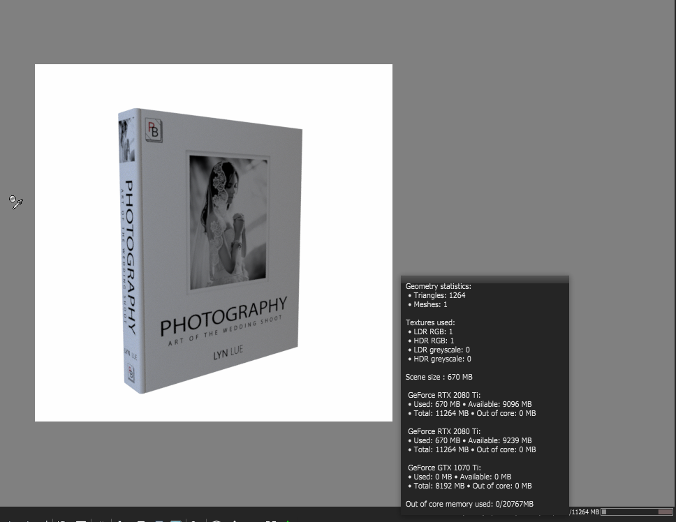

it appears that octane 2019 uses much more vram compare to 4.02 for the same scene.
here's a screenshot

Check your Parallel and Max tile samples. The higher the values the more RAM they take.

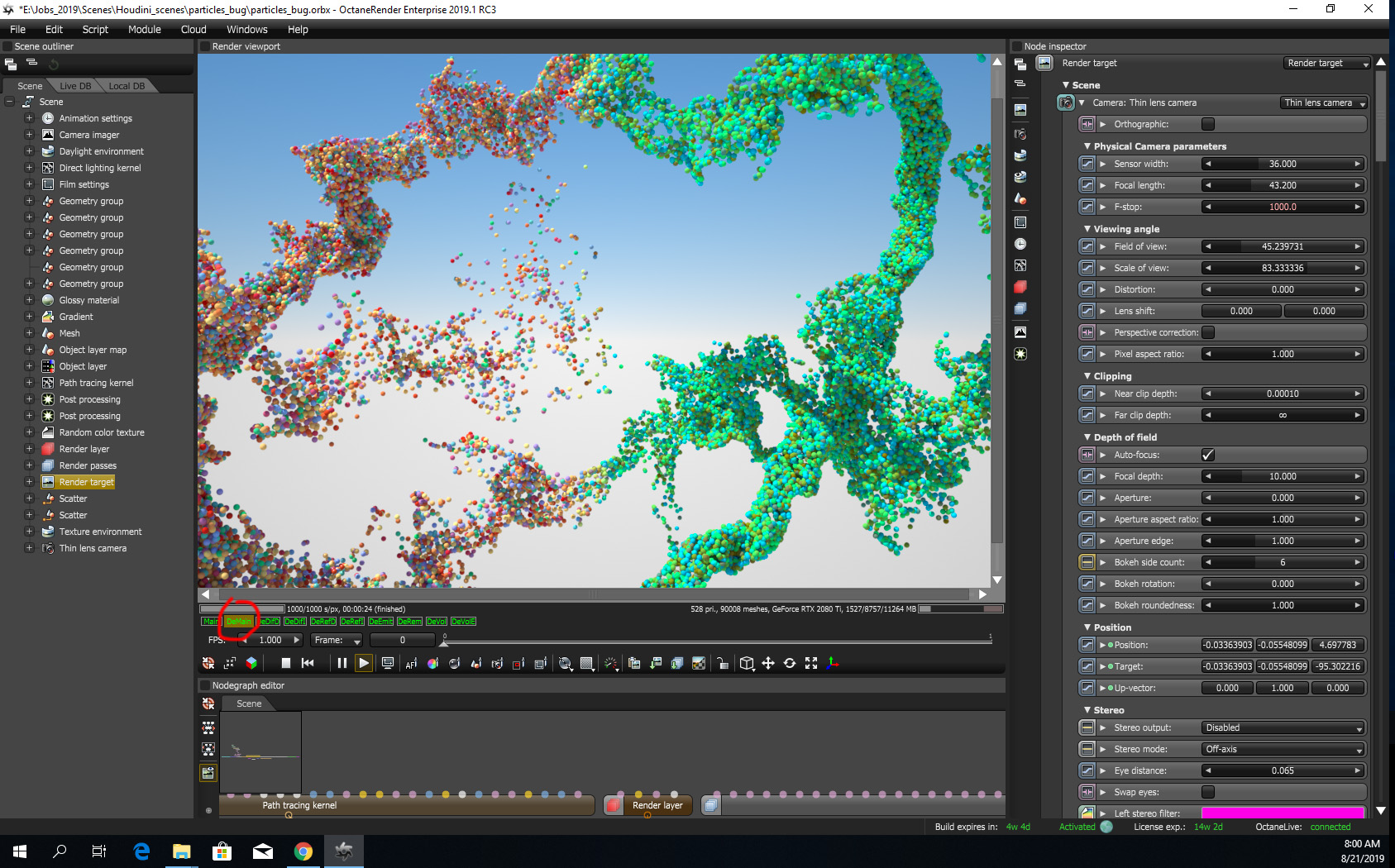

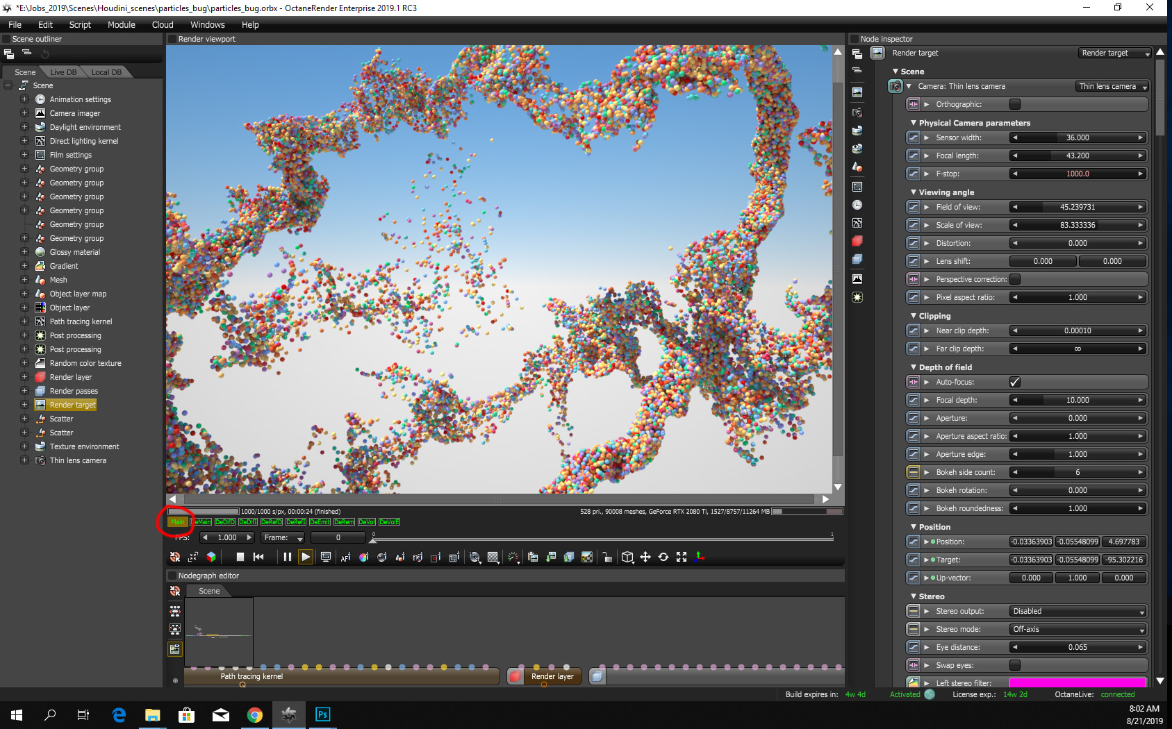

I have made a particle simulation in Houdini, and I found a bug. When the denoiser pass finishes, It gets very odd. I am attaching two images to show the problems, and the orbx file.
Thanks,
Saulo
