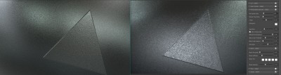

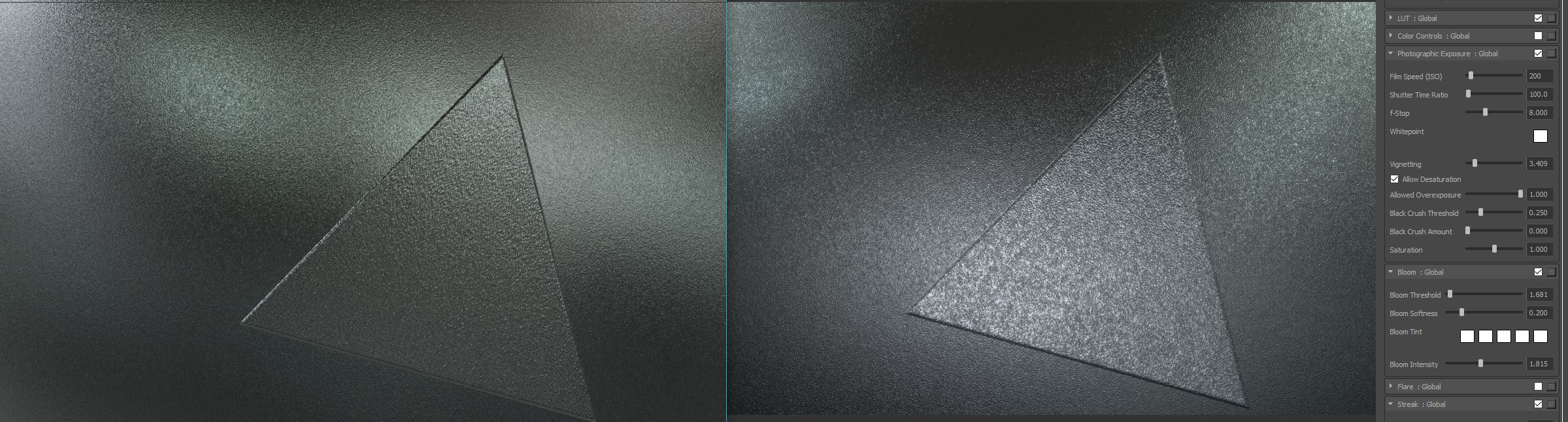

When working on small scale objects with really fine bump maps Octane loses detail after scaling down past .1 in transforms. Here is a comparison between octane and redshift. I asked about this earlier and it was just ignored.
Could I please have an ORBX of this scene, so that I can be sure I'm understanding what scale exactly we're talking about?sethRichardson wrote:This has been a problem since well forever. Can we please get this fixed.

Hey Seth,sethRichardson wrote:This has been a problem since well forever. Can we please get this fixed.
I've noticed a similar thing too.
Question for you if you dont mind, is this happening only if you use the transform "commands" or is it happening when having scaling the UV mapping really low too?

If you leave the transform node at 1 and just tile the UV you dont get this issue.nejck wrote:Hey Seth,sethRichardson wrote:This has been a problem since well forever. Can we please get this fixed.
It is only when you say need to use a triplanar mapping and have to lower the transforms in the octane node itself.

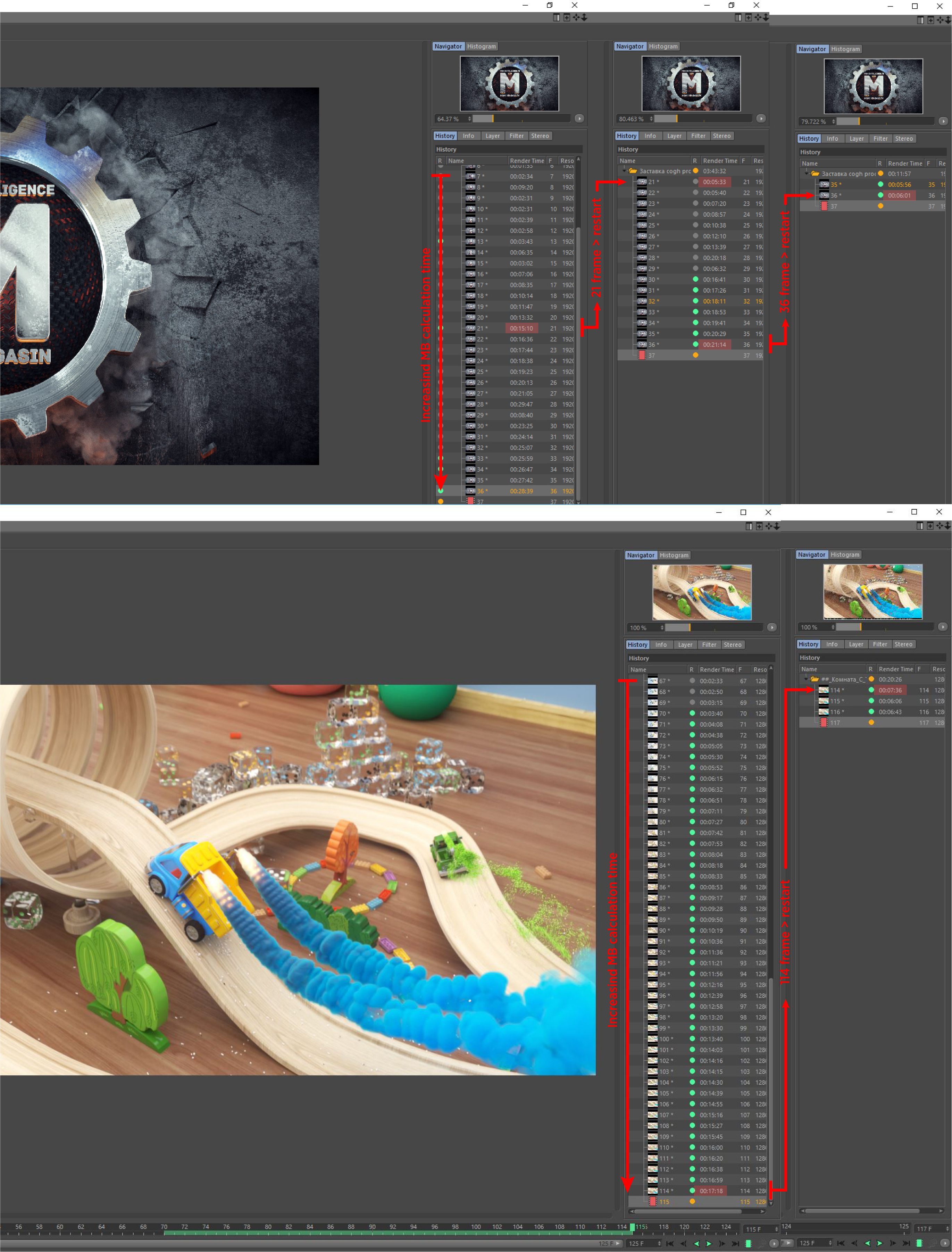

I'm use Cinema4d. When motion blur is turned on in the scene and there are many particles (hundreds of thousands) the time to calculate motion blur increases frame by frame and can reach huge values in a few hours per frame. BUT! If i restart the render and start from the same frame, the render time is reduced to a few minutes. Because of this, it is absolutely impossible to render projects with a huge number of particles. This error is repeated on any scenes, on any computers. I can’t check this bug in standalone, because it is impossible to export particles from Cinema4d to Stand., but I believe that this problem is related to the core.
Briefly: the same frames with a huge number of particles and turned on MB can be rendered for 5 minutes and for 2 hours.
