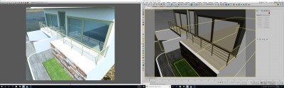

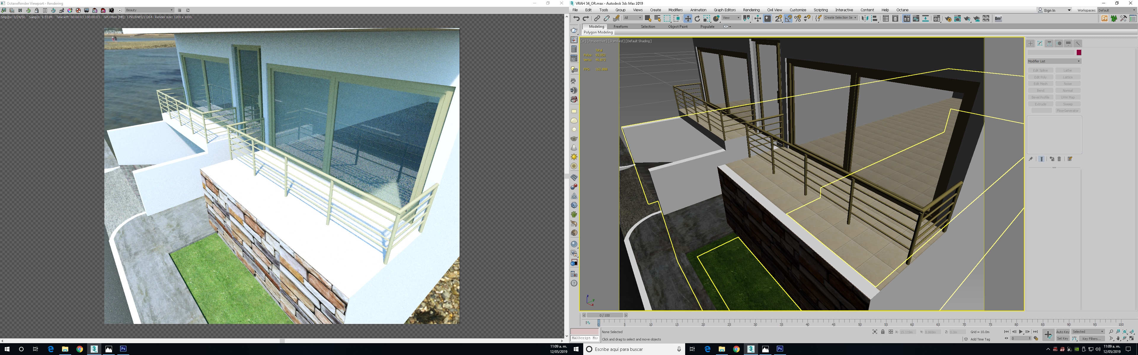

merid888
error with the version 6.17. i see the map in the view of 3ds max but i can't see into octanerender viewport
someone can help me ?
thank you octanrender team
error version 6.17
error version 6.17

Hi merid888,
it's difficult to say off the top of my head.
could you share that material making a 3dsmax archive?
Regards
Paride

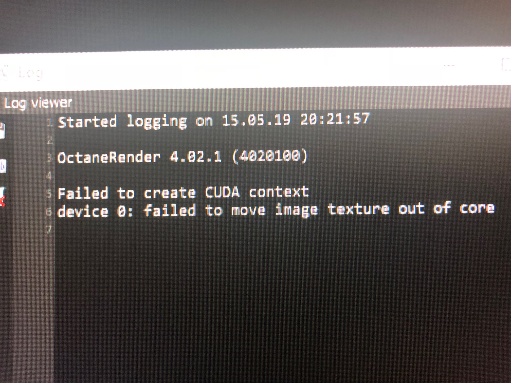

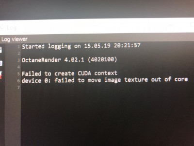

coilbook
Posts: 3171
Hi Paride,
what does this error mean?
Camera 1 rendered sequence fine this is another camera angle and after rendering frame 1, octane processes frame to and then render fails right before frame two is about to render.
out of core is not unloading properly?
UPDATE: restart fixed it but I noticed if a frame one uses almost all of the vram and frame two needs to use out of core because phoenix is added or a larger animated texture, octane crashes with no memory error instead of using CPU ram. Hopefully they can fix it.
