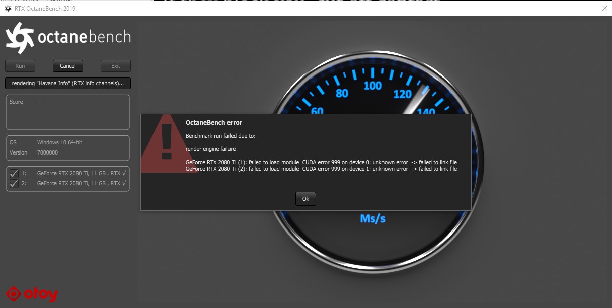

Any idea why I might get the following render engine failure.
mojave
Posts: 1422
Joined: Sun Feb 08, 2015 10:35 pm
m1jackson wrote:Any idea why I might get the following render engine failure.
Are you meeting the driver requirements in the initial post notes?

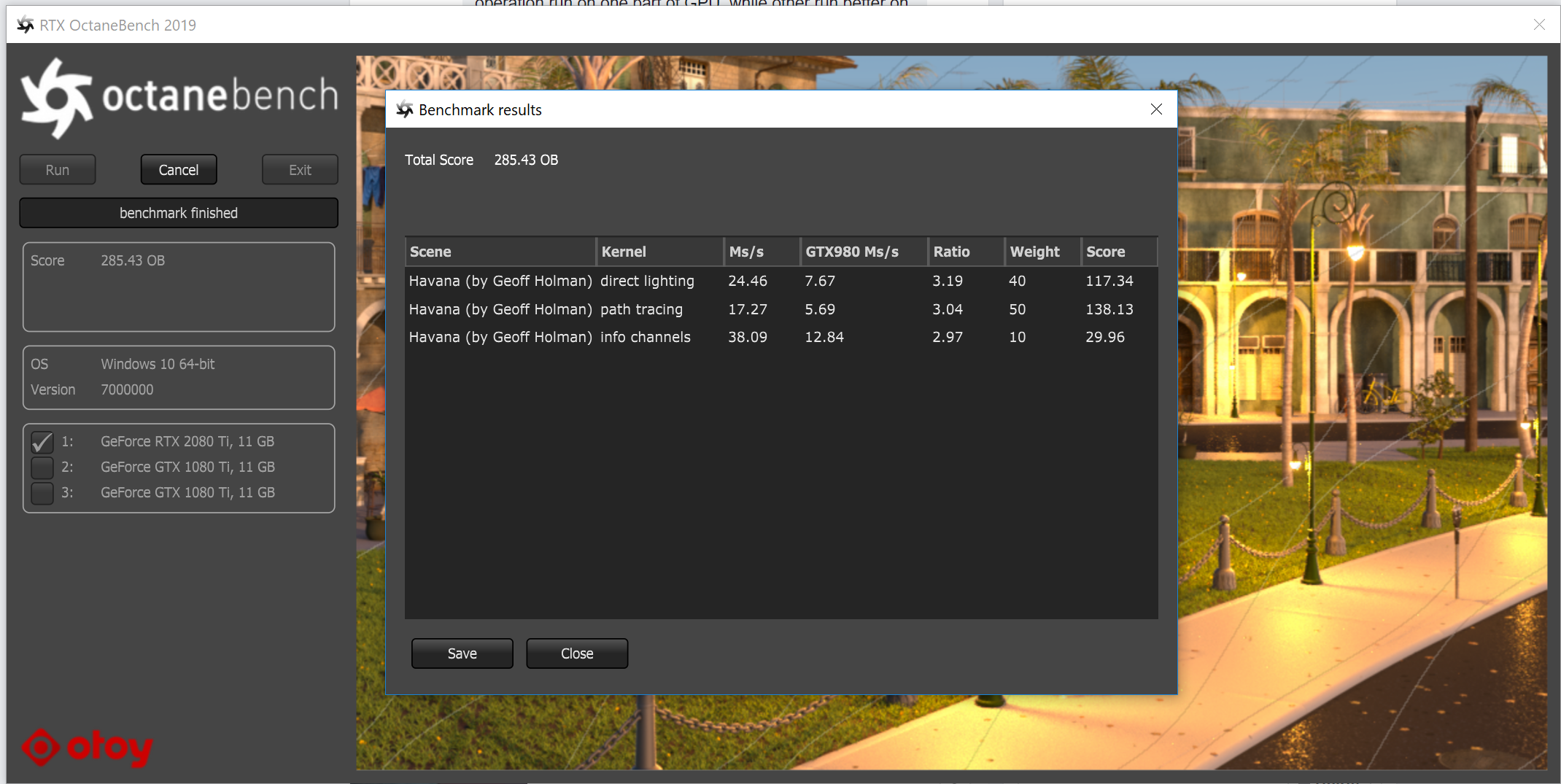

Hey Guys!
Te benchmark is not working for me for any reason. I have the 417.17 Drivers, and one RTX, but the feature dont appear in benchmark.
Any thoughts? Thanks!
