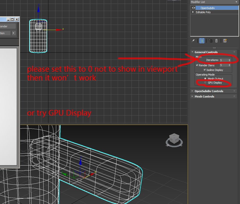

paride4331 wrote:
coilbook wrote:does octane support opensubdiv? It seems that it is not working right. When I set it to GU display or Render Iter to see the result during rendering nothing happens. It only works when dense mesh is displayed in a viewport
It seems that turbosmooth is not working either when smooth during rendering is checked. It used to work for sure in octane 3
I tried scanline renderer and it works great with render iters only or GPU display
Hi coilbook,
it seems to work.
Regards
Paride
hi paride,
please set viewport iterations to 0 and just leave render iterations then it won't work. The same happens with turbosmooth but it used to work. I only need iterations to work during rendering so it won't make viewport slow.

paride4331
Posts: 4000
coilbook wrote:
Hi coilbook,
it seems to work.
Regards
Paride
hi paride,
Hi coilbook,
I honestly do not know about option difference, developers will think about it.
Regards
Paride

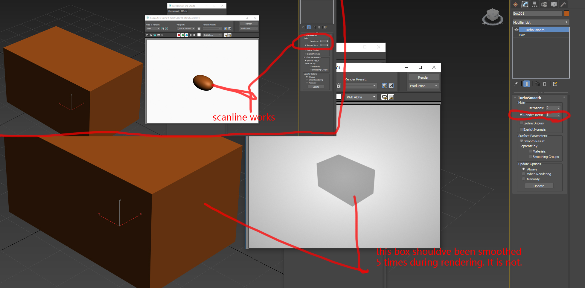

coilbook
Posts: 3176
Hi Paride,
I attached the scene with turbosmooth. It is not about GPU or mesh method. Render iters doesn't work during rendering. For instance, scanline renderer smooths mesh during rendering, octane doesn't
turbosmooth.zip
(35.53 KiB) Downloaded 267 times
