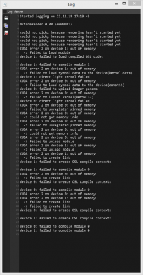

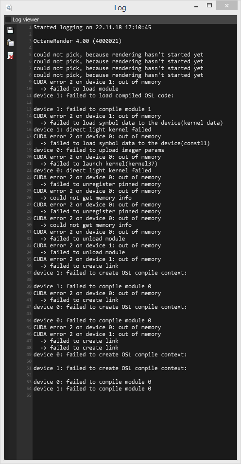

Out of core enabled, and i even increased it to 12gb. Info panel at post above says, 1.7gb out of core usingtim_grove wrote:Cheiser wrote:Cant figure out how to make octane work with heavy scenes. For test i created a scene with a couple of highpoly models, 30m polys in my scene.
And octane keep crashing with a message "Try to decrease polygon counts". How should i work with heavy scenes, if octane cant handle 30m polygons?
GTX1070+1080 (8gb VRAM), 40gb RAM.
I want to use octane render, but i cant do any heavy scenes with it. I know, i should optimize my scene, use proxies etc. But im working with a team and often i have a bunch of locations done in 3dsmax. Octane cant handle it, always random crashing. I am forced to use another GPU render in this case. Any tips? What should i do, to make octane work with heavy scenes? Looks like my VRAM run out of memory, but why octane do not use my RAM? It's only 1,7-2gb.

30m polys. Loaded scene ok. Can move around. Even can create HDR light.Cheiser wrote:Cant figure out how to make octane work with heavy scenes. For test i created a scene with a couple of highpoly models, 30m polys in my scene.
But when i choose to create a new Octane material - LiveViewer stops. And if you try to refresh it, when octane Render Failure. Latest Nvidia drivers. Tested on my PC and my friends PC. I am using 8.1, my friend uses 10

No one can help me?lucioing wrote:When I say: Ahmet the great, I'm right!

I'm having the same problem as Cheiser. Frequent crashes (red Render Failure errors) when the live viewer is running and I try to work on the materials. Log says out of memory.
The scenes don't even have to be big (1M polys).
I followed GIOLETS' suggestion, changing the TDR parameters (viewtopic.php?f=30&t=69304). It helped, but out of memory render failures still occur, just not as often. VRAM is not full, as visible in live viewer. Out of core is enabled.
Any ideas?

Did you read and apply notes in first page? I cannot help if you don't give enough information.Hatsize7 wrote:I'm having the same problem as Cheiser. Frequent crashes (red Render Failure errors) when the live viewer is running and I try to work on the materials. Log says out of memory.
Any ideas?
I'm running Win7 (I know, I know, will change it soon) R16 with 3x Gtx1080s and 32Gb RAM.

Could you test it without using monitor connected gpu? It's most likely a problem between opengl drivers and cuda.Cheiser wrote: 30m polys. Loaded scene ok. Can move around. Even can create HDR light.
