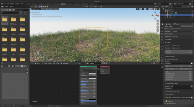

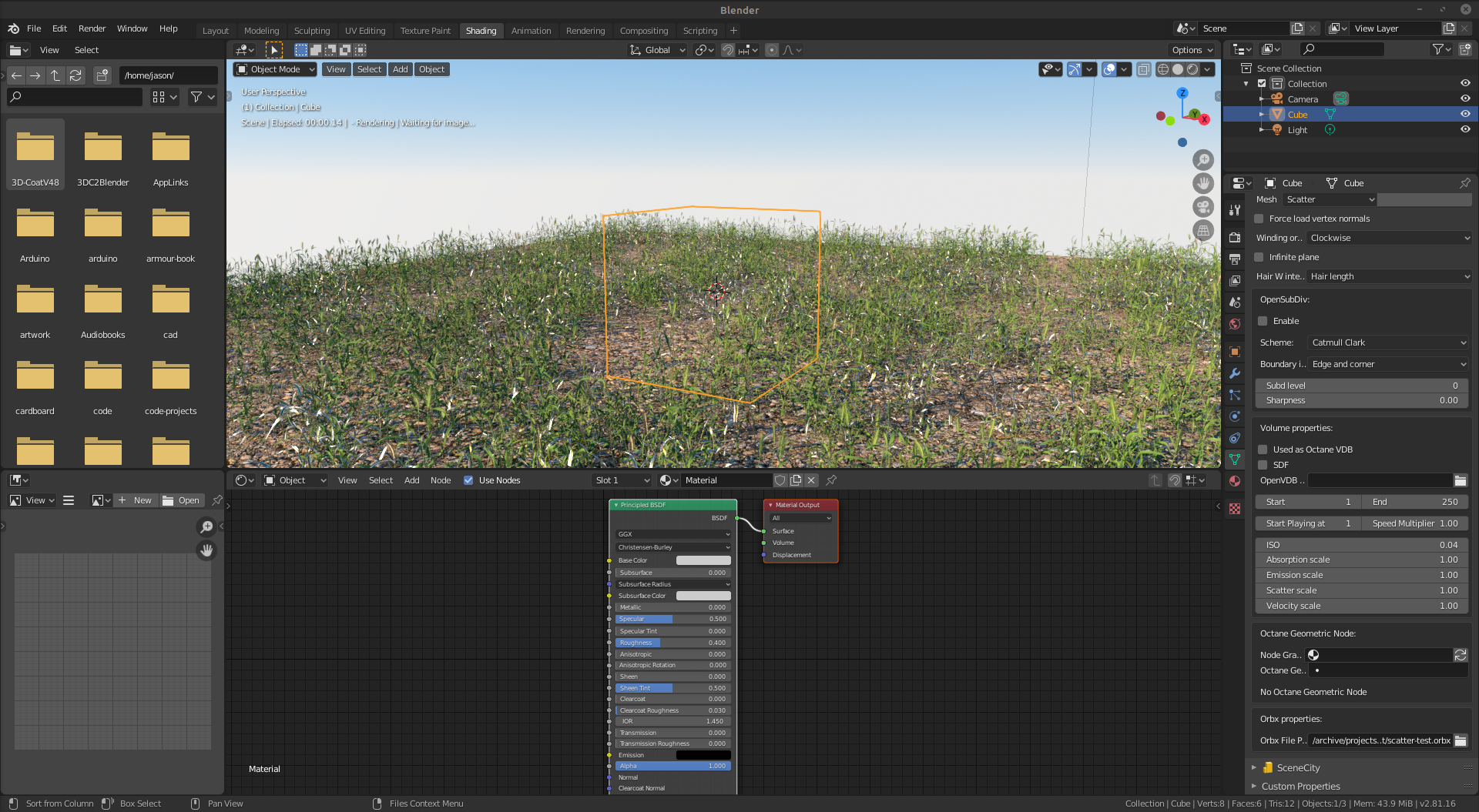

It works strangely, almost like it's a proxy object. To test I started with the default cube in Blender. I selected the cube and then went to it's Object Data Properties panel. Under the "Orbx properties" I just loaded in a ORBX file, in this case it is a plane with particle system that I had exported to standalone. As you can see the cube is still selected and the overlay outline is still visible, but when you render it will render the plane instead.

That's an awesome use, thanks for sharing Grimm.

ORBX does export the whole scene, but in this case I think that the camera is being ignored. You will need to test to make sure, but as you can see, the objects and textures are preserved.

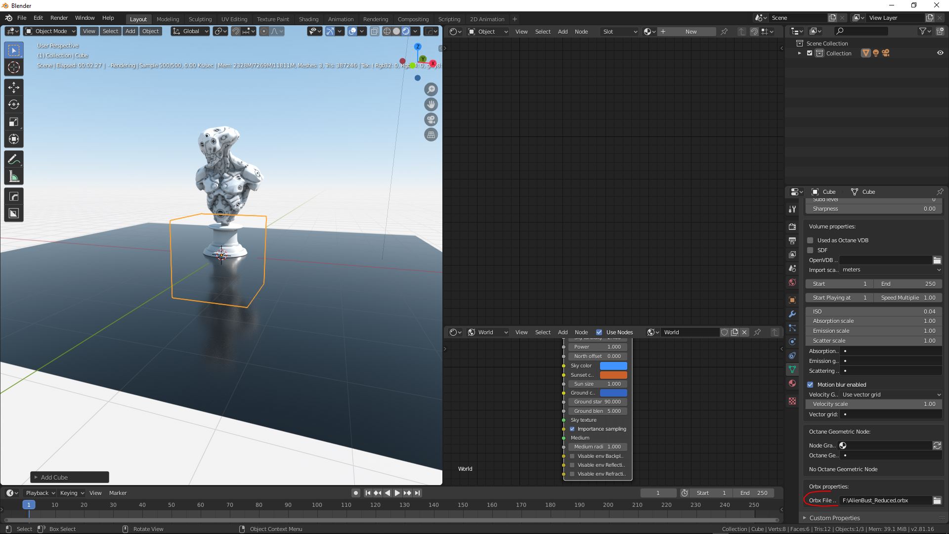

pegot wrote:How does the ORBX import feature work? I exported an ORBX from Stand Alone. In Blender Octane, I then access the default cube's Data property and set file path to the ORBX I exported from Stand Alone. But nothing happens. The scene does not load. And nothing renders.DrawFun wrote:About the orbx import feature, it is also available for OctaneBlender now. You can find it in "Properties-Data-Orbx properties-Orbx File Path" in OctaneBlender after 17.4.
Works fine here. Which version are you using? Can we see a render of the ORBX in Standalone? Thanks!
