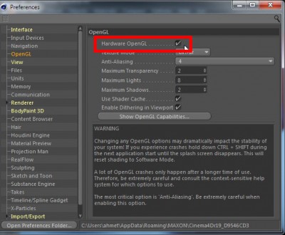

Are you using "software opengl"?
Where I can find it? But I think not...
