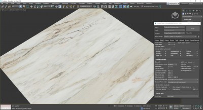

However, It doesn't work with the standard texture slot. Why is this an issue? The standard texture slot is the only one which displays correctly in the Max viewport. The Octane materials and maps still look to be capped at very low resolution, perhaps 512x512, in the viewport. This makes working difficult.
This is one aspect of the overall poor quality/compatibility of Octane materials and lights in the Max viewport.
Would it be possible to make compression compatible with the standard texture slot, or to fix the viewport display of Octane maps such as RGB Image?

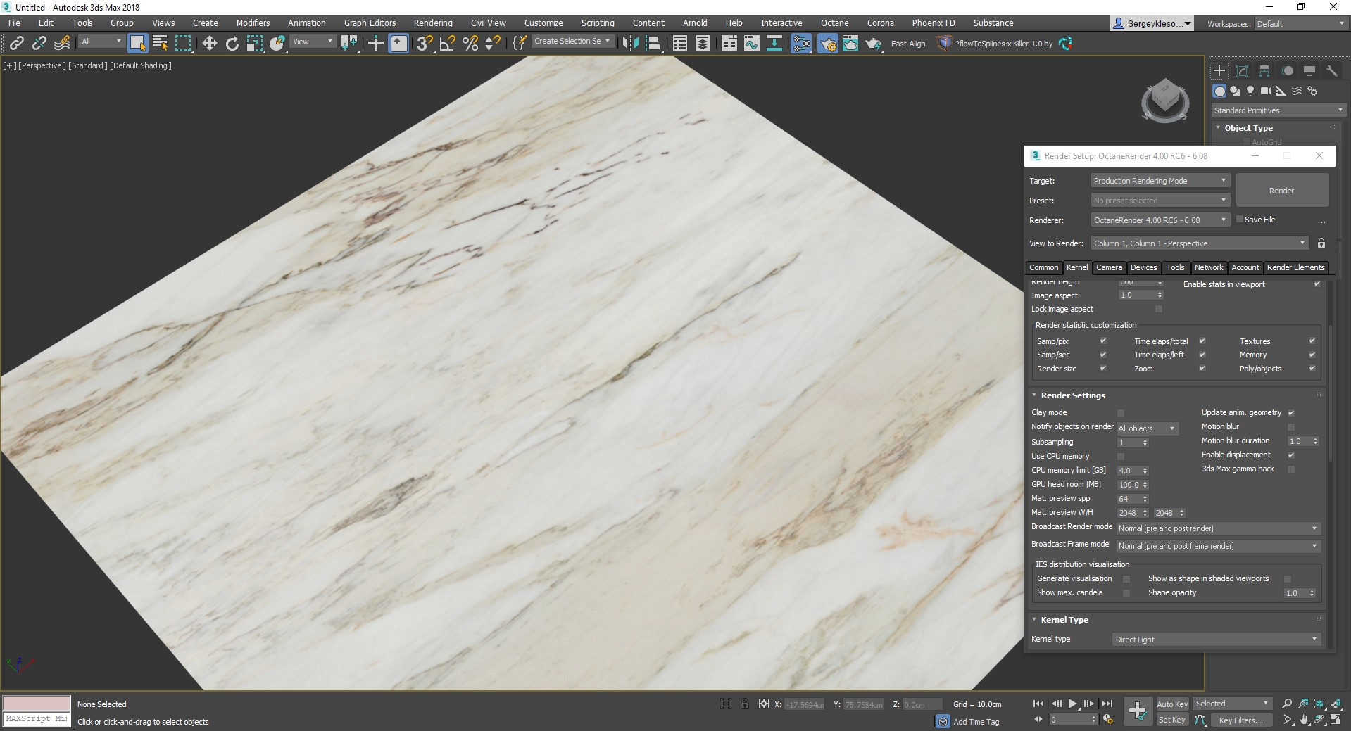

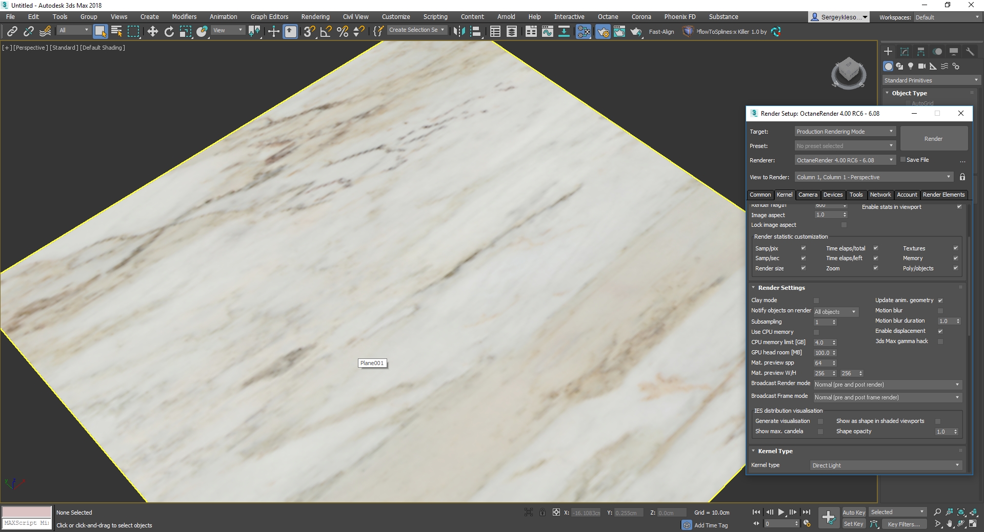

You can adjust texture preview resolution in the Kernel tab - Mat. preview W/H (See attachment). But I don't know how it affects performance, I think Paride can give as an answer about that

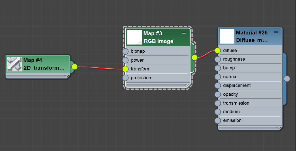

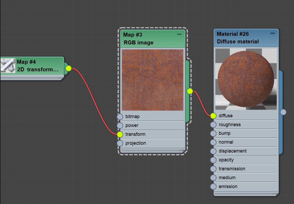

Also found a new bug: material preview looks like standard grey ball on floor but with diffuse texture in screen mode on top of it, and RGB Image preview looks like blown out completely white texture. And it keeps look like this until I open a large preview of that material
Hi SergKlyosov,
yes I found it too, I sent it to developers.
Cliccking on prews square and opening prews sphere, edit color or textures, everything falls into line.

[quote="senorpablo"]Texture compression is a great!
Hi senorpablo,
you can set Mat. preview W/H until 4092x4092 in Kernel panel; to update you have to click on "show shaded material in viewport".
Regards
