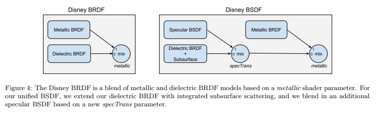

I understand that, but i'm saying : in your implementation the layers are in the "wrong" order, the diffuse reflection layer should not be above the specular transmission layer but below:
Please check again how Disney has extended its principled BRDF to a BSDF :
https://blog.selfshadow.com/publication ... _notes.pdf
And for example a correct implementation of this in Houdini Mantra:
http://www.sidefx.com/docs/houdini/node ... hader.html

First of all, disney BSDF model is not a 100% de facto standard.
Secondly, it does not really specify which layer is at the bottom or above like we do. It says exactly on your picture that it's a mix between specular BSDF and diffuse BSDF with a specular transmission parameter interpolating.
This means they are doing an equivalent of mix material between specular BSDF and diffuse BSDF.
On the other hand, here we are explicitly specifying that all transmission layers will be below reflection layers, because they only fall below transmission layers if they are not reflected. There is really no 100% correct way and incorrect way in implementing a union of BSDFs, which is basically what the uber material/universal material is.
This approach is necessary because our transmission will not only specify specular transmission, but also diffuse transmission (this is coming like you have wanted, with a toggle switching between modes), so the equivalent subtraction to get your material transmission makes perfect sense and consistent for both cases. Let's say if you have a rough specular transmission below your diffuse reflection, you should get approximately similar results as you would do with diffuse transmission and diffuse reflection, because the similar amount of radiance gets through into the material in both cases, if they are not reflected outwards in the diffuse layer.

Ok but do you know any other renderer doing this the same way as in the universal material ?
All production renderers have Ubermaterials and to my knowledge none of them have implmented the diffuse Albedo as a a layer above transmission, there must be a reason...
Anyway my main concern is about usability, Ubershaders are often used in production to have one material for one object even if the object have several different sub-material part, so there must be a simple way in the material itself (so only one texture in one parameter) to have a glass part and a red plastic part for example.
So in the universal material, instead of only plugin a mask in transmition I also need to plug in the albedo the inversed mask multiplied with the diffuse color ... far from production friendly ....
If I insist on this point this is because we are next to the official release and I'm afraid after that the universal material implementation will never change for compatibility reason, so this was the time to tell my doubts.

OK, I think you have a point in masking. How about this?
Basically I can extend the universal material later by adding a "Transmissiveness" / "Transmission Map" (or some other name) to it after stable, if it is specified, then it would use the mask value to determine the degree of transmission (the disney way), if not then it would use the current way (the transmitted energy is those that is not reflected off in upper layers).
