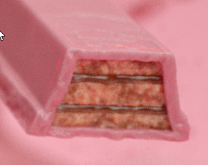

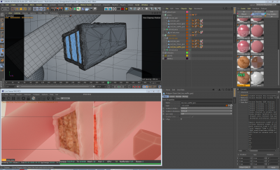

Hi, i have this SSS issue which i ve seen in other scenes as well in the past but never mentioned it. See image below these red bright dots/artifacts. What might that be? Geometry is not intersecting but even if did it shouldnt be like this. Do u need a scene for that? ty
CINEMA 4D_2018-10-09_16-26-16.png (180.62 KiB) Viewed 4628 times
Posts: 16068
Location: Türkiye
thanulee wrote:Hi, i have this SSS issue which i ve seen in other scenes as well in the past but never mentioned it. See image below these red bright dots/artifacts. What might that be? Geometry is not intersecting but even if did it shouldnt be like this. Do u need a scene for that? ty
It's not a plugin issue so send me an ORBX file if you can do or C4D file.

Hi thanulee,
I had a look at your scene.
The issue comes from how the specular meshes are modelled, since all the three meshes are opened, the light come out and create the unwanted effects.
Here is what happen if you close all the surfaces:
sss issue_b.7z
(1.13 MiB) Downloaded 385 times
ciao Beppe
thanulee
Posts: 712
Joined: Sat Dec 19, 2015 11:00 pm
Thanks alot! So i have to have always closed meshes and even if they intersect is all good?
