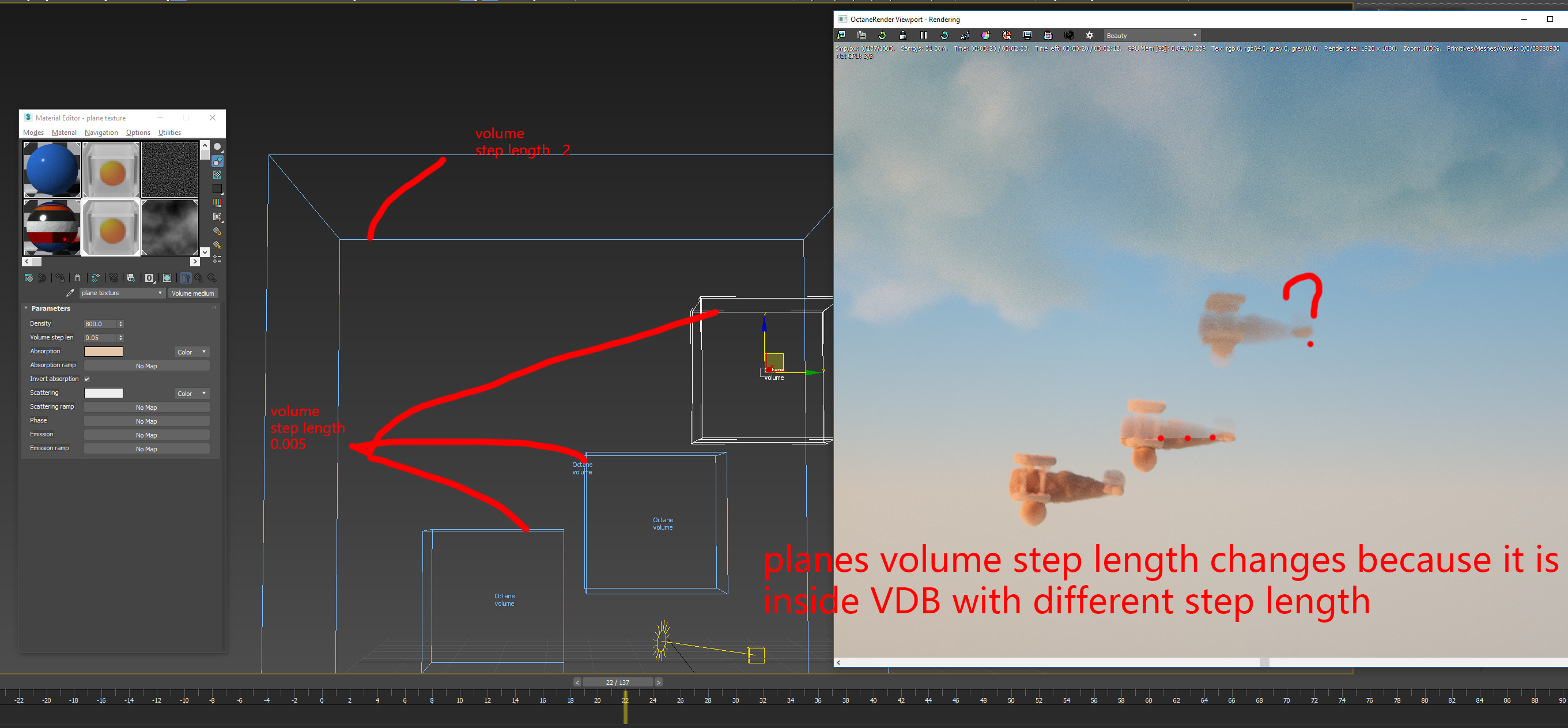

we have a VDB plane flying inside a VDB cloud. Plane's step length is lower to give it more details. But when a plane goes inside VDB cloud it changes step length from 0.05 to 2
Can otoy make it where different step length vdb can exist in one space? Thanks
If nothing can be done any way to create a texture like this for a mesh?
Here they talk about adding volume inside the mesh viewtopic.php?f=9&t=26161&hilit=Volumet ... r&start=30

coilbook wrote:Hi Paride,
We will look into it.
