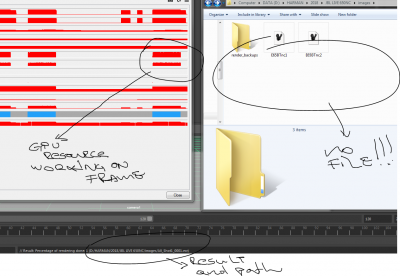

Also found out that motion blur is not consistent and not working stable with meshes that are deforming in some way (wire deformer, joints, etc..), and also rendering out image sequence seems that it is failing. No images get written to disk.
This is far away from "stable" version, it would be fair to mark it as "in development" or something.
*** UPDATE
This version needs a Passes node created in render settings in order to save the file if you have "Save composite EXR" checked. Otherwise uncheck that. By doing this batch renderer is saving the files. Thanks Andre Pascal for clarifying this.
