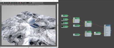

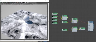

I did test again, to double check that displacement behavior is not related to specific scene
I created simple UDIM plane and sphere. As you can see "Image tile" texture works correctly in the diffuse map slot of the material, but same map doesn't affect displacement at all
So I can confirm that displacement is not working with UDIM
Any comments and suggestions from OTOY?
Cheers

SergKlyosov wrote:Hi Octane Team,
My previous message stays without answer
Cheers
Yes, image tile textures are not supported for displacement. For now the only way around it would be to bake the tile texture into a single image texture using the baking texture node.

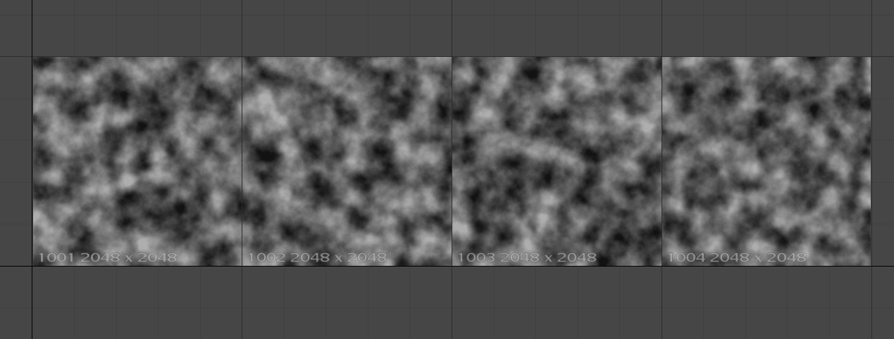

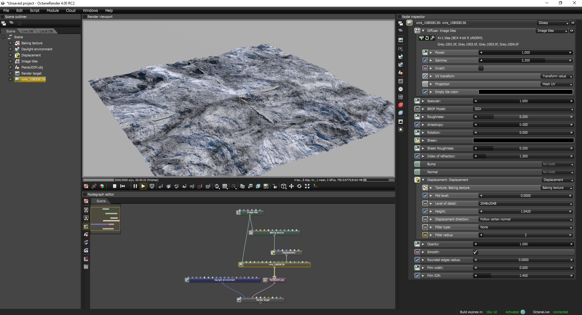

abstrax wrote: Yes, image tile textures are not supported for displacement. For now the only way around it would be to bake the tile texture into a single image texture using the baking texture node.
Hi abstrax,
Thank you for the reply, using baking node - displacement working now, but it has a bug with torn edges
I've attached screenshots. The texture is seamless across 4 udims, as you can see on render where only simple diffuse texture is used
But when the same seamless texture is applied to the displacement slot - It is creating torn edges in border areas.
Can it be fixed in a next release? Not working displacement it is a huge limitation at the moment and almost kills whole purpose of using UDIM in actual projects
Cheers
