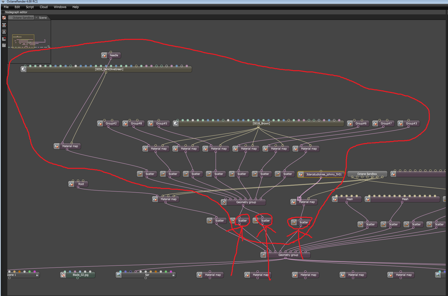

Looking into this. Layout persistence and not deleting floating nodes will be easy to fix and should be in the next build. (Discarding floating nodes was a mistake on my part, sorry; I originally put it in as a temporary workaround for another bug that was keeping nodes around from the old scene when a new one was loaded, then forgot to take it out after that was fixed.)johlanga wrote:Cap, when connecting proxies to obj .ocs/ .orbx/ .obj/ can you make the plug-in connect it to its own node graph (see pics below).
And please make it remember the layout/settingand please don't auto-delete floating nodes!
ocs are often complex, and this would make the "Nodegraph editor" chaos a little less annoying.
