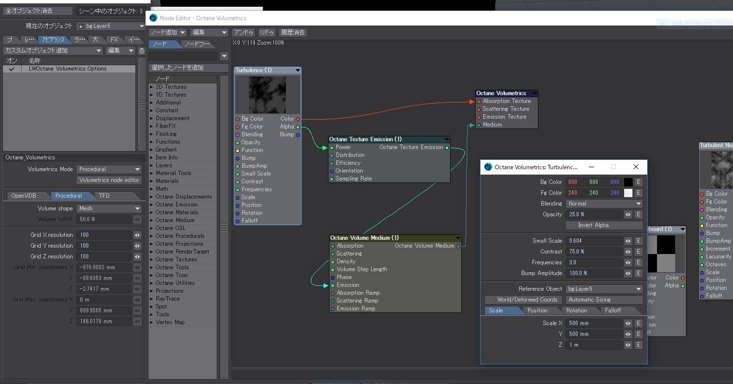

A volumetric node may produce wrong result. I think this may be bug.
It looks like a 3DTexture being connected to Volumetric's absorption may get be something wrong or broken.
Once booted LW up, a texture image seems to be correct but saving the scene by 'S' or reloading the IPR then Volumetric-node goes wrong result.
3.08.1.0 with Lightwave2018.0.4 (windows10)
This reproduced in the stable version of the plugin with LW2014.0.4
Volumetrics of the plugin is the coolest feature for me.
Hope this help.
Hope this help.
Hmm, this setup for a volumetric shader makes no sense. The texture emission node "power" input is not texturable, especially using an LW noise node (that is not compatible with the Octane nodes), so this link to the turbulence node "alpha" output has an undefined, probably random behavior.
Thanks,
-juanjo
Thanks,
-juanjo

Oh, this was completely suitable for me before saving the scene(since an absorption shall get incomming light darker).juanjgon wrote:Hmm, this setup for a volumetric shader makes no sense. The texture emission node "power" input is not texturable, especially using an LW noise node
How do I make volume emission texturable and be well-defined?
