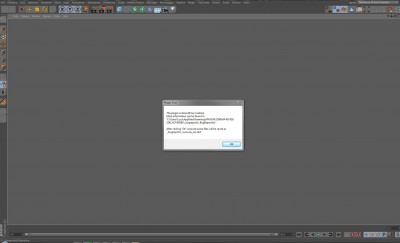

I have a problem with this release.
CINEMA 4D has stopped working - message when trying to load C4D. I've updated my nvidia driver 391.01, C4D R18.057, only have R18 in the c4doctane folder, C4D not blocked in firewall.
If I remove this version and put previous ( 3.07 R2 ) on plugins folder, C4D loads and all good.

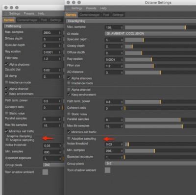

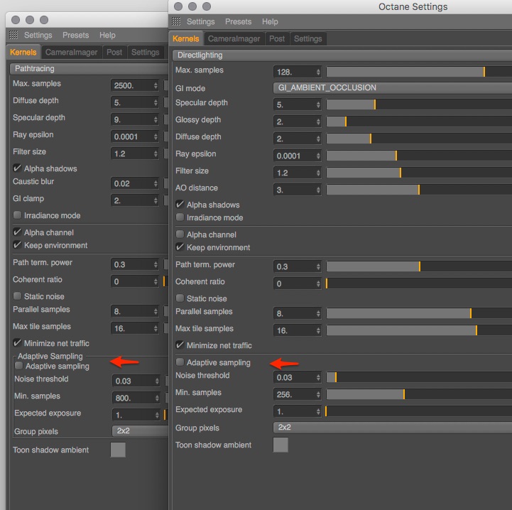

Hi Ahmet,
Minor discrepancy in the Settings layout between path tracing and direct lighting.
OSX 10.12.4 | Intel 12 core @ 3.33 ghz | 128 gb ram | NVIDIA GeForce GTX 1080TI | Ubuntu Linux slave with 3x 1080ti
Posts: 16068
Location: Türkiye
niestudio wrote:Hi Ahmet,
Thanks I'll revise this

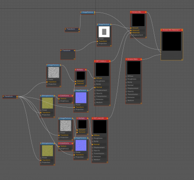

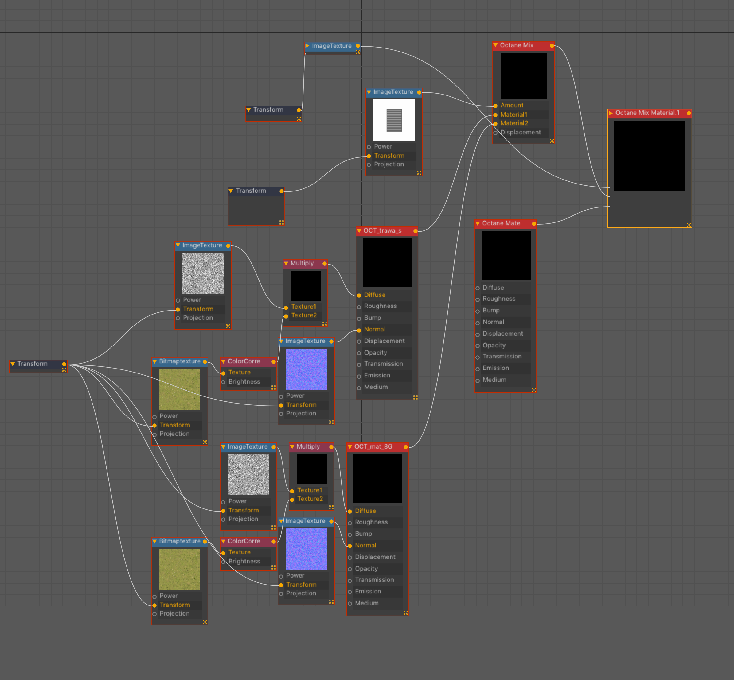

When using Mac in the node-editor some icons stay black. ( Mix-Materials and multiply nodes so far).
Any way to get around this ?

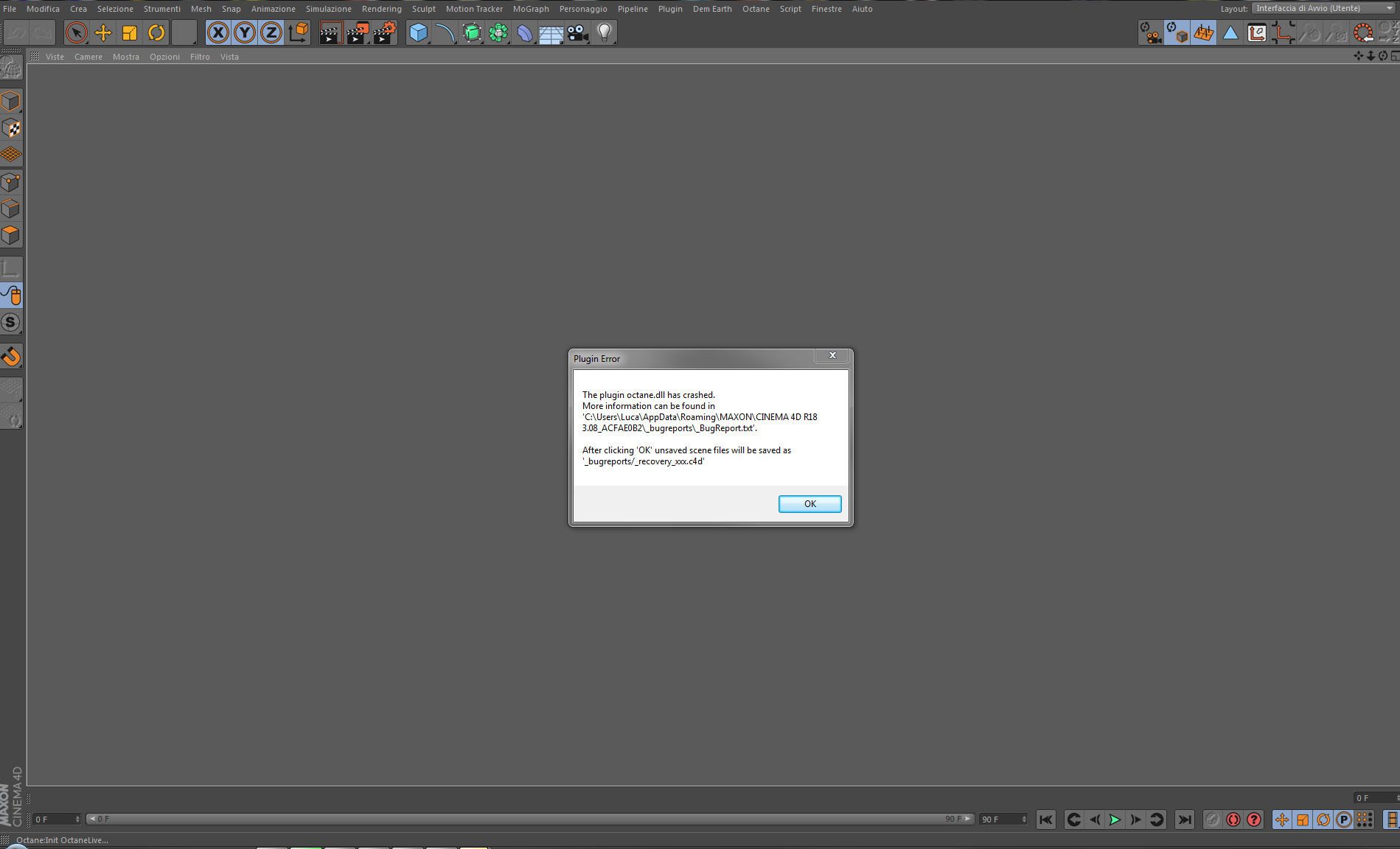

I wish to share with other users the right NVIDIA driver version that works with this update.
I've tried this combinations: in all cases I've performed a clean uninstall of the previous drivers in safe-mode using DDU
Octane update: 3.08 stable
Cinema R18.057
Windows 7 - 3 x GTX 1080ti
Driver version: 391.24 or 391.35
Octane standalone: works perfectly
Octane Cinema 4d plugin: crash at startup
_BugReport.txt
(161.66 KiB) Downloaded 332 times
switching back to 3.08 test 6 and 378.78 return to works good.
Anyone could share its configuration/drivers combination please?
UPDATE:
I've report here a solution that in my case work:
1) after trying 391.24 and 391.35 I've switched back to 378.78 and as I wrote all works again.
2) I've tried then to install 390.65 and I have started C4d without crash, then I've tried to install most recent updates
3) 390.77 all ok
4) 391.01 all ok
5) 391.24 and works!
So for my poor experience seems that in this case is useful not to upgrade from too different driver version, but seems good to go step-by-step triing firs older drivers ...
I'm yet in test phase, not all work properly at the moment,I've noticed that GUI is very very slow during the rendering , also if I have one card dedicated to my monitors and excluded by renderer.
