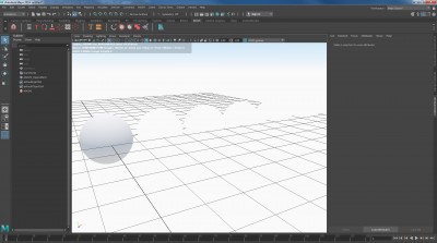

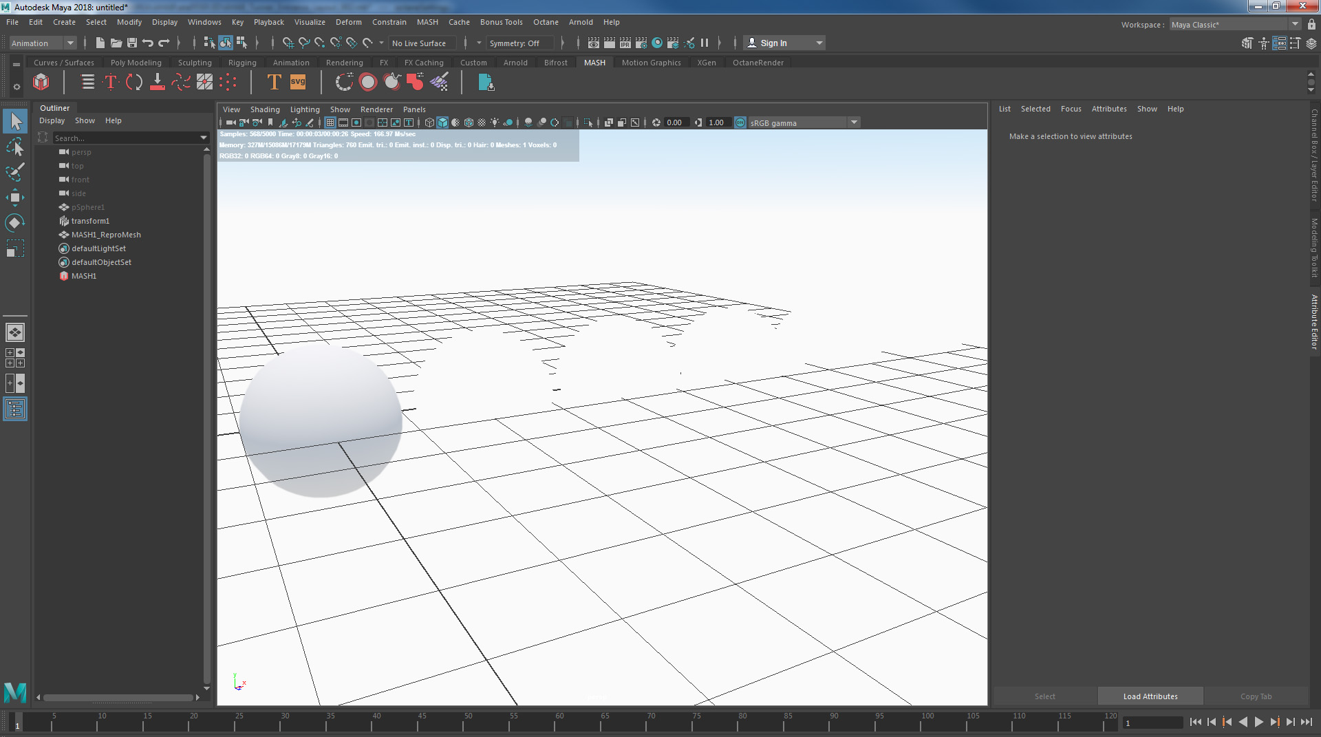

Hi!
Thanks for the good work, the new implementation feels better, even tho is not perfect yet of course.
I noticed an issue on my side, I don't know if it's the case for everyone. But I can't manage to make Octane works with MASH instanced object.
for example, if I take a simple sphere to create a MASH network (geometry or instanced), the instanced sphere will be invisible.
But if you use the viewport Octane render, you will still be able to see a mask of them, like the screenshot.
Any idea how to fix that?
Also, conerning the viewport. How to refresh it? For instant in my screenshot the sphere is supposed to be hidden but we still can see it in the viewport.
It was working on the previous versions.

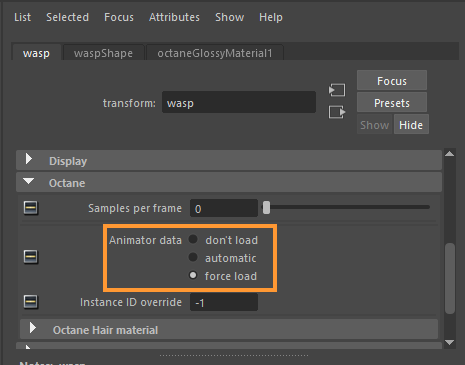

BK
Posts: 1539
Renart wrote:Hi!
Hi Renart,
Thank you so much for your feedback and testing the Beta version!!
Try changing the Animator Data as Force Load of the geometry and Mash instance Transform node in the attribute editor.
If the Geometry vertices are animated then we would need to set this in Shape node.
2018-04-28 12_41_17-Autodesk Maya 2018 - Student Version_ C__Users_bk_Documents_maya_projects_defaul.png
You can set the Frames pre-cache as 0 to refresh in the viewport render but it may slow down when you scrub the timeline as Maya feeds data every frame to our engine.
Please let us know how it goes.
cheers
Kind Regards
bk3d
