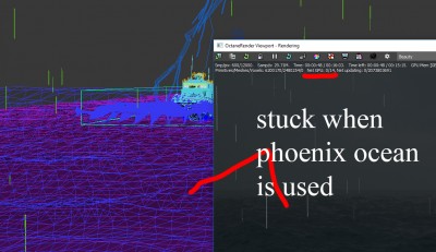

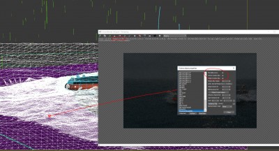

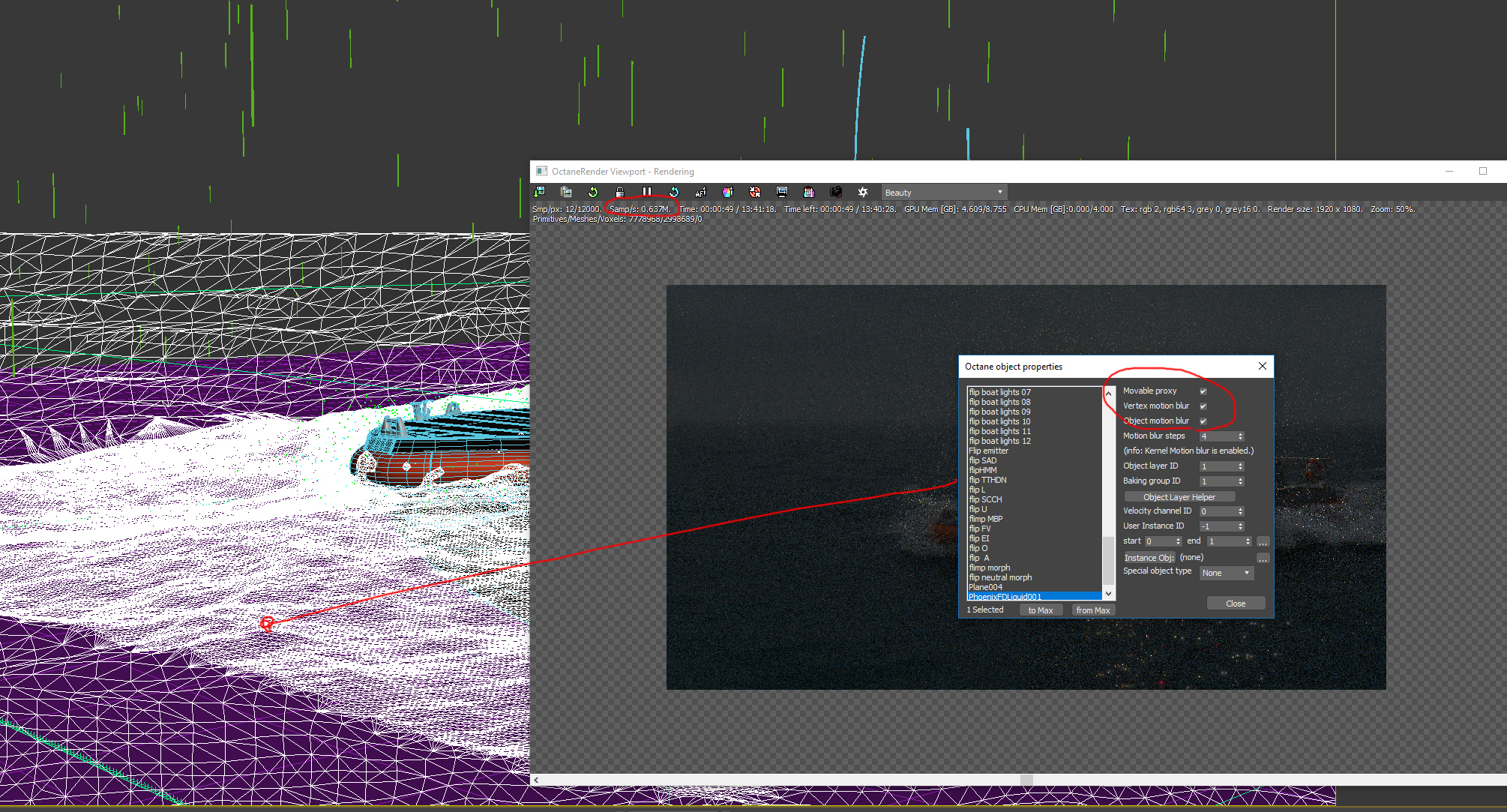

1. could you please send this to otoy. When phoenix fd ocean mesh motion blur is on it becomes impossible to render and octane viewport usually slows down to complete stop and kills off all the slaves.. When it renders with phoenix motion blur ON render times go from 2 min to 15-20 min is this normal? Anyway to speed it up.
2. Also after this if I restart 3ds max slaves work again fine to render anything but the phoenix ocean. master PC must be restarted to render ocean again. I dont under stand why? Can otoy please render phoenix ocean scene I sent in another post with some slaves. This problem is even with MB off. So installing win 10 on slaves didnt do anything . There is a bug with slave net updating and phoenix ocean. maybe displacement maybe something else.
By the way what are those numbers after NET UPDATING? sometimes they are in tens of thousands range sometimes in billions ?

Thanks Paride,
I did some tests Once phoenix ocean messed up my slaves where they stuck at net updating I opened another 3ds max window with just a simple scene. After opening octane viewport window it takes slaves 2-3 to update all 18 net GPUs (where normally it took 5 seconds). Also while net GPUs are updating if I go to speedtest.net a lot of the times I get a socket error or very low download/upload times.
Without restarting the master PC I restarted the router and reopened a simple max scene again and slaves are still very slow to update 2-3 min. So it might be my network cards that are built in into the motherboard. Maybe a heavy phoenix ocean scene crashes them and then net GPUs is slow to update (but when octane viewport is not open internet speeds are fast, data transfer between PCs are fast too. Just octane net update is slow)
Also I attached a video where it shows how slaves render after that crash happened. Even after restarting master did not fix, and it is a simple scene. GPU usages just goes up and down a lot from 70 to 0 where before it would stay around 90s
One more thing. it seems that network slave update is very sensitive to turbosmoothed objects. If i turbosmooth cubes to about 1.7 mil polys net update is very slow even though the scene is only o.8 Gb
By the way what are those numbers after net updating? ****/****
