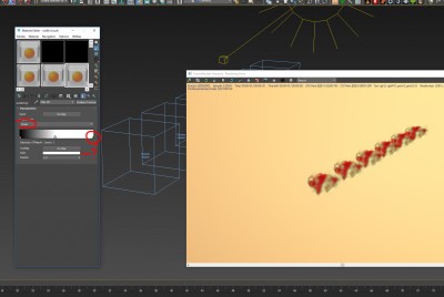

Hi Rik,
thanks for your help. I just checked there are only 2 colors black and white. I attached the scene with VDB cloud. Could you look at it? I just don't know why clouds are still red. Thank you
red scatter.zip
(1.27 MiB) Downloaded 254 times

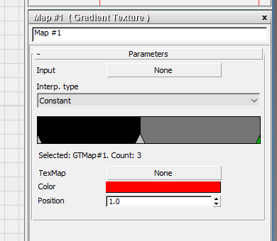

Ah, I think the issue I've had before only happens when the interpolation is set to constant.
When it's set to linear or cubic you can see the red in the gradient, when it's set to constant there's no indication of the last colour in the gradient bar unless you select the last pointe triangle thingy.
None of which helps your situation I'm afraid
:oops: Since your interpolation is set to linear then if your last colour was red it would be visible towards the end of the gradient bar.

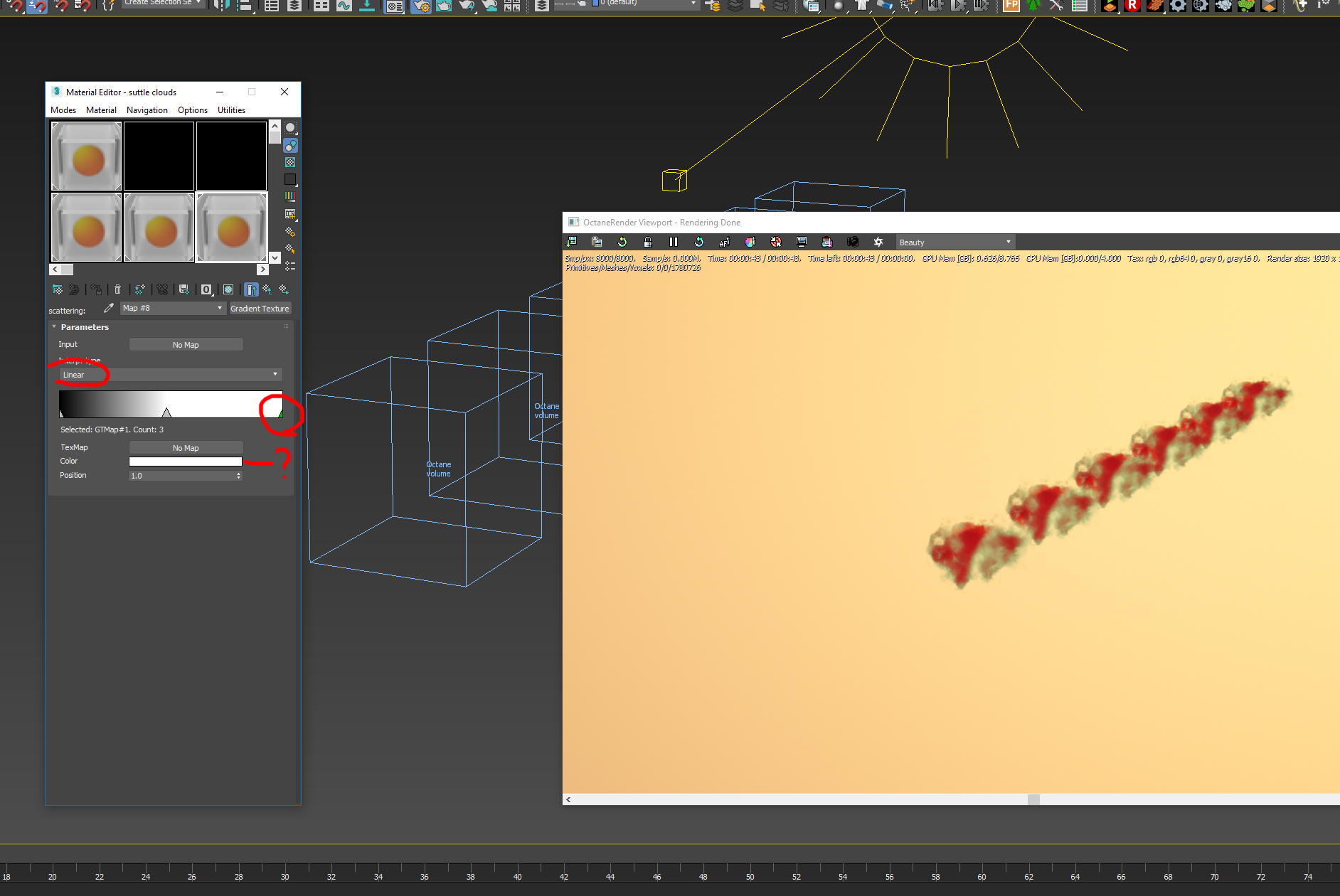

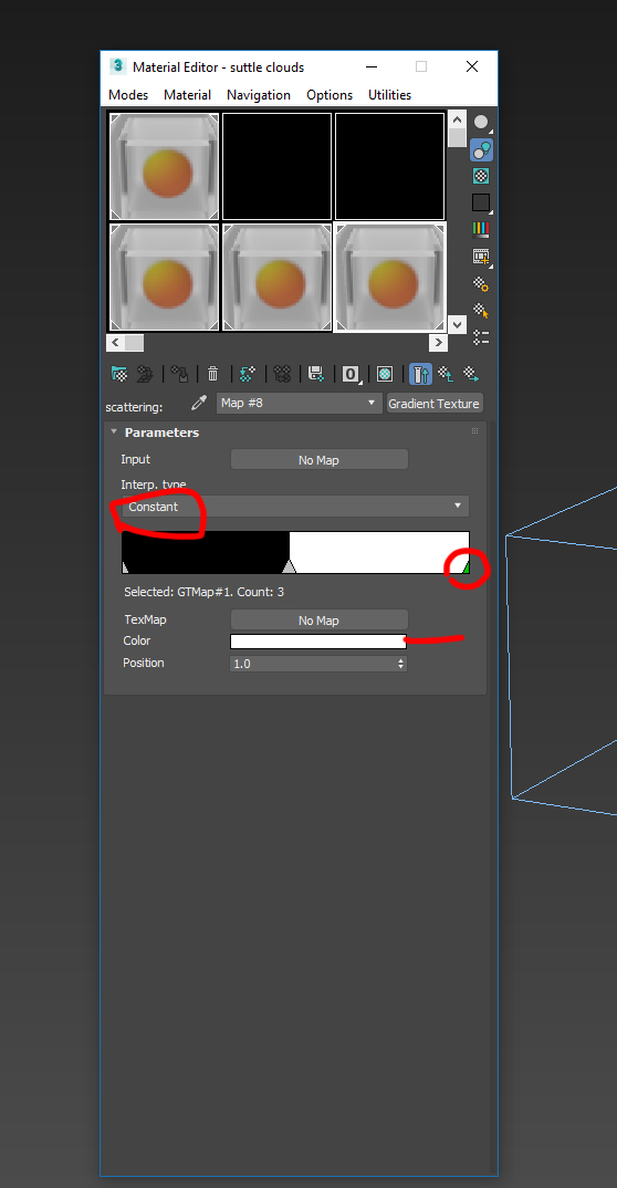

it is strange I chose the third color in the gradient (linear mode) and it shows white for me not red like for you. I guess some strange bug.

Sorry, I'm not helping - the gradient ramp I posted was one I just made to show the lack of correlation between the colour on the gradient and the colour of the arrow when choosing constant interpolation.
Couldn't even open your sample as I'm stuck on release 14 :oops:
From your image though it definately looks like something is wrong as there's no red in your gradient at all.
I'm sure Paride will be on the case soon.

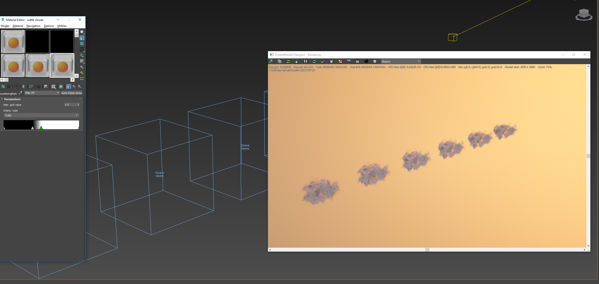

Hi Paride
I tried but all clouds have the same scattering. I guess there is no way to have instant copies of VDB with different scattering and absorption values like random colors of instances ?
We want to use 1 instance but have different scattering values so clouds will look different
Thank you
paride4331
Posts: 4001
Hi coiIbook,
I don't think I'm wrong, it's not possible, rather it creates some different clouds and then instantiates them.
Regards
Paride
