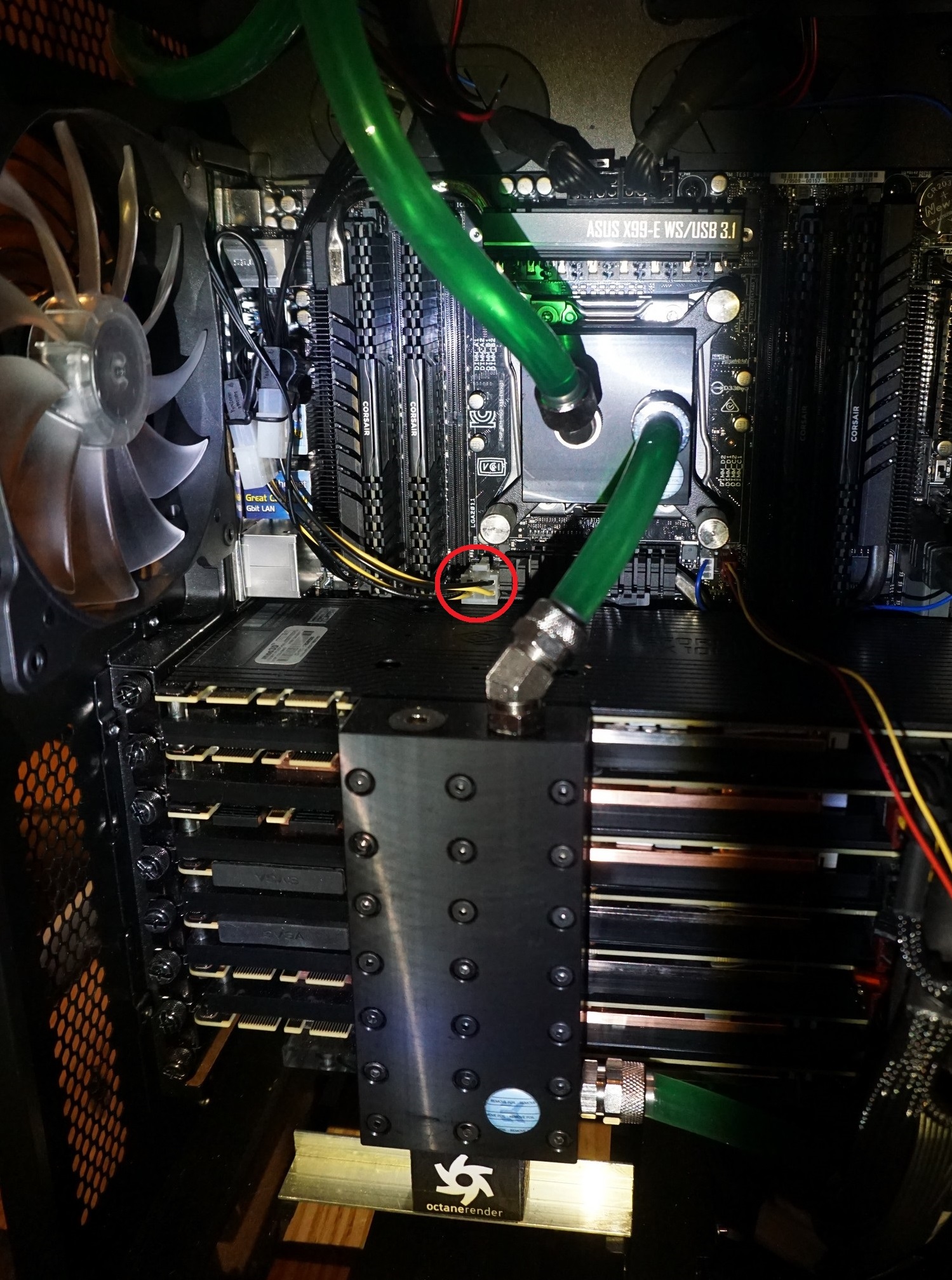

itou31 wrote:Hi,
Did you connect The PCIe Power connector ?
There's something to do with power with these new drivers.
I'm still on BIOS 3502 bios.
I will try to check with windows 10 this WE, but I don't think that it is caused by windows version.
Hello itou thanks for the reply,
Yes, I have all of my 4 gpus connected. Is there one extra on the mb as well or something? I don't see anything. Could you send a pic of what you mean by PCIe power connector?
www.alexdimella.com IG @alexdimella
itou31
Posts: 377
Joined: Tue Jan 22, 2013 8:43 am
The power connector for PCIe is near the first slot (in red circle)
Just test with V4 xb2.1 : no BSOD or crash.
