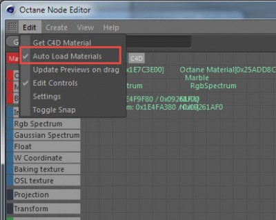

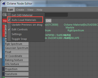

I advice to you to activate "Auto load materials" and connect any node to material.
Without connecting nodes they will not work and they will be non-owned and disappear when you close the NE.
You have to know that Node Editor works as Material Manager not Xpresso editor. Because creating node just creates a virtual node not real one. Connecting that to a material will leads to be owned and create REAL copy of shader.

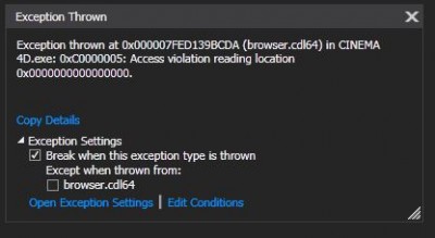

Hello,
It crashes on loading screen.
- Correct version of plugin is used.
- nVidia Drivers are up to date.
- Just removed "3.08-Test 6" and copied new 3.08-RC2 plugin to C4D plugins directory (not updated standalone version)
